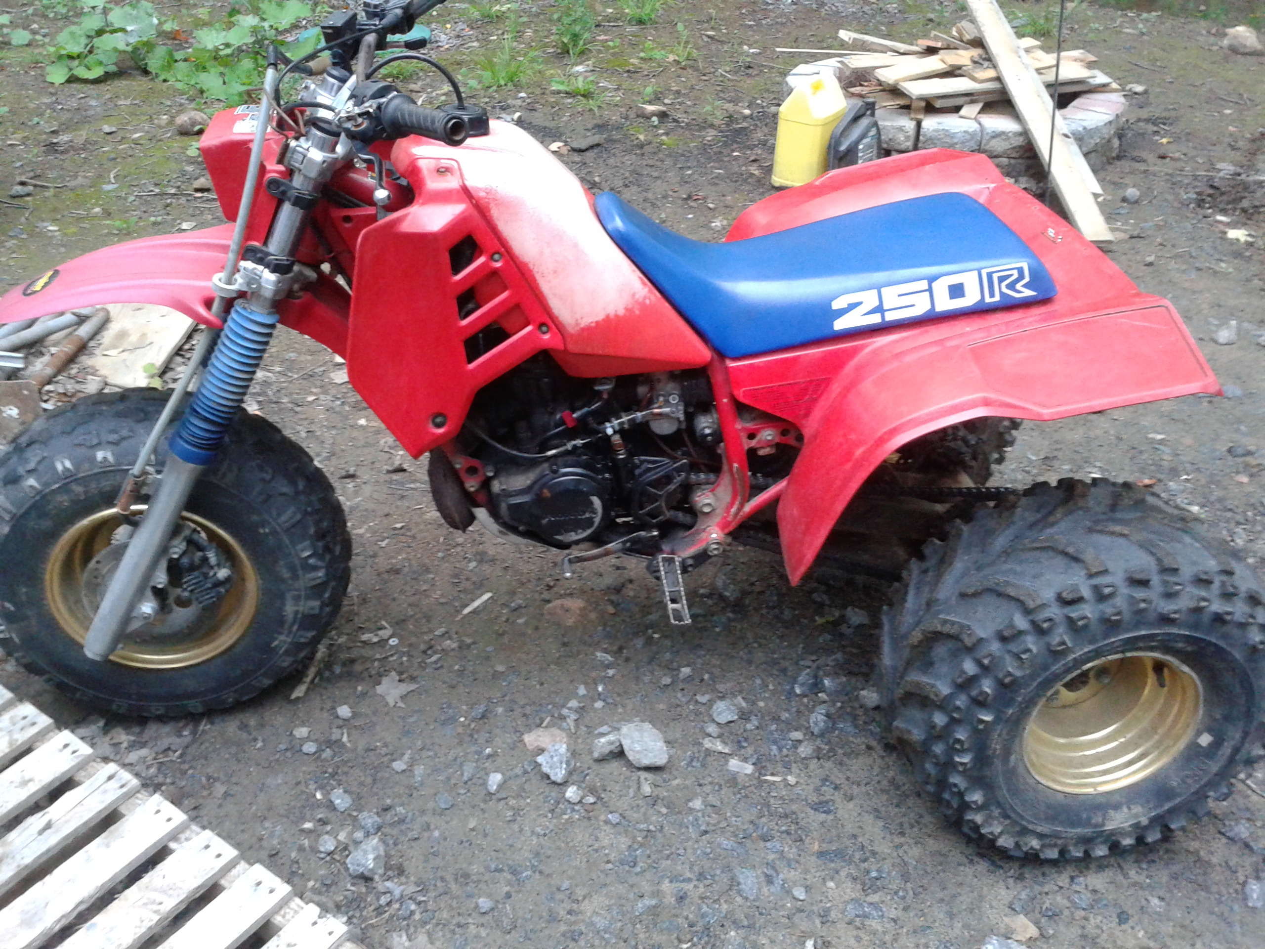

    Now comes the interesting part. Having two TRX 250R, I always loved the 85-86 ATC250R but never wanted to pay 4000$ for a 30 years old beated trike. So one day I open my computer and search about anything from Motorcycle to ATV and find this cheap 1985 ATC250R near my house. A little fast forward and it is now mine.
    This trike in bone stock. The last owner had it for the last 22 years and he never rebuild the engine or any major part. It was dusty as hell but I thought it wound't cost an arm and a leg to make a good trail ATC that I could bring, occasionly, to some motocross tracks that accept quads.
    So here it is when it arrived home

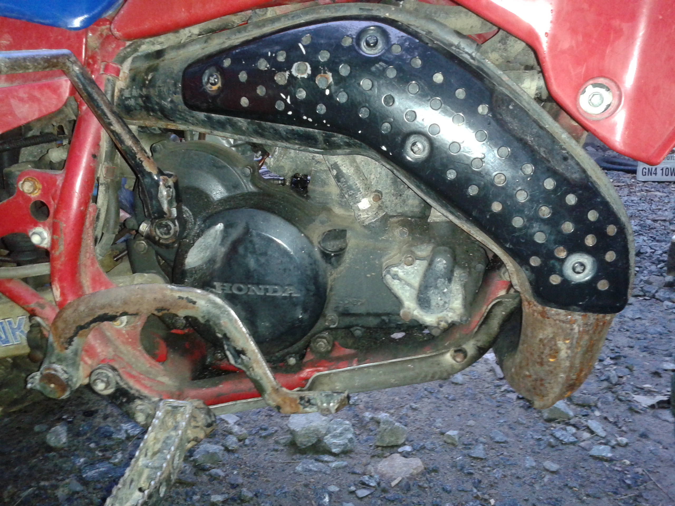

    The engine was very oily but after a couple of ride there is no leak other then the exhaust!

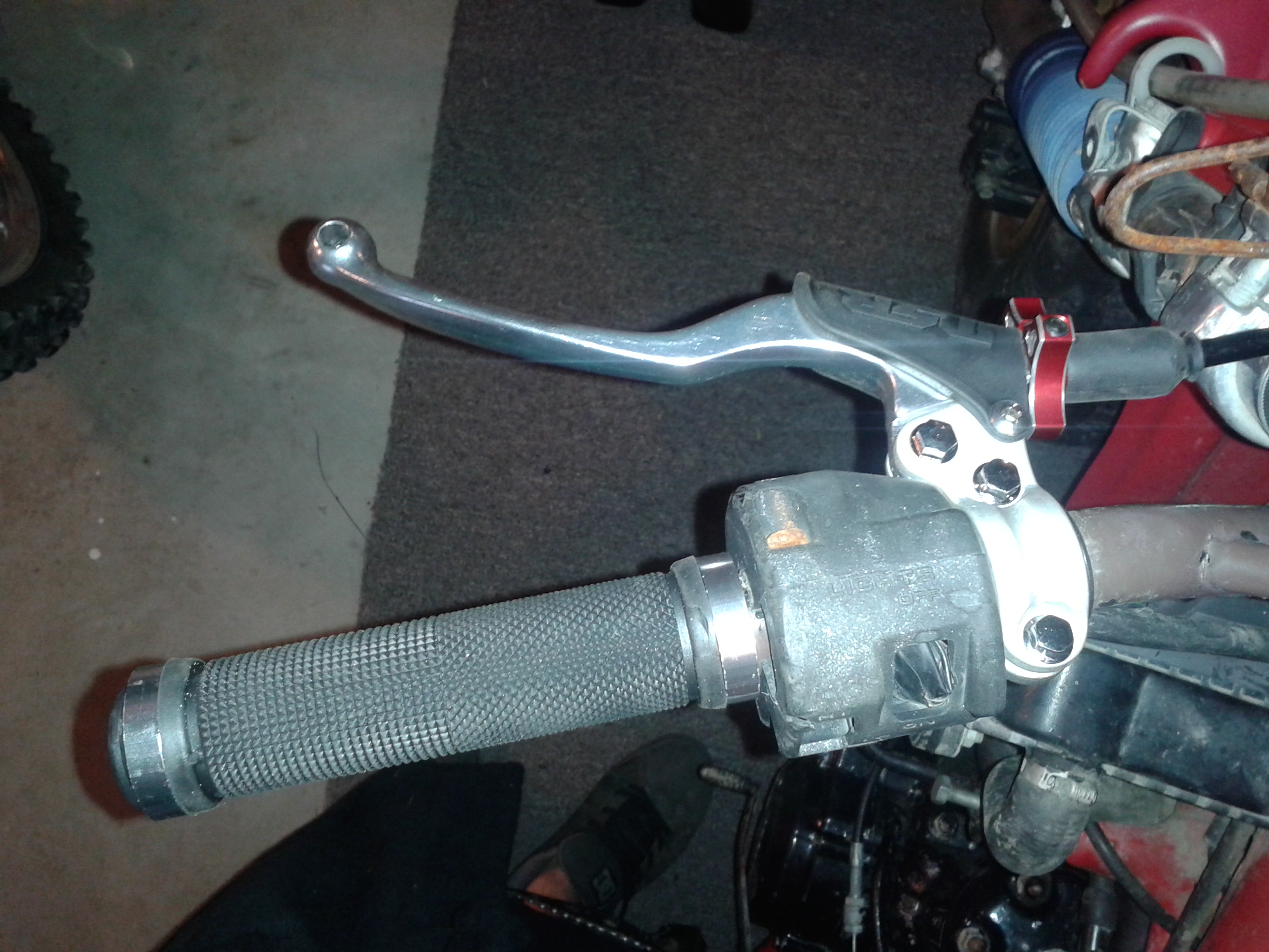

    The original clutch lever was very loose and the parking brake was shot.
    I installed a forged MSR unit. There is a small bearing in the forged clutch lever so the action is very smooth and the lever feel tight.
    There is also a "on the fly" cable ajuster on the MSR perch. The grip are bicycle lock-on grip brought on eBay for like 3$. I may come back to regular ATV grip since these lock on grip are a good 10mm larger witch let no more free space between the thumb throttle and front master cylinder.

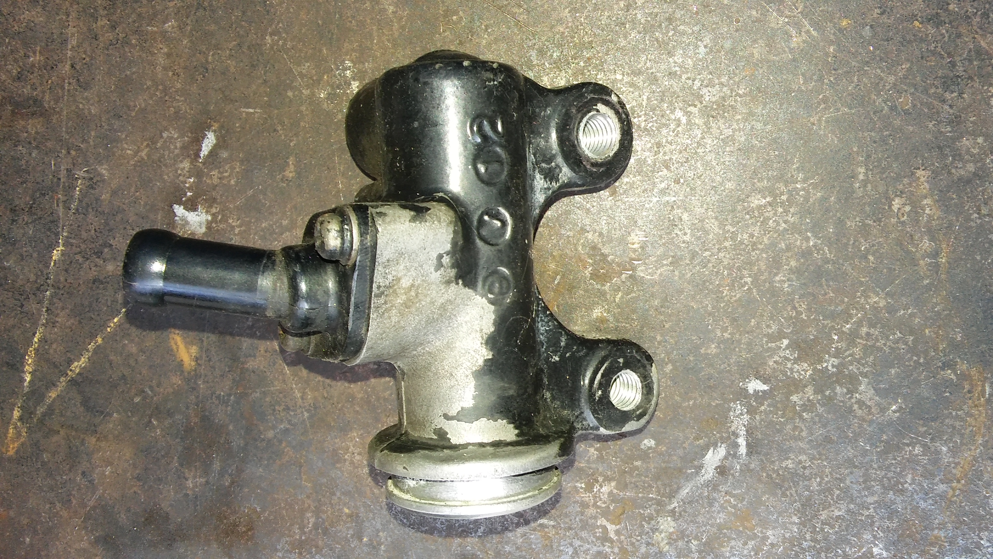

    The gas valve wasn't completely closing so fuel was leaking when the gas tank was removed. The Honda parts fiche only show the petcock has an assembly #16950-HA2-015 and cost 70$
    I had the same problem with my 86 TRX250R but the petcock could be brought in seperate parts on the four-wheeler. I searched here on 3wheelerworld but couldn't find any information about it so I took a chance and ordered TRX parts to rebuild my gas valve witch worked perfectly. Maybe this will help other 86-86 ATC250R owner
    The petcock fully disasembled

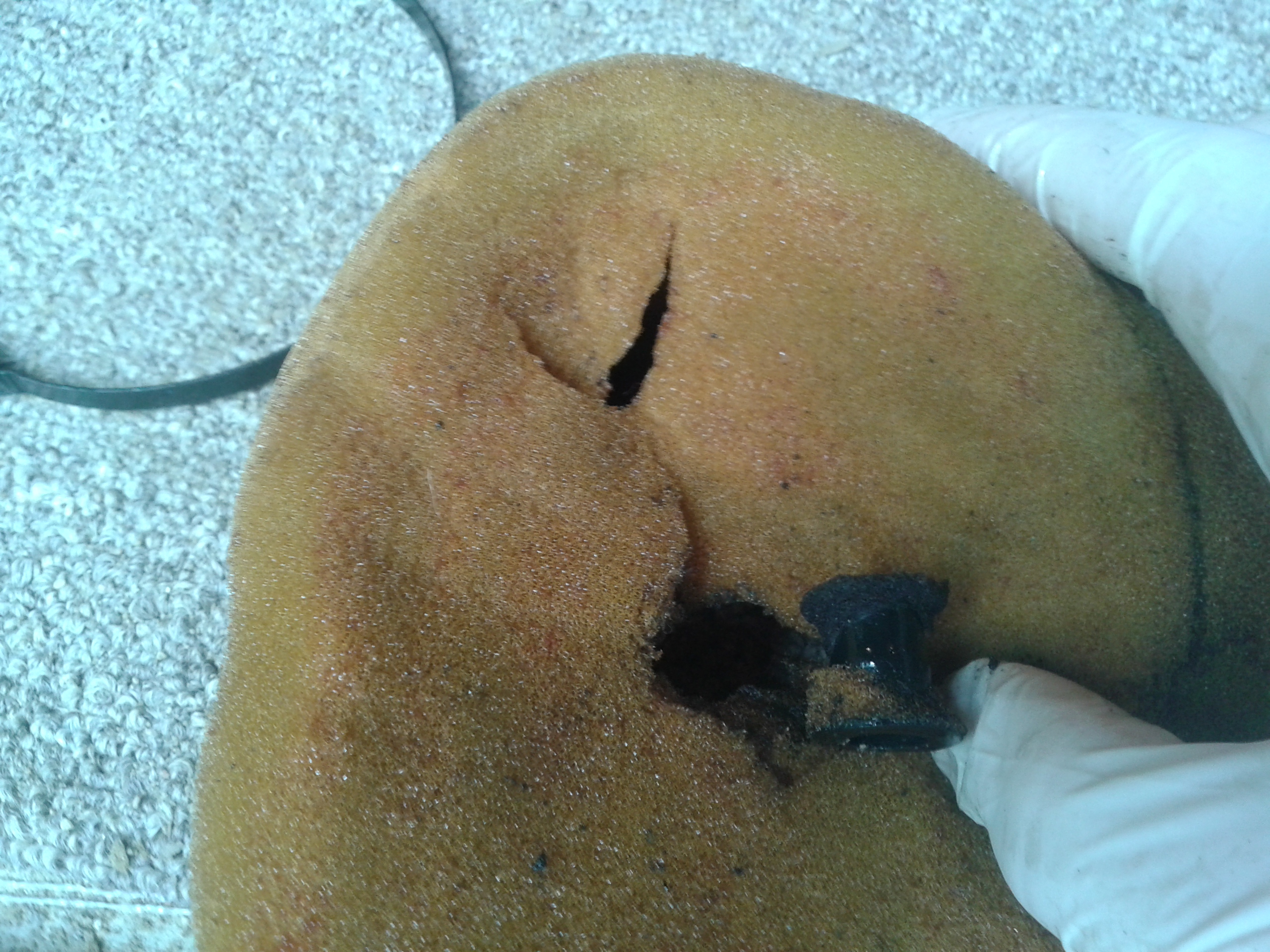

    Then come the original air filter. Glad I saw this before I used the trike in the dust!
    It's like if it was in a decomposition state?!

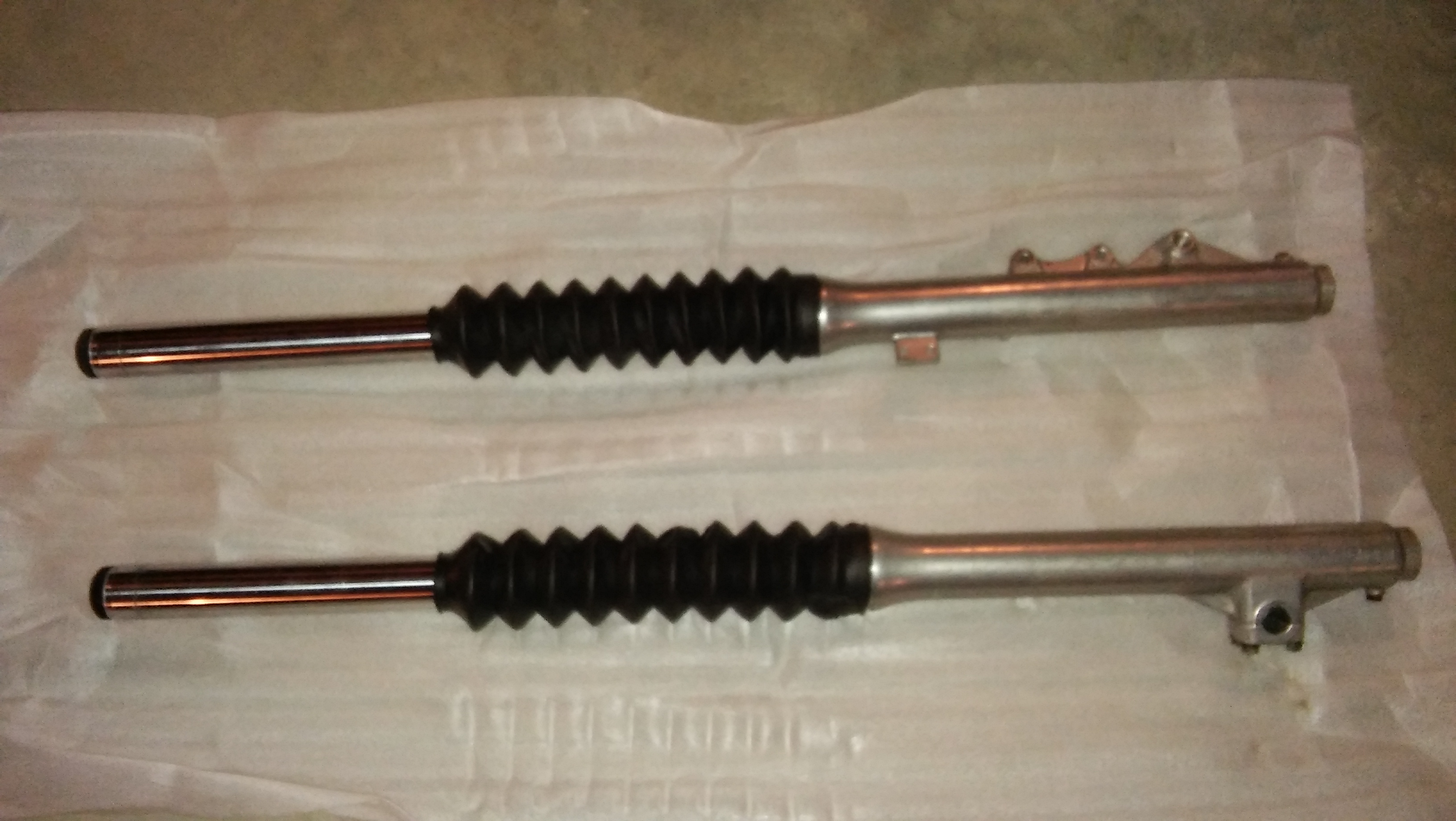

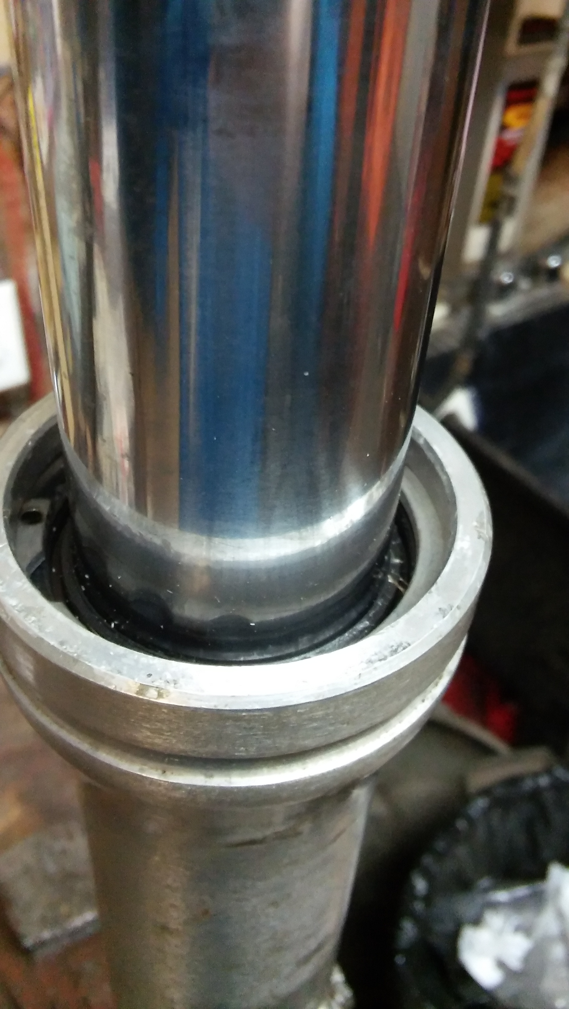

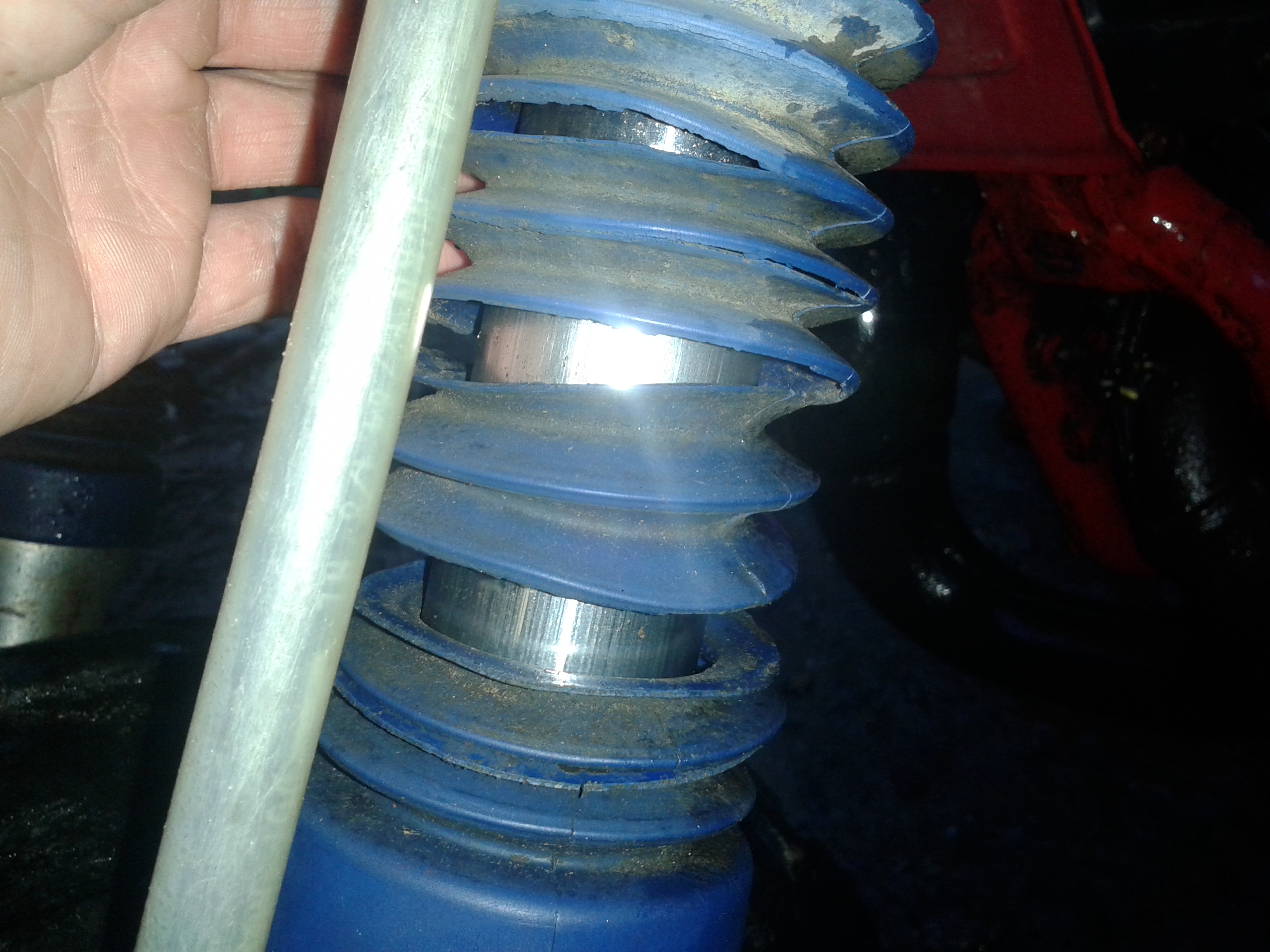

    I cutted the forks boots the find what I was expecting: the two oil seals are leaking badly. If it would have been only that, I would have been happy. What I found without the boots is both forks are bent

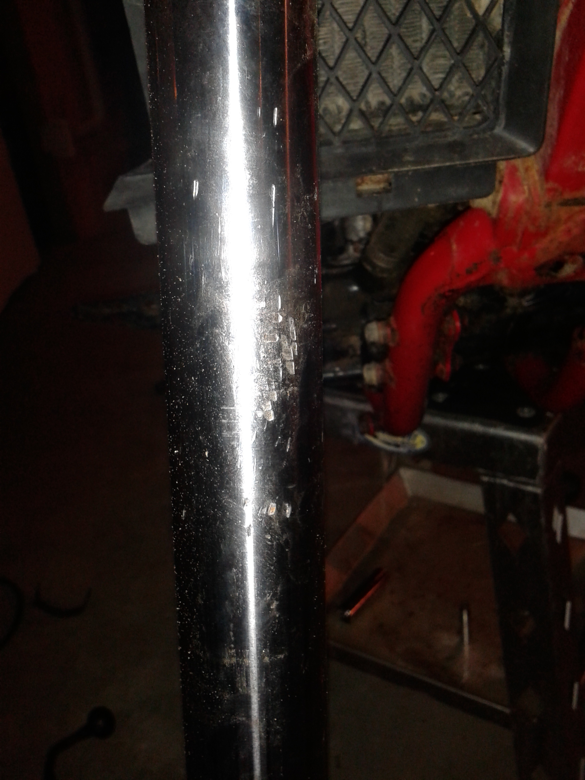

    Therefore more, the right side fork have some major dent on the chrome! It looks like a f*cking idiot used a pipe wrench on the tube so my forks are basicaly destroyed.

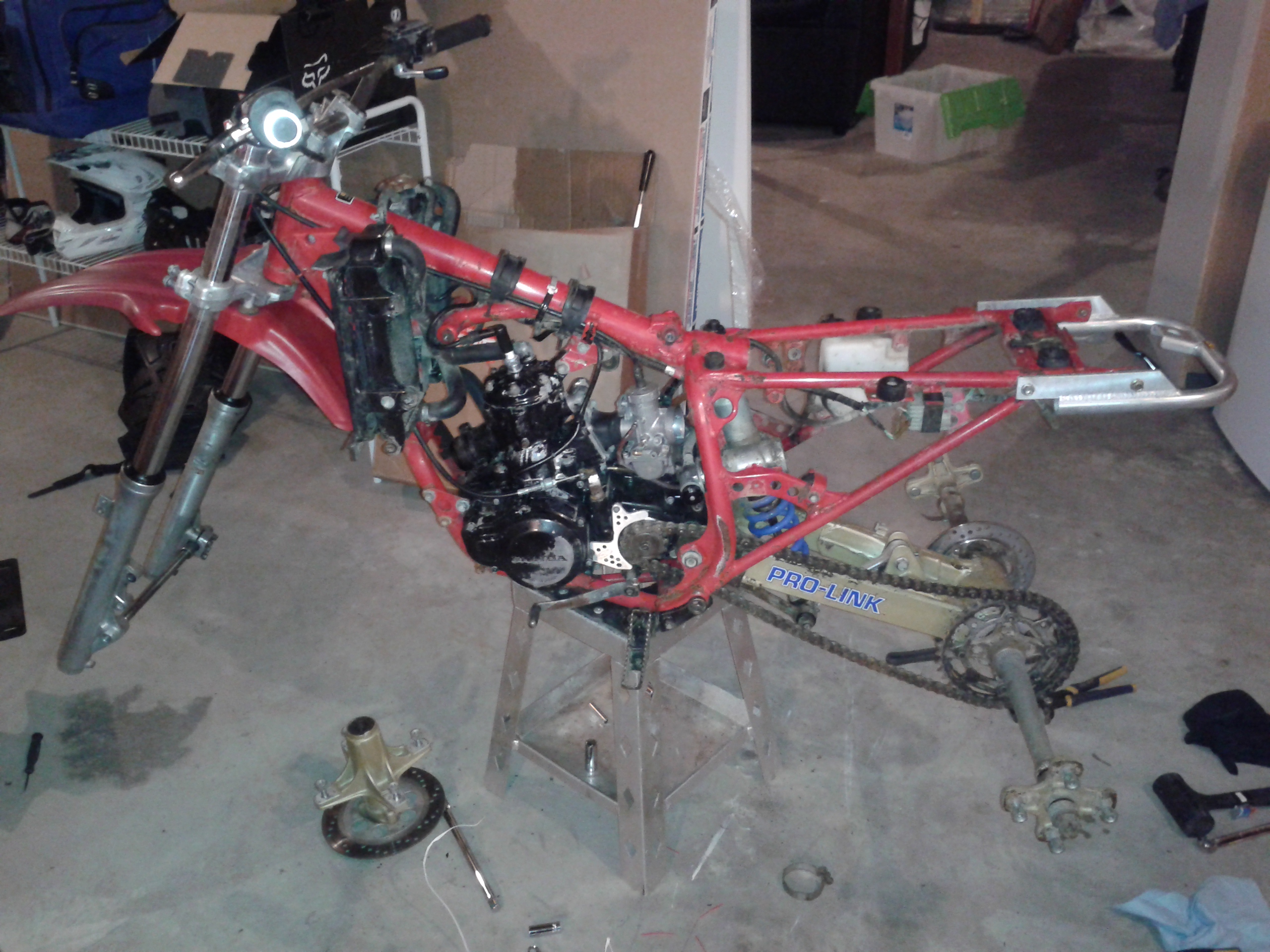

    This got me thinking it was time for the complete rebuild to start in order to find any problem and have a reliable, fun to ride 250R.
    Starting the disasembly

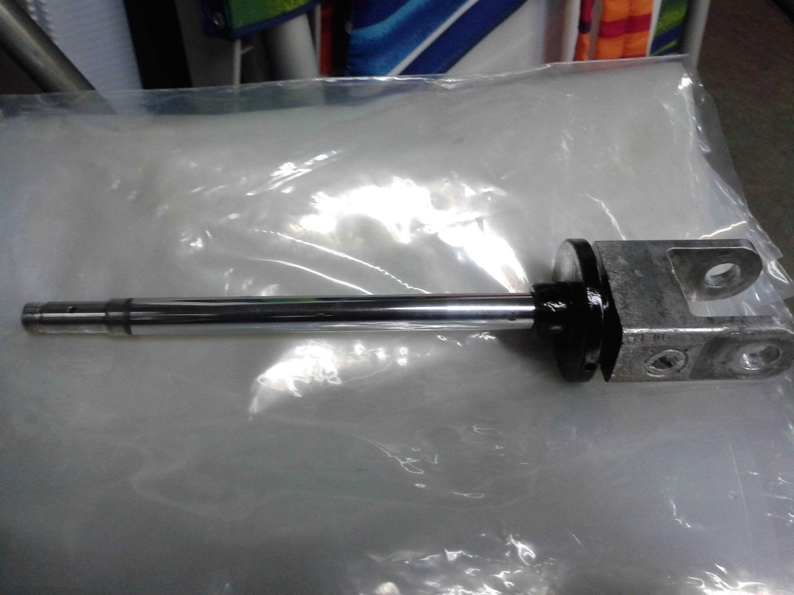

    Here's some of the parts I repared as of right now:

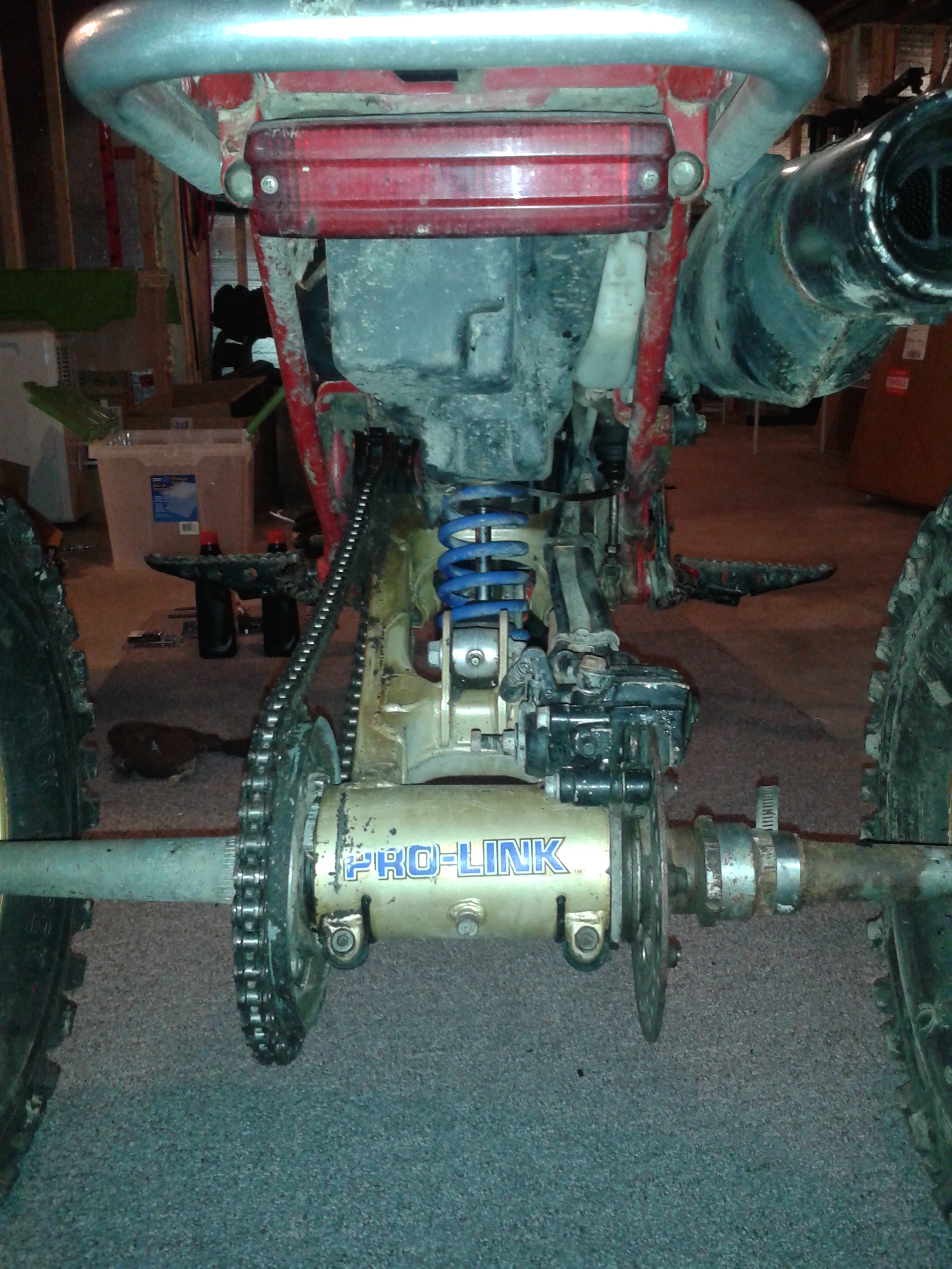

    My rear shock was leaking oil and the rear suspension realy didn't seems to work fine.

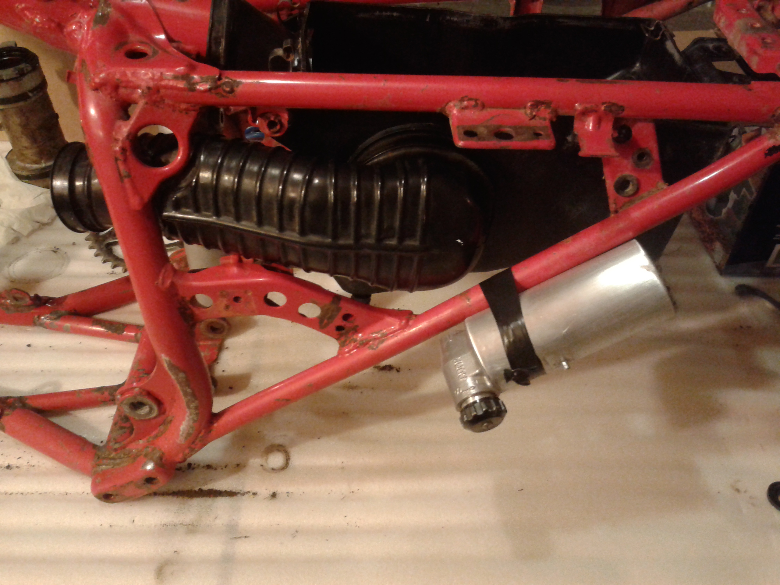

    In this process, I also wanted to move the shock reservoir on the back of the frame, like the TRX250R. I know it will not improve the suspension but I simply like the looks of it and also, the reservoir will catch less chain oil.

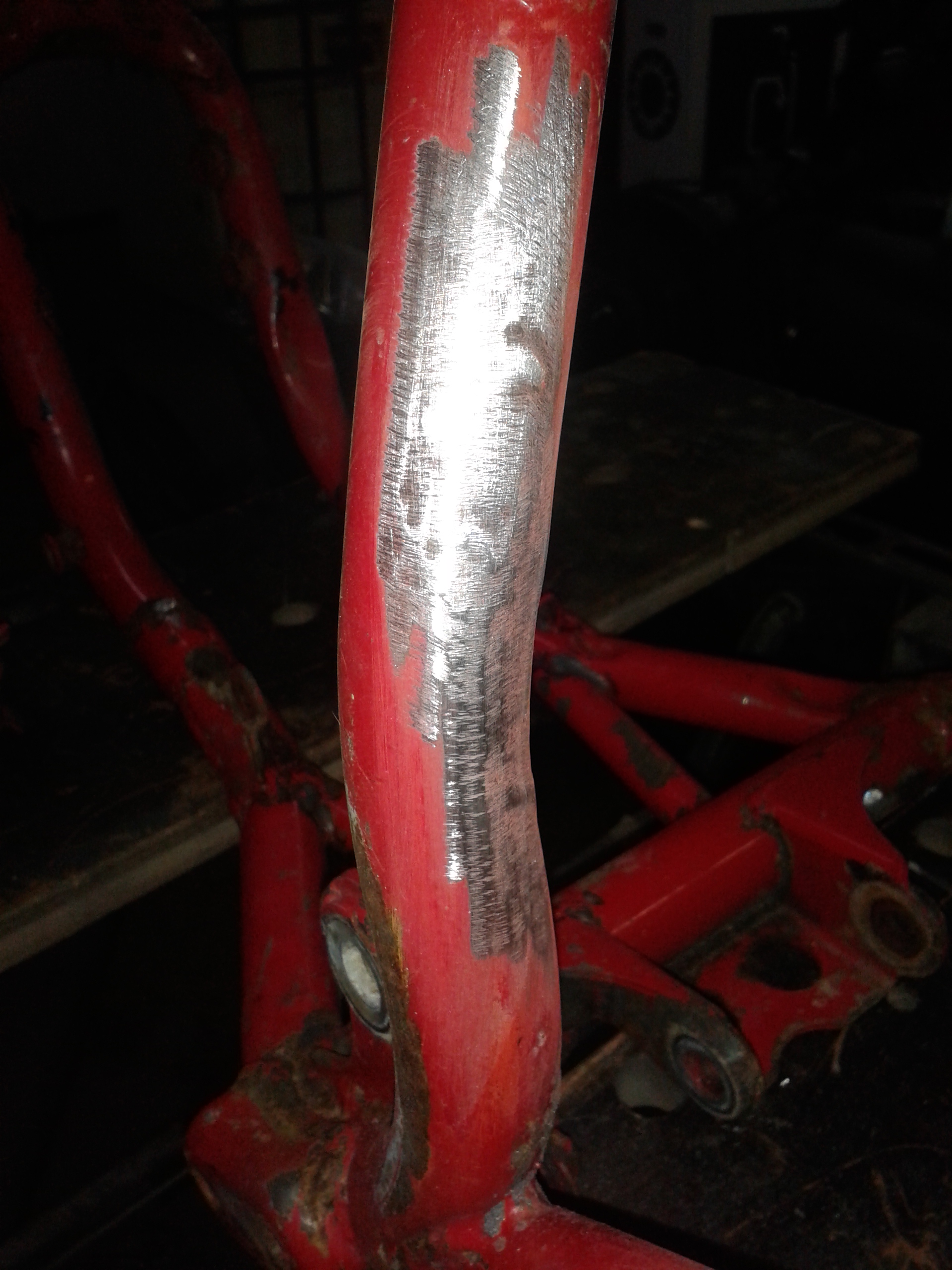

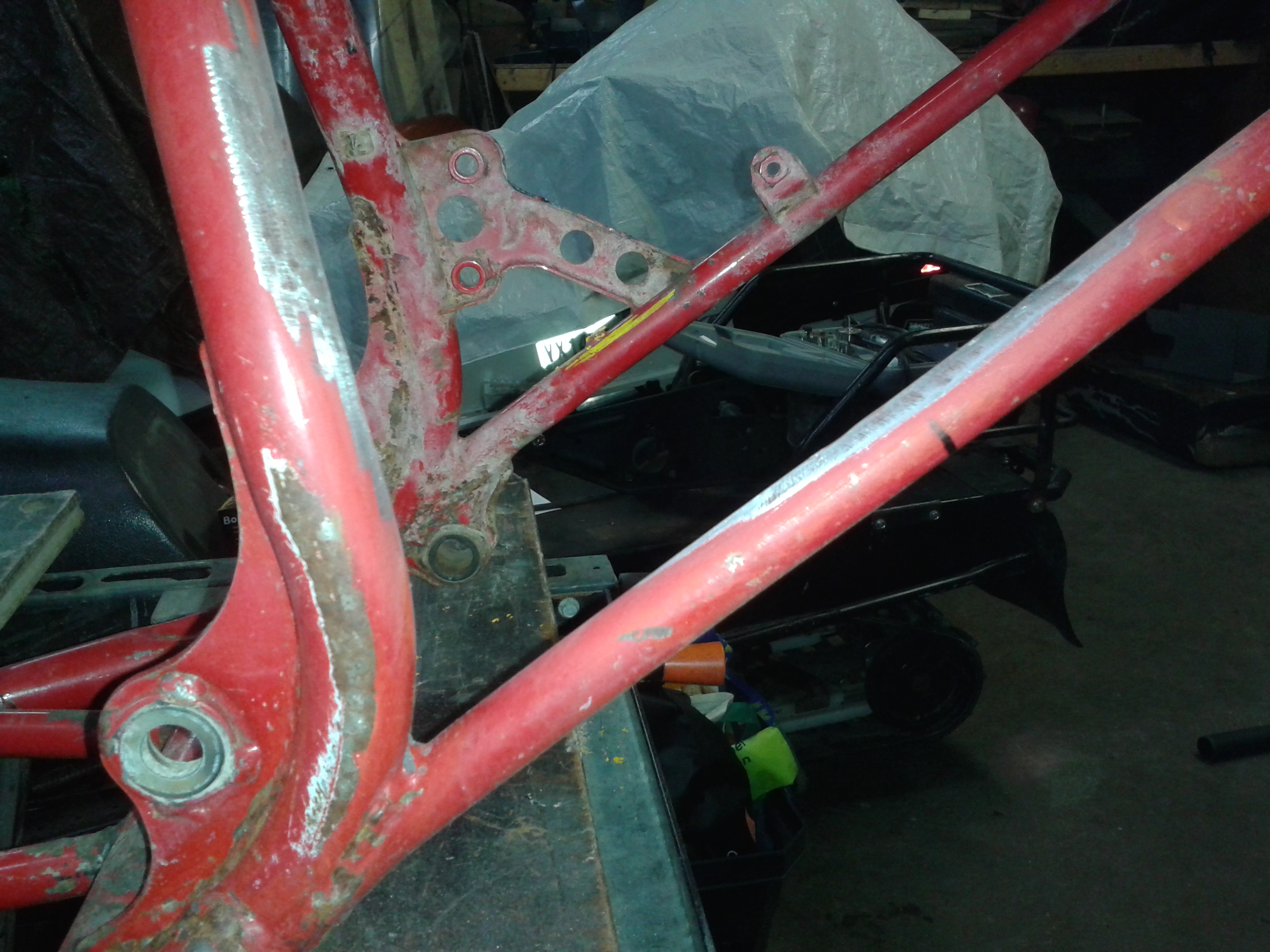

    I removed the big frame brace and buffed the frame.

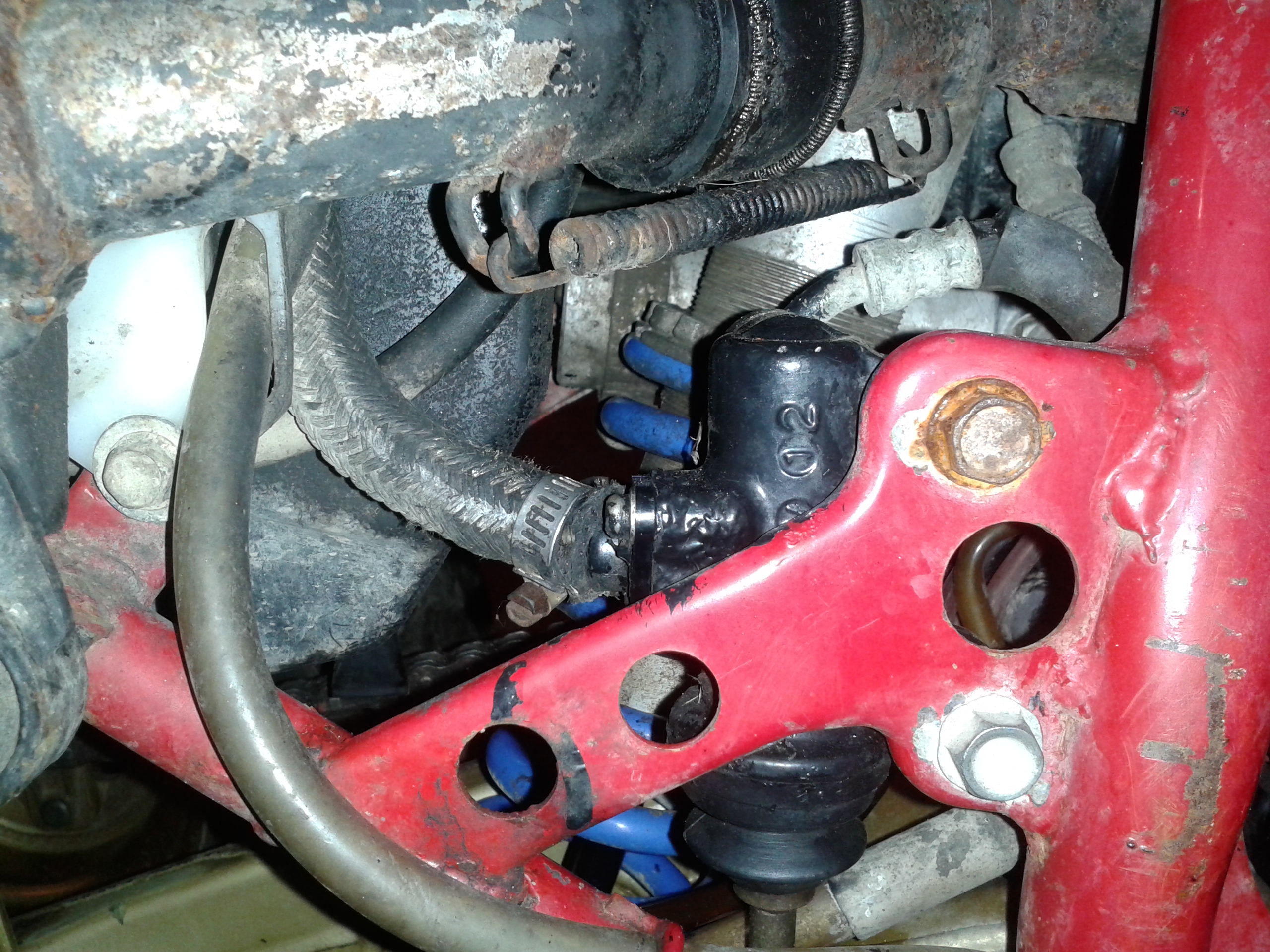

    To replace the short reservoir line I ordered Russel brake line parts

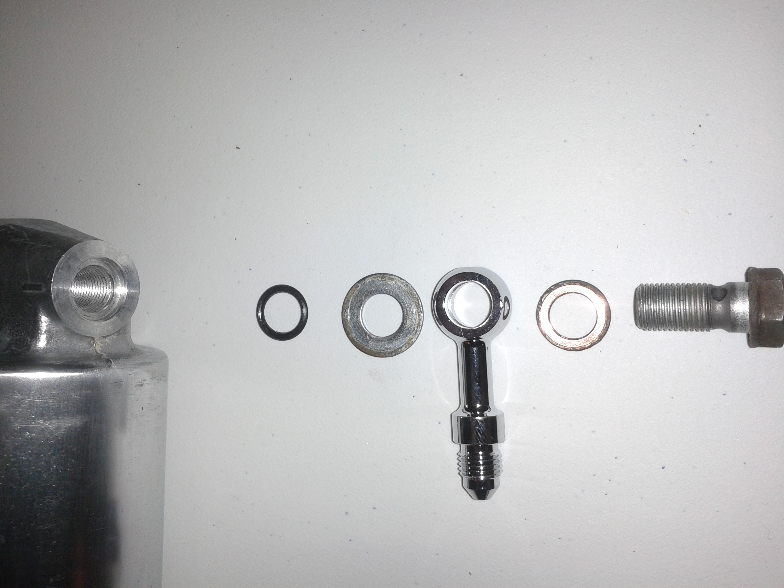

    The reservoir bolt is a little special and seal with a o-ring so the stock bolt was used on this side.
    On the shock body, the hose fitting is build-in the hose. I ordered a banjo bolt from Russel that has the same tread.
    I was worried about the oil flow in the hose but the diameter of the hose and the banjo bolts are the same so it should affect anything.

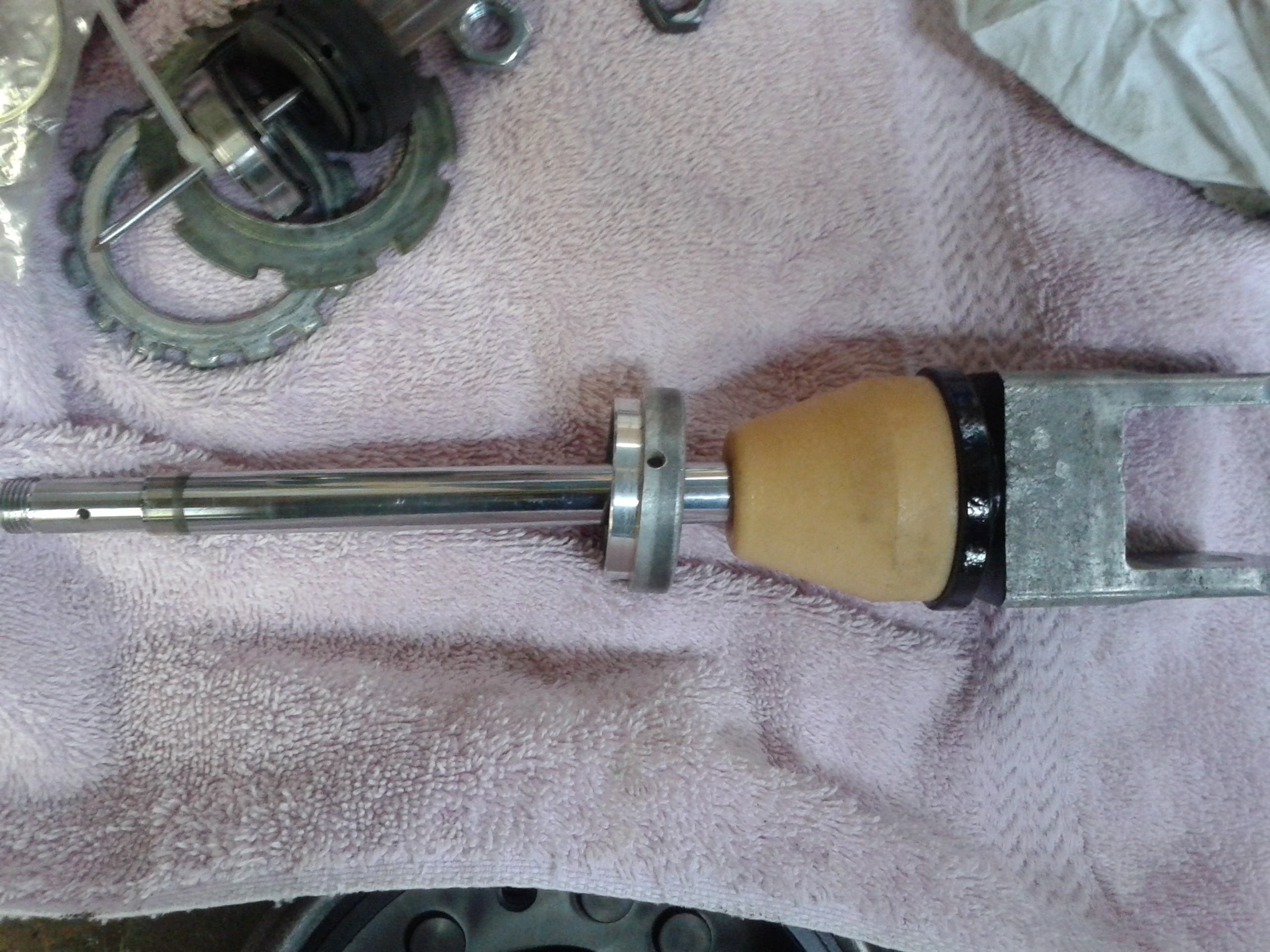

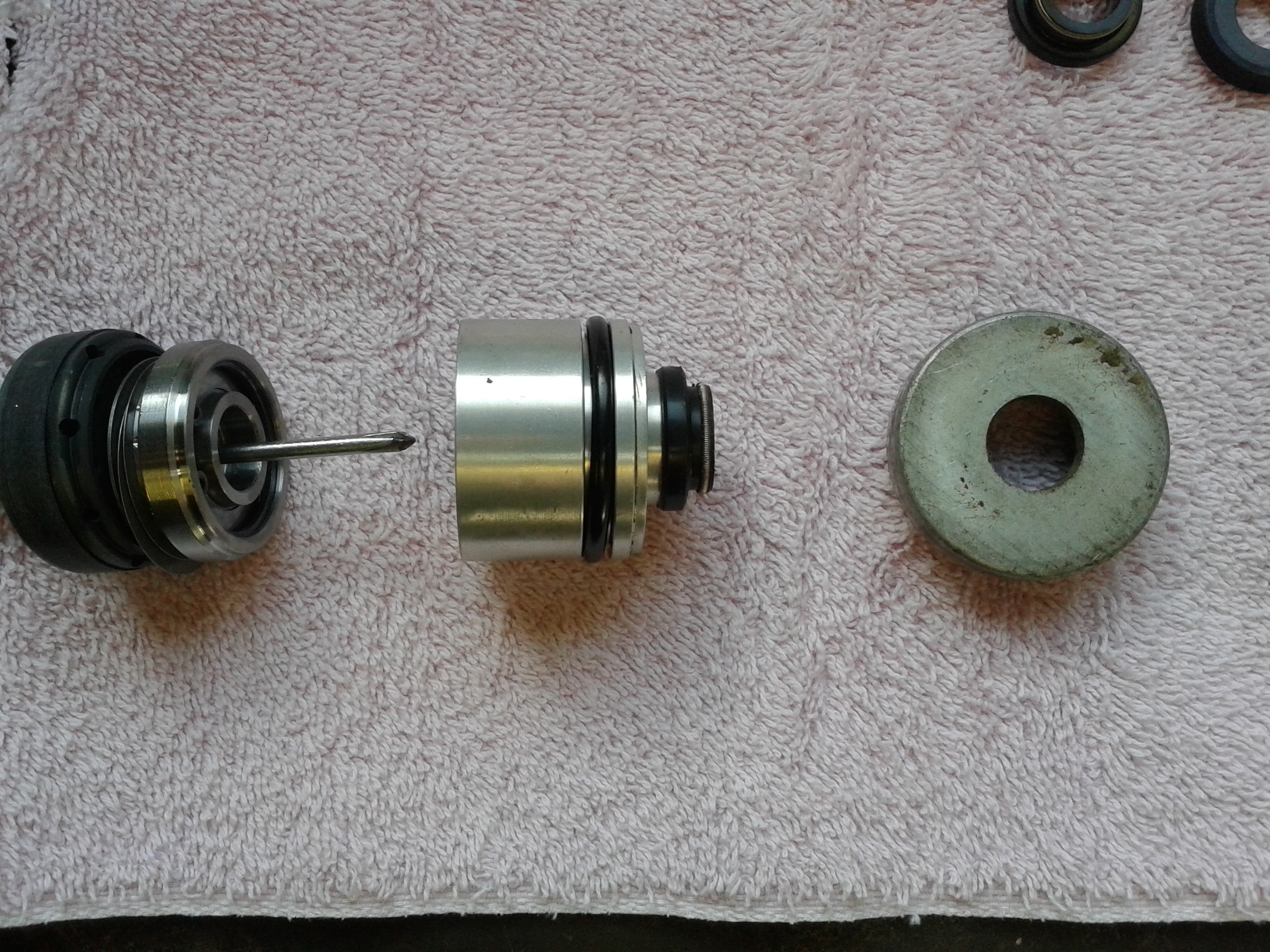

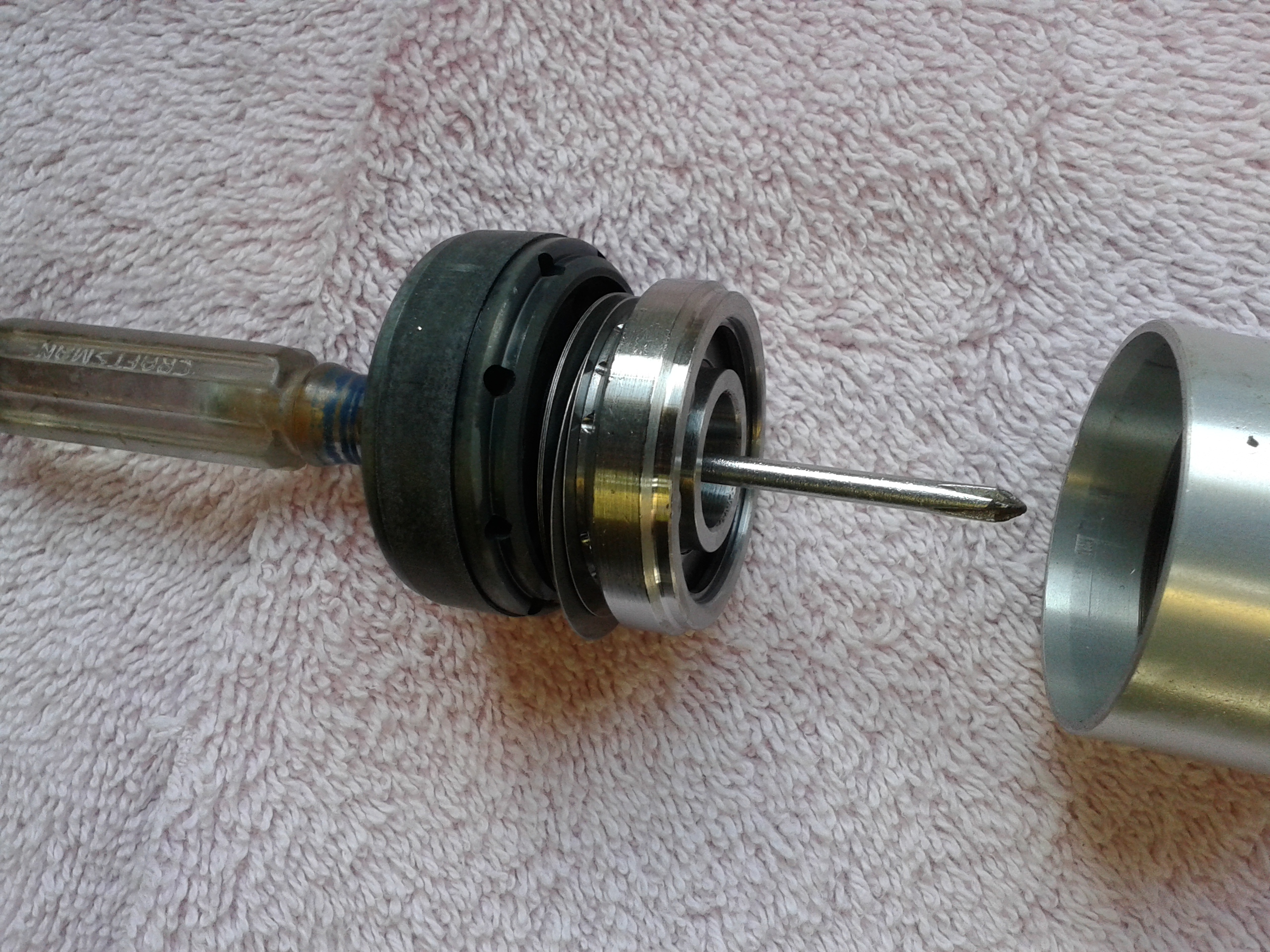

    I and problem finding a kit to rebuild every shock seals but found everything I needed at Schmidty Racing Suspension. They have a nice kit with all the seals, clip and nut. I also ordered two rubber reservoir mount and a bottom out bumper since mine was breaking down.
    Some pictures of the rebuild. I will add more when the spring and retainer come back from the gloss black powder coat

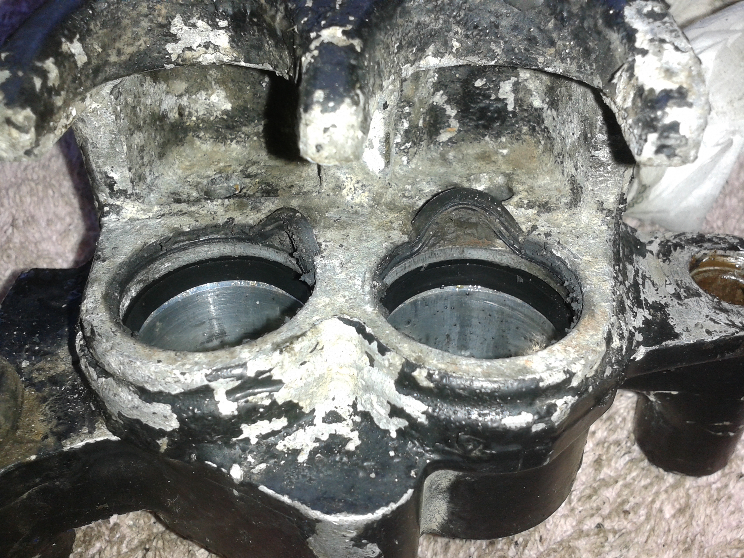

    The front and rear brake were constantly applying a little pressure. On slipery terrain, like mud, the front end would drag or lock reasulting in a very dangerous ride!
    The rear caliper.

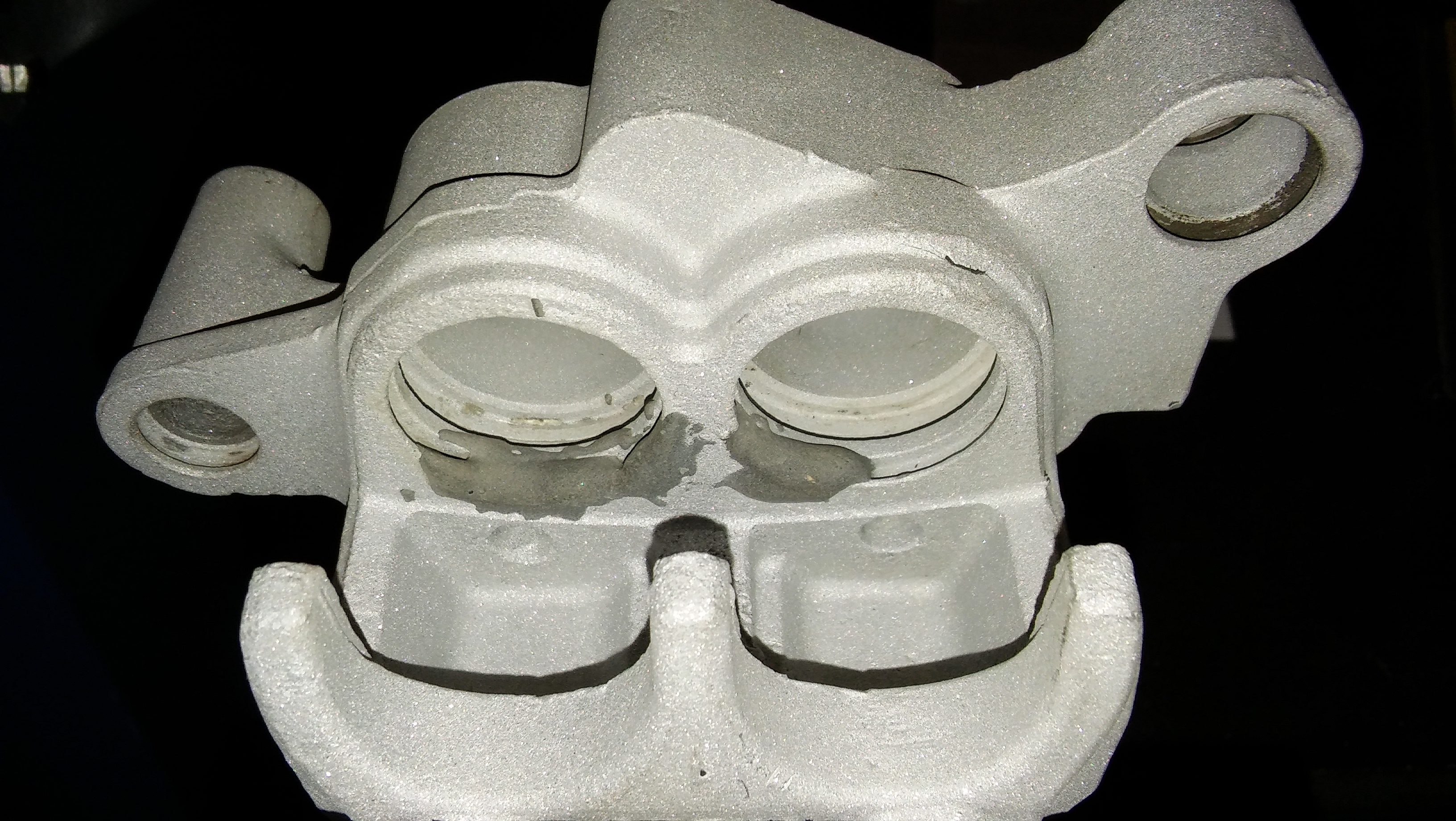

    The caliper body was corroded and the seals were coming off. No wonder why the brakes weren't working right
    My brother sand blasted the caliper at is job. Then I used JB Weld to fill the missing material on the caliper.
    Then I used a Dremel to remove the excess stuff and to rebuild the dust seals grooves.

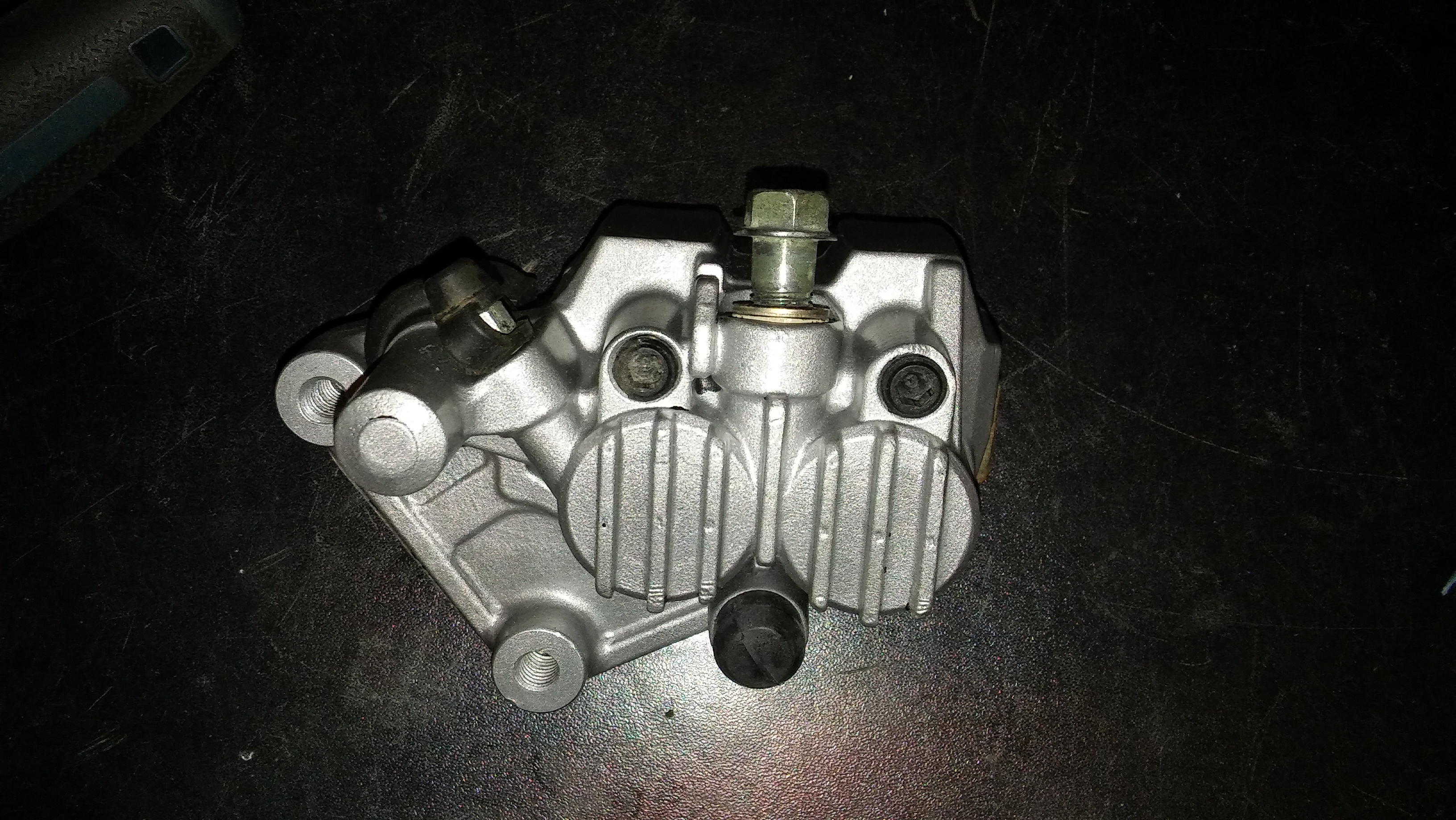

    Completely glass blasted. It is hard to see it looked like the caliper was polished!
    So I decided to clear it and it kind of ruined the shiny finish I should have painted the caliper like I did with the rear one. For the moment, it will stay like that and maybe I will paint it later.

    For the rear master cylinder, I realy wanted to replace it by a modern motocross bike unit with an integrated reservoir. I tried my 2008 YZ250F NISSIN rear master cylinder and like you can see, it is far from perfect.
    I then checked master's from CRF, TRX450R, KFX450, YFZ450, etc, etc. and I don't thing any of those would be an easy/logical fit. So I decided to rebuild my original one.
    Disassembled.
    Glass blasted
    Rebuild kit from eBay. Made by K&L and actualy made in Japan
    Rebuilded
    Always hated cross head bolts so I replaced then with hexagone bolts

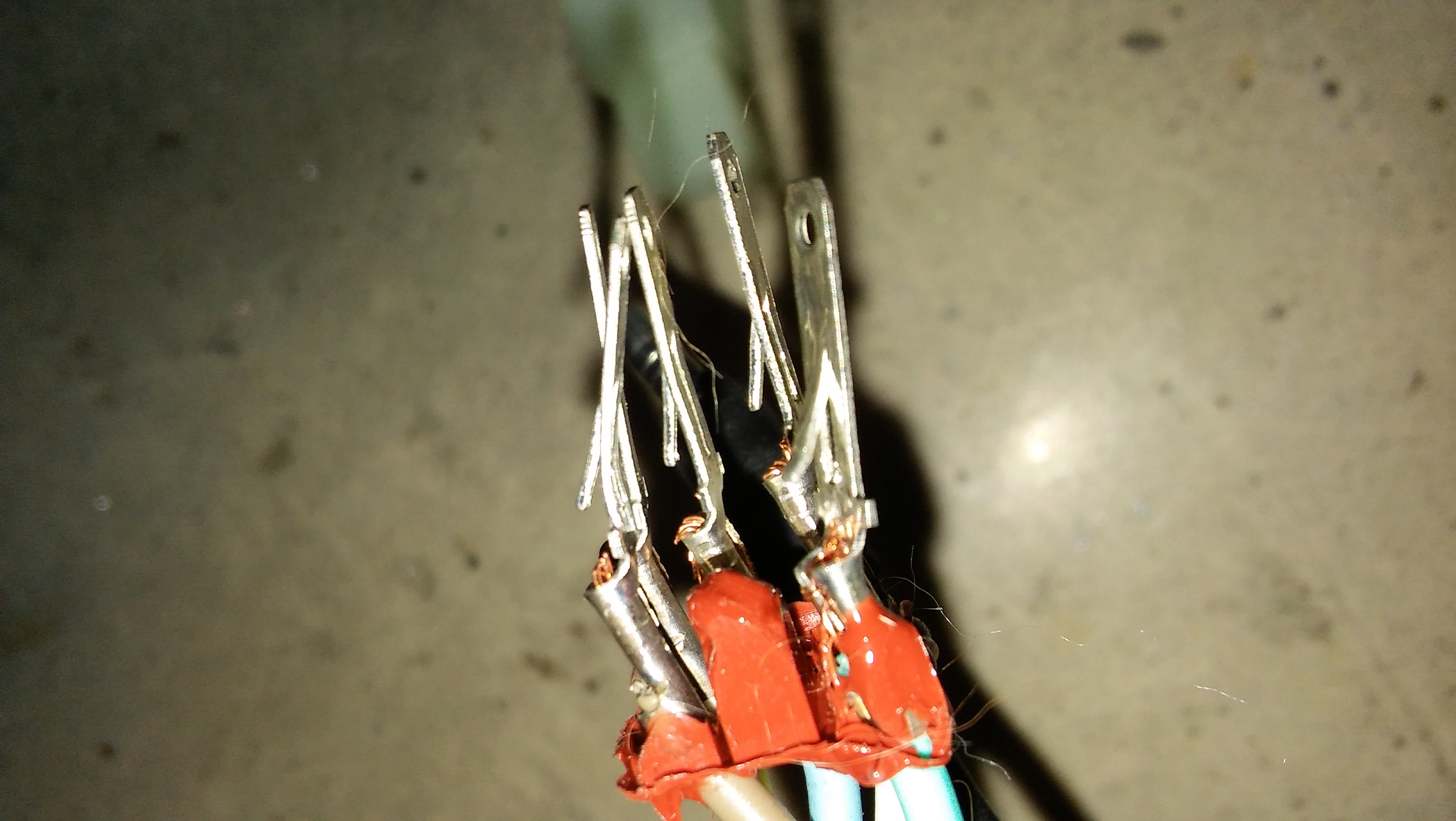

    I brought one of those reproduction switch and I think they are not so wonderfull
    The look and fonction of the switchs seem really good to me.
    The problem I had with my kill switch is the wires poped out the first time I connected the two connnectors together!
    I tried to glue the wires in the connector without success
    I also tried to open the kind of hook on the wires male connector and they still popped out. So I pushed the wires one at the time in the two connectors and hope it will be fine when taped together. If not, I may cut the original connector from my switch and weld it on my eBay switch.

    For the forks, since my original were bented and dented, I ordered used ones on eBay
    Didn't need to be Einstein to know a rebuild would be necessary.
    I unassembled the 2 forks kit I had, cleaned all the parts and took the best of each forks to build one good kit
    I installed new OEM Honda oil seals and dust seals
    I read good reviews about the Progressive Suspension spring so I installed a pair of their springs
    Poured 10W fork oil and installed black Daystar 83 series fork boots

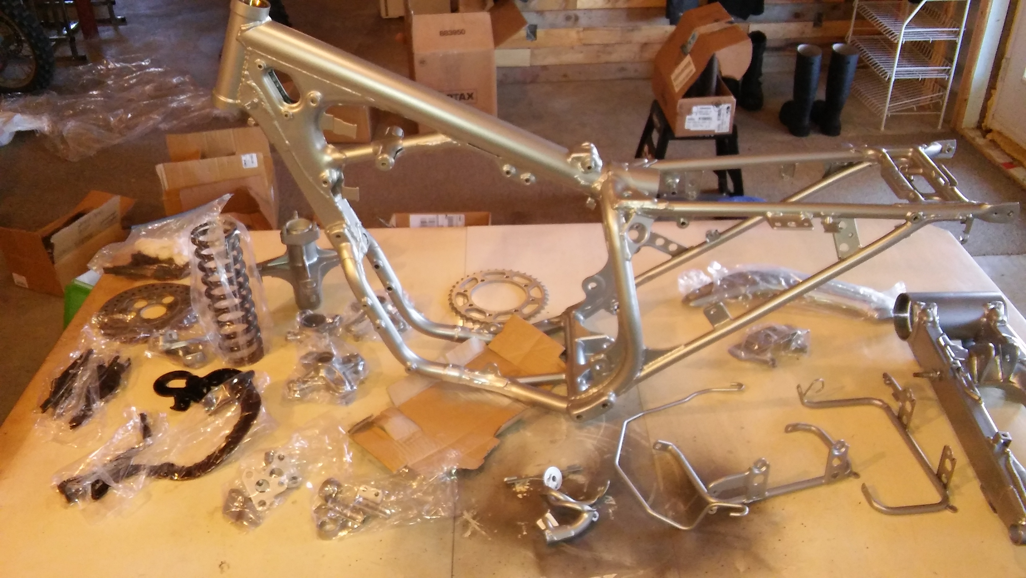

    Waiting for the frame from the powder coater
    1985 ATC250R - under complete rebuild for MX/trail: tread here
    2014 ½ KTM SXF450 Factory Edition
    2008 TTR125LE - Girlfriend bike and my pitbike
    Aug 2015
    Quebec, Canada
    20
    Finally received my parts from the powder coater!
    First, I started with the electronics and then the rear suspension.

    Then I mounted the swing arm, linkage and rear shock. I must say that I realy like the looks of the remote reservoir
