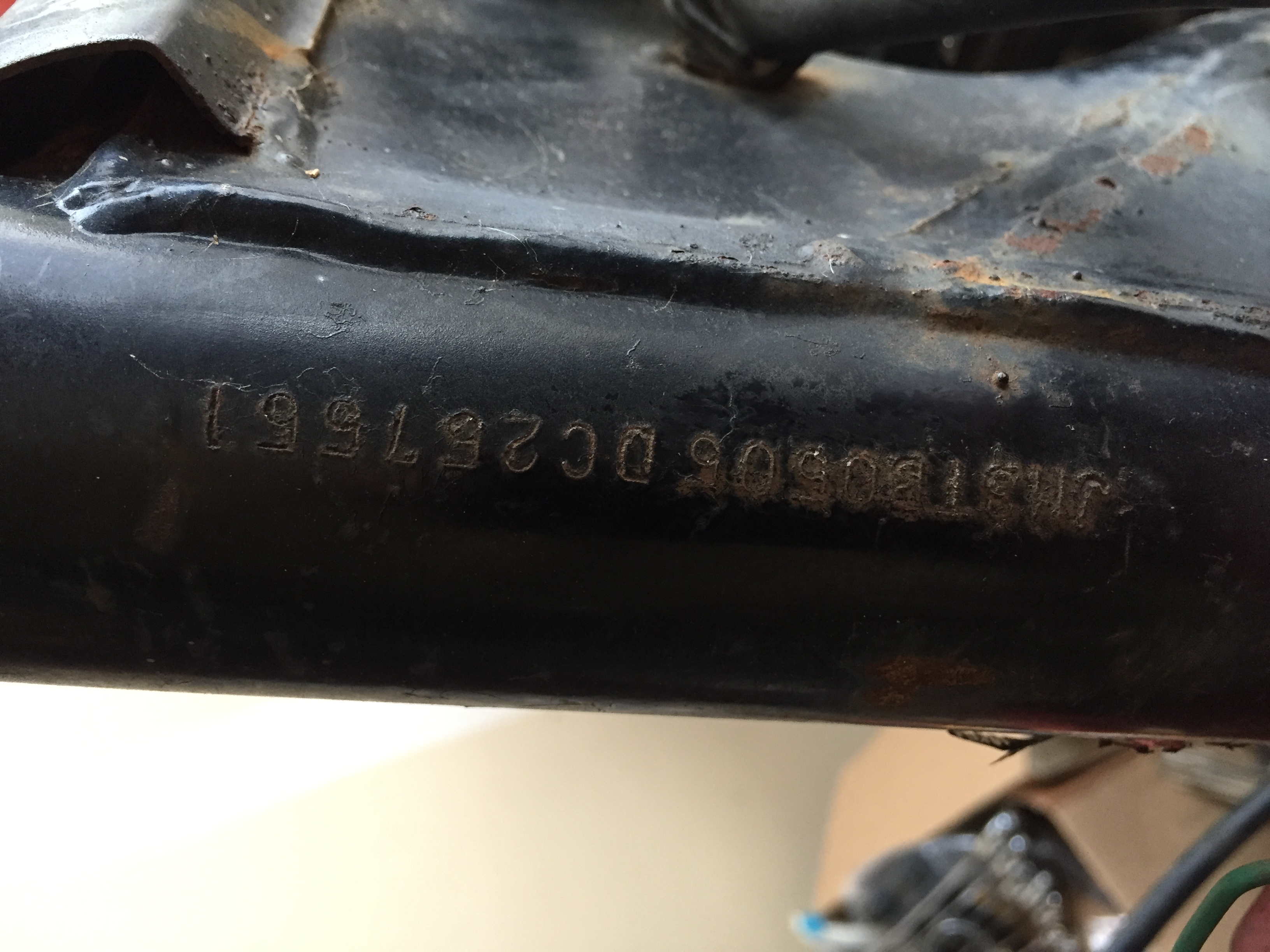

    Well actually your bike is a hodgepodge of alot of different bikes. The front end is off a 200m or 83 200. your rear fenders are 185s . your rear tires look like there off of a 83 200 200m And your tank is off of a 200s. So you really need to run the vin number off of the neck of the frame to be certain what it originally was.

    Quote Originally Posted by 86125m View Post
    Frame vin keeps coming up invalid in the decoder. From what I can tell, it says JM3TB0505DC257551

    Based on the manual decode methods for that VIN....
    Year: 1983
    Yea that is all I know how to do manually lol.
    Based on this site though... http://atcvin.webs.com/
    1983 ATC200
    Sorry I had to be the one to confirm the "bad" news. In my view point, the 200 should be an upgrade over the 185 if it runs well. I'd say if you have your heart set on a OEM 185, buy another "parts" bike, and combine the best of the two to make one. As confirmed by another member, it has the 185 rear fenders, which is another part that seems to be hard to find around my area. If the seat pan is good I'd keep the bike just because of the value of those two parts until you get the 185 you plan to build you won't know what parts you will need. I know a lot of parts interchange between the 200 and 185.
