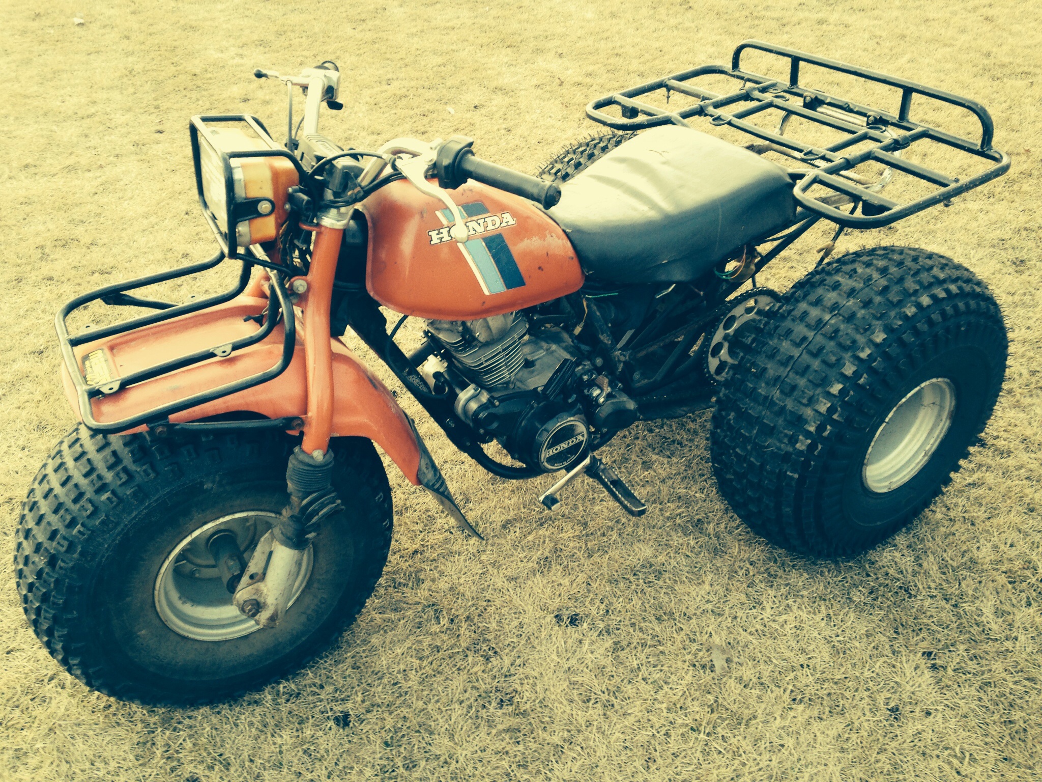

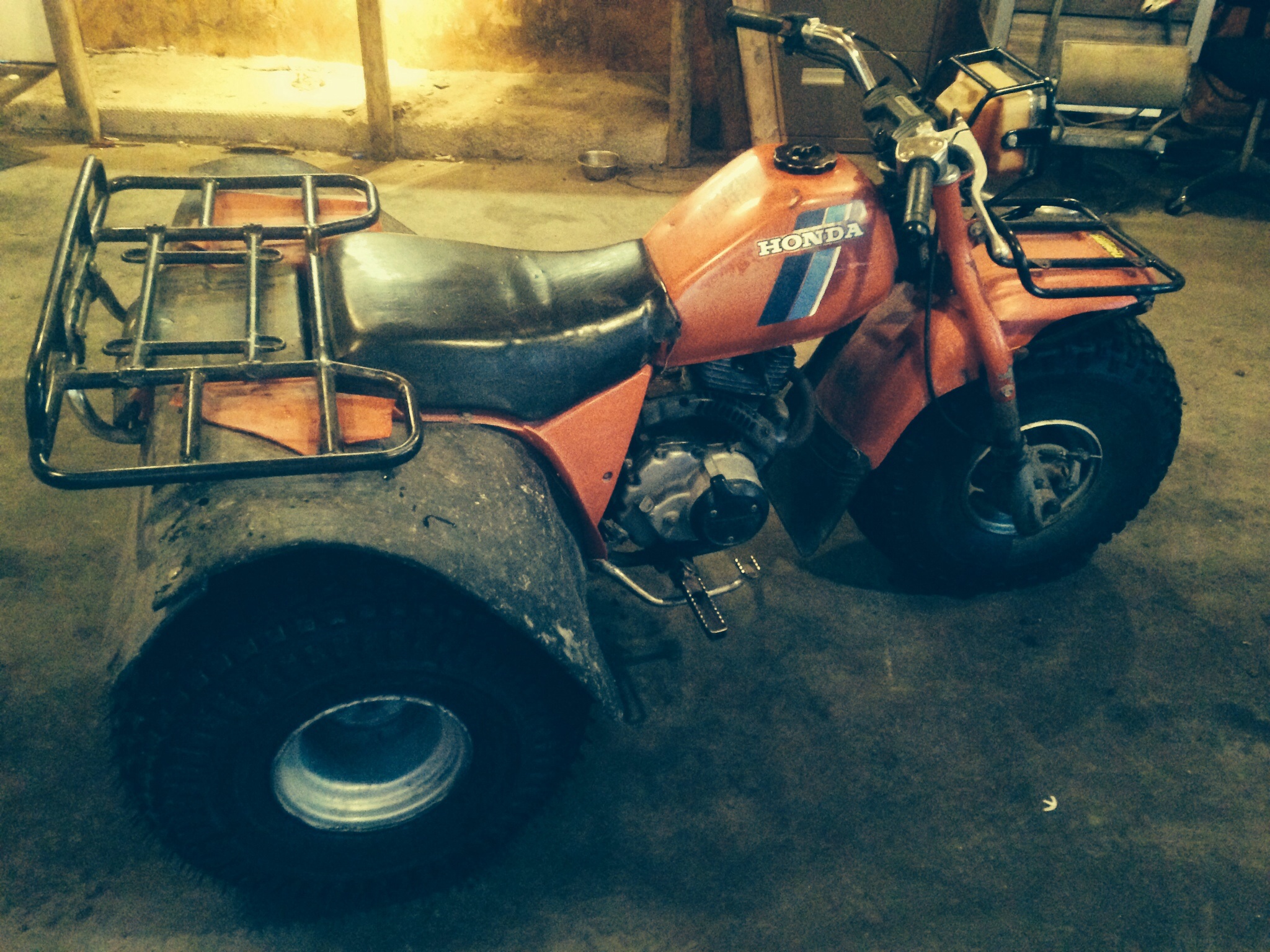

    It took me awhile to get everything done but I finally Finished redoing my childhood 3 wheeler that my dad bought for me as a kid 22 years agoClick image for larger version.

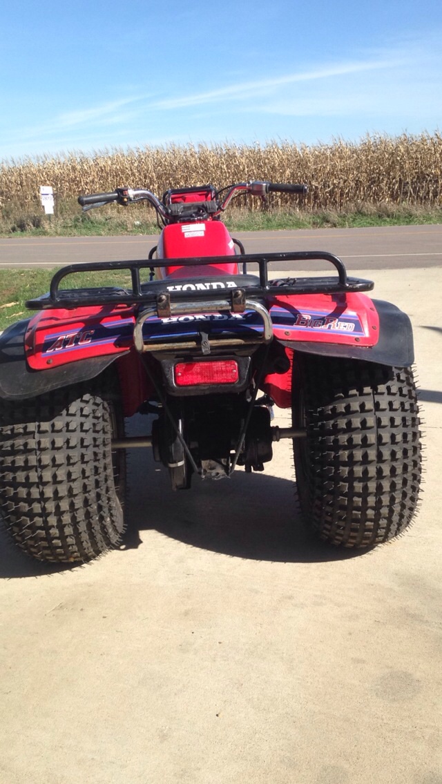

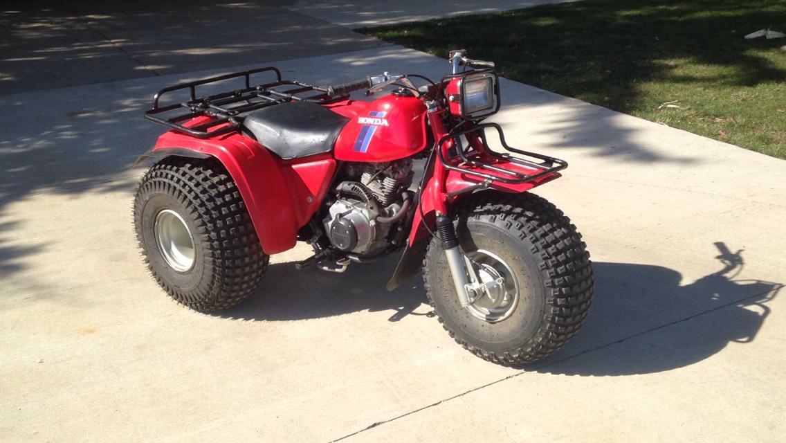

    Hopefully these are easier to see

    Thanks guys, I tore it down to the frame and painted everything. Here's a list of what I all did to it.
    fixed dents in tank and repainted it
    new wheel bearings
    Found a new front that had good shocks on it
    Found fenders that were in immaculate shape and put those on
    Chain guard
    put a new clutch in it
    tail light
    back tires are new
    new seat cover
    new decals
    new brakes and brake cables all the way around
    new starter
    It took a long time to find some of these parts that were in good shape yet (as everybody knows already), so this took me about a year to actually get it complete. Finding the fenders and decent front end that didn't have seized up forks seemed like a feat that would never happen but persistence paid off!
