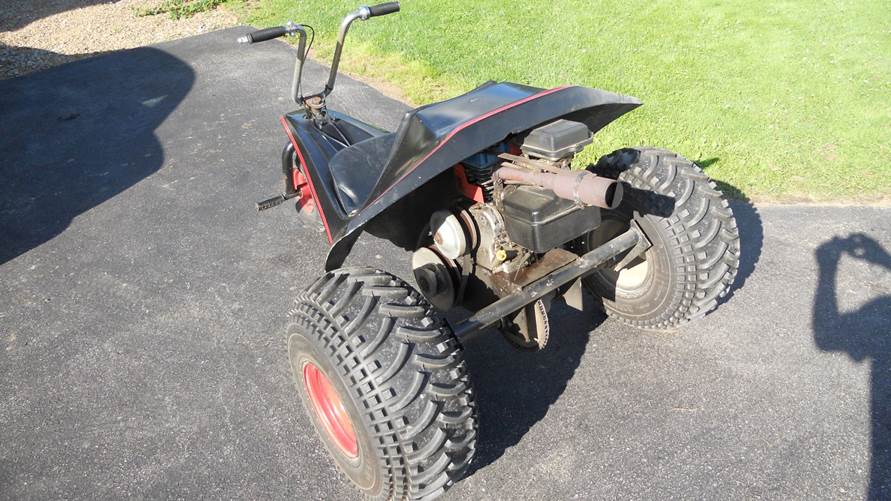

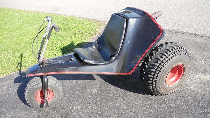

    Here's one you may not see every day - a 1972 Sperry-Rand Tricub Model 35 (5HP Briggs). My dad found this sitting in someone's yard when I was around 13 years old, so I've had it for probably close to 15 years now. Back then, it was in all-original condition - and unfortunately we didn't know any better, so we did some things that make me cringe now (such as painting it black/red).
    It sat for quite a few years once I got older and lost interest, but recently I have reconnected with it and plan to restore it to mostly original condition.
    Fortunately, even though we swapped the non-running engine with a newer 5HP Briggs engine, we tossed the original engine in the back of the shed and forgot about it. I found it last month and am going to rebuild/upgrade it over this winter and reinstall it. It currently has a top speed of 35 MPH (verified by GPS).
    There is very limited information about these things available on the internet, but I am trying to find the following resources:
    1. Decal set (or electronic versions so I can print my own water transfer decals)
    a. 540473 Decal
    b. 540572 Decal, On-Off
    c. 540474 Decal, Tricub
    2. Paint code for original yellow/green neon color
    I do have an owner's manual with all the numbers, but I'm not sure where I need to go as a source of parts.
    The frame and fiberglass tub are in restorable condition (we repaired a crack in the body with Tiger Hair many years ago). The original differential failed so we actually had a machine shop custom-build us a new differential using some original parts and some new parts ordered from the Northern catalog. Back tires are replacements but the front tire is original. As far as I can tell, the Comet 30 series asymmetrical torque converter is original.
    Here are some pics of my particular unit.
