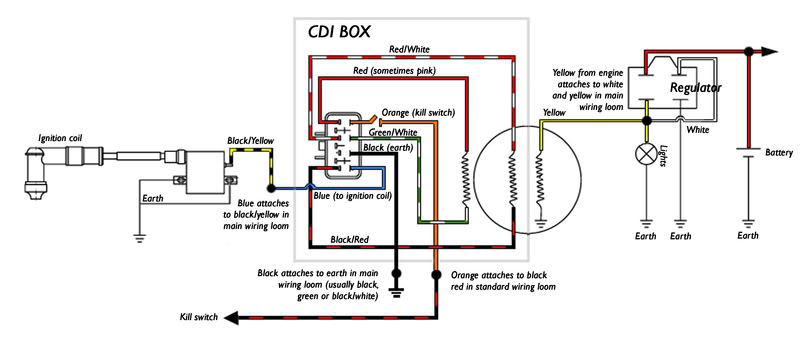

    Have a bad CDI on the runner...and not wanting to pay $4OO for a new one I did some searching and found that a Lifan CDI might be a possibility.The zuki has 2 stators and one is dedicated to the ignition system and appears to be separate from light and start system. If anyone sees why this cant be done id like to hear your inputClick image for larger version.

    Ill have to do something with the grounds which is no big deal.The zuki appears to be using ground on the kill switch,which again I can figure a way to use the kill in another way...but im thinkin this will work,and its $20 for the cdi and $12 for the plug with alil harness wiring

    Sure have...used is a $100-$150 for a used one..and dont really wanna go that route f i can help it...ive heard of guys heatin it with a hot air gun fer about 10-15 min and they work,gonna try that cuz it will spark sometimes...for $20 cant hurt to try the lifan..and the same cdi is used on another china 200cc bike. It the only one i found that takes two stator wires..others are 3 or 1 wire stator..and it has 2 wires for pickup coil and the kill terminal i found out goes to ground same as zuki. Only thing im concerned with is if the advance curve for timing in higher rps will be suffecient...i read where a guy used this lifan on the china bike and it spit n spudder,switched the pickup wires and it ran...wish i could make it all honda...already adapted a 200x carb on it....thanks for replying...at least i know someone is payin attention to my posts lmao

    The photos are kind of too small to really read, but if the only difference is the ground. flip the kill switch off and it might work. Most old machines used the kill switch to ground to turn off, more modern machines ground to run (Honda based at least).
    Another option are the China CDI boxes, however they are a bit of a hit or miss if they will work perfect or not. I know the 200es big red seems to work well on them, but a 350x isn't happy at all, unless you only want to idle around lol.
    The CDIs from my understanding have 2 basic design differences, DC vs AC, machines with a battery and a regulator will have a DC based CDI, while machines with no regulator will have an AC based CDI. Besides that, they have different timing curves and such which you can't just see or know if it will work or not. Most likely it will at least get you spark and idle though.
    If you do end up buying a non-OEM CDI and it works great for you, make sure you report back so others can run across the same info down the road that end up in the same shoes you are in now. Part numbers and such helps track the exact CDI you got (if there is any).

    I will definatly keep ya informed on how it works...if it works ill try and do a write up w pics n such...just waitin for the mailman to bring it.The quadrunner has a pull starter and will run without a battery,and it has two stators,one 3 phase ac that goes to voltage reg./rectifier for the battery,starter and lights,and the second stator is a ac floating ground and it is stand alone for the ignition system only,so it has a ac cdi on it. Im on a i pad and i can click on pics and they are larger so idk about a pc. I did manage to get a 200x carborator adapted to this thing...im confident this cdi will work,(heck i used a chevy 4 prong module and ford 460 rotor,cap and coil on my jeep AMC 360 to get rid of the duraspark box)cant wait to get it in,along with all the other goodies i ordered
