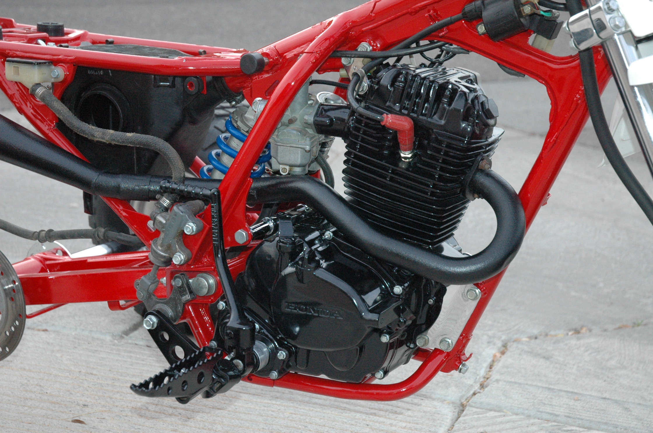

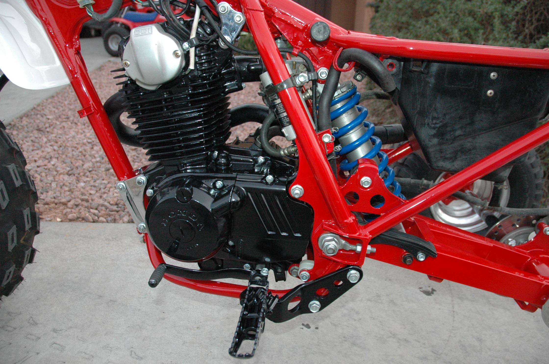

    I will do some more google searches. Does your engine have a kick start or pull start?
    Here is my 200x engine.
ID:	223529   Click image for larger version.
