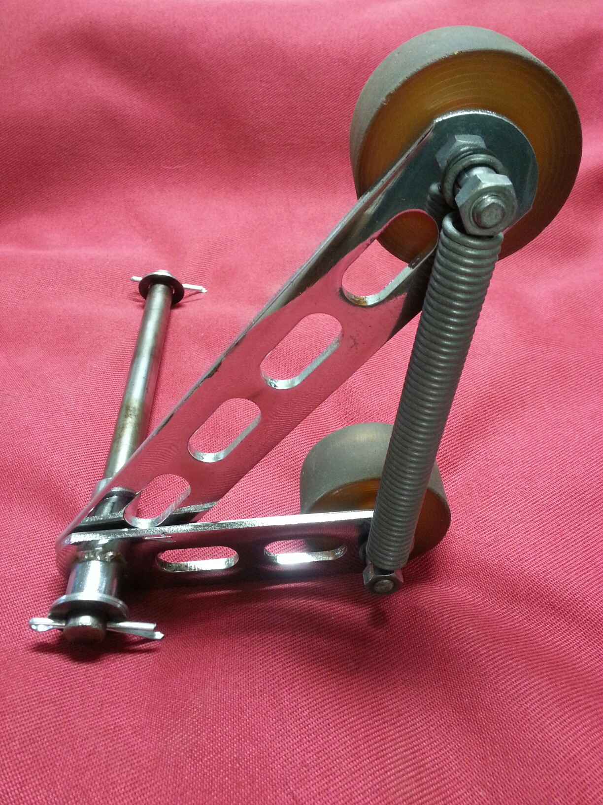

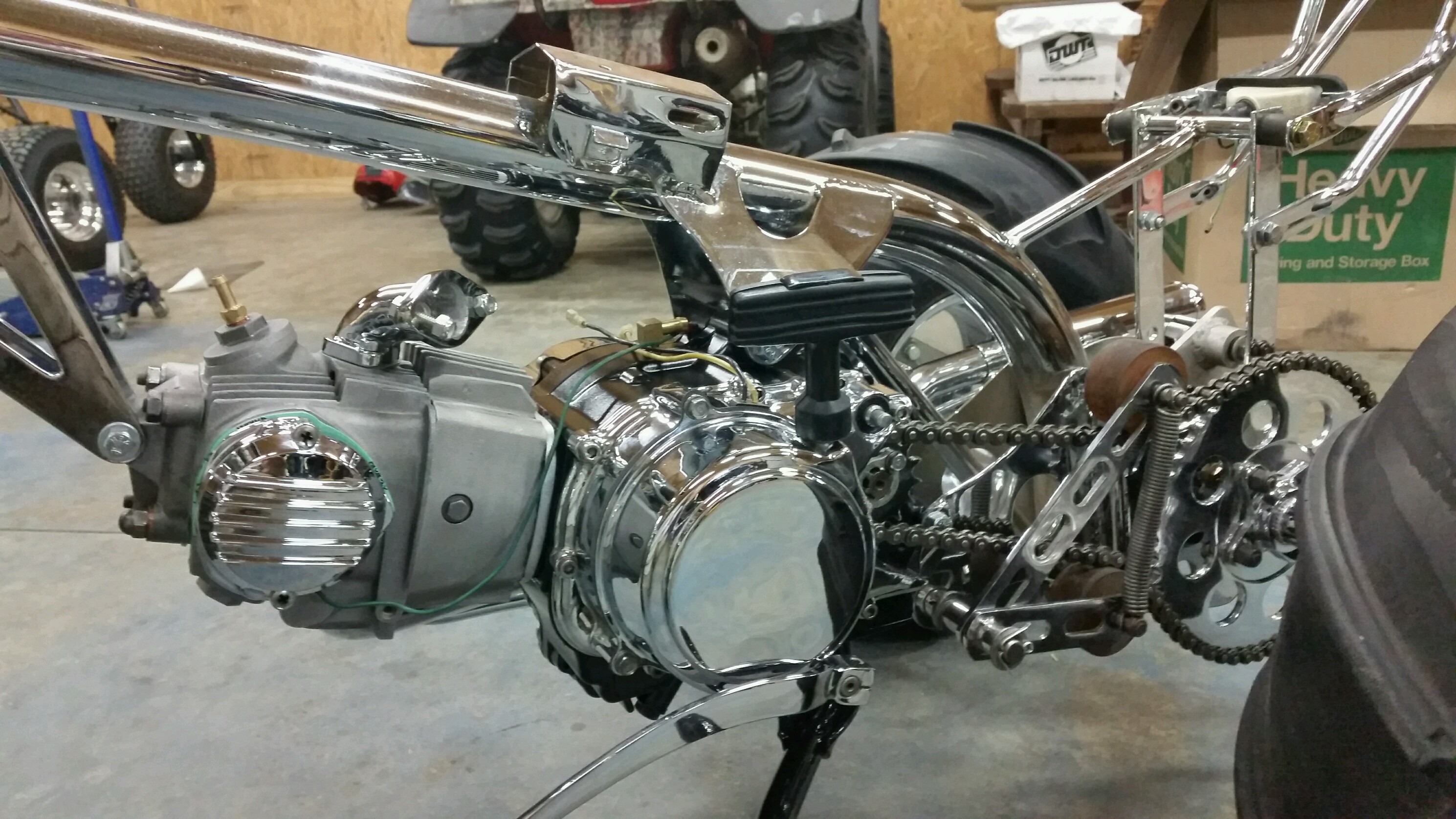

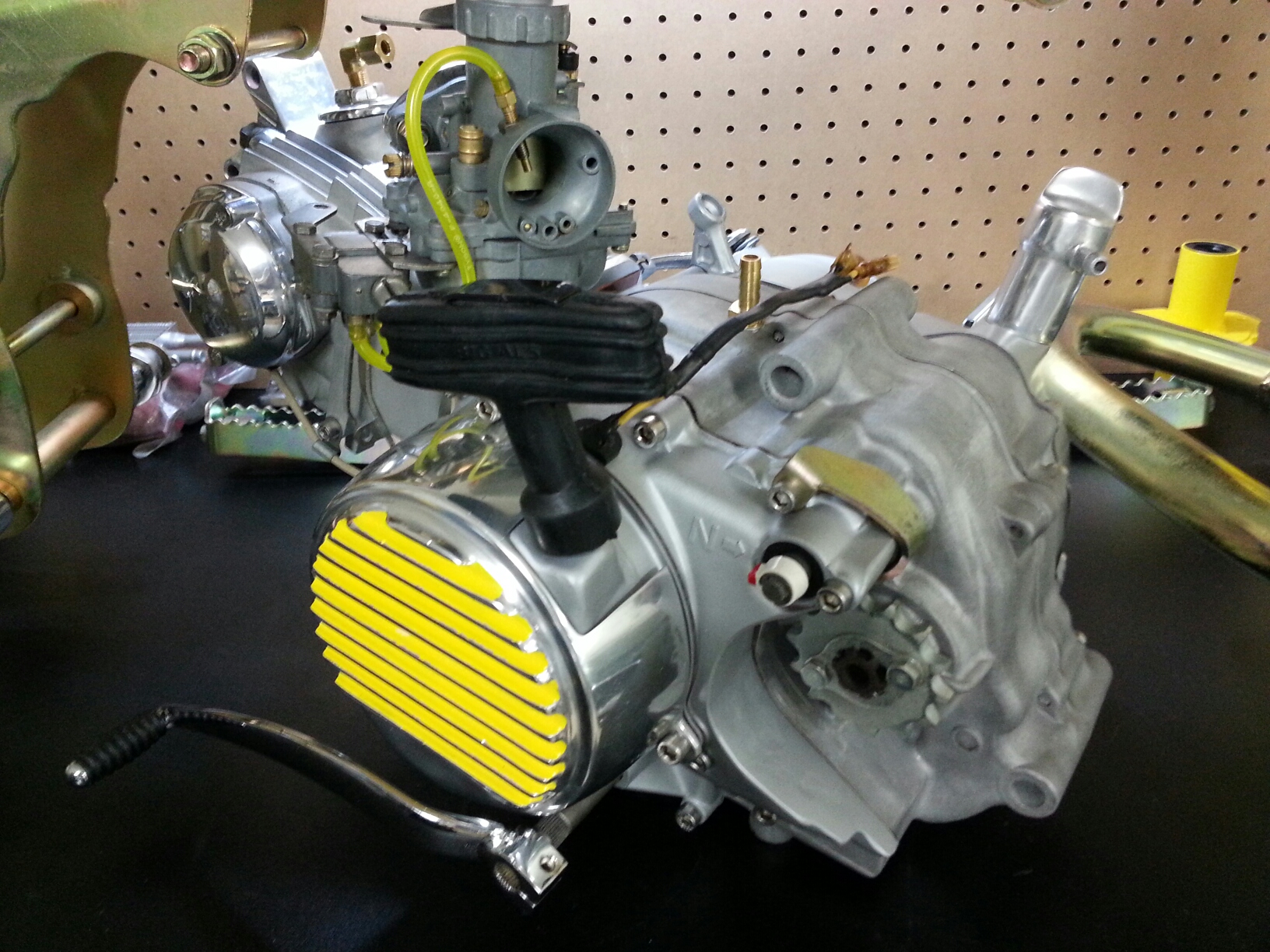

    A case saver is cheap insurance. Believe me it only takes one time throwing the chain off to bust your cases then you have real problems. $$$
    The deal with the stock chain tensioner is if you ride any at all you are constantly stripping the adjusters. $$$ With the spring loaded chain tensioner you never have to worry about stripping adjuster or having to keep your chain adjusted.
    Insurance:

    Insurance and Time Saver

    So what company used to make the tensioners? They seem like a good idea to get one.

    BAPP - Big Al's made a couple of different designs and Cancilla were the main people making spring loaded chain tensioners.
    Cancilla were more for racing as well as the HD version from BAPP.
    Here is a Cancilla:

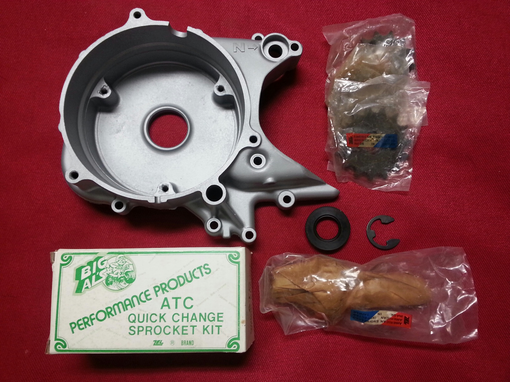

    Hey in that one pic with the engine the Joe has posted with the yellow pull starter, I would like to get one of those left side cases that eliminates the hi lo range, does anyone have one?

    Here ya go.....
    http://www.ebay.com/itm/151876841188...84.m1555.l2649

    Are those cases like homade or something, or is this made by Big Al's?
