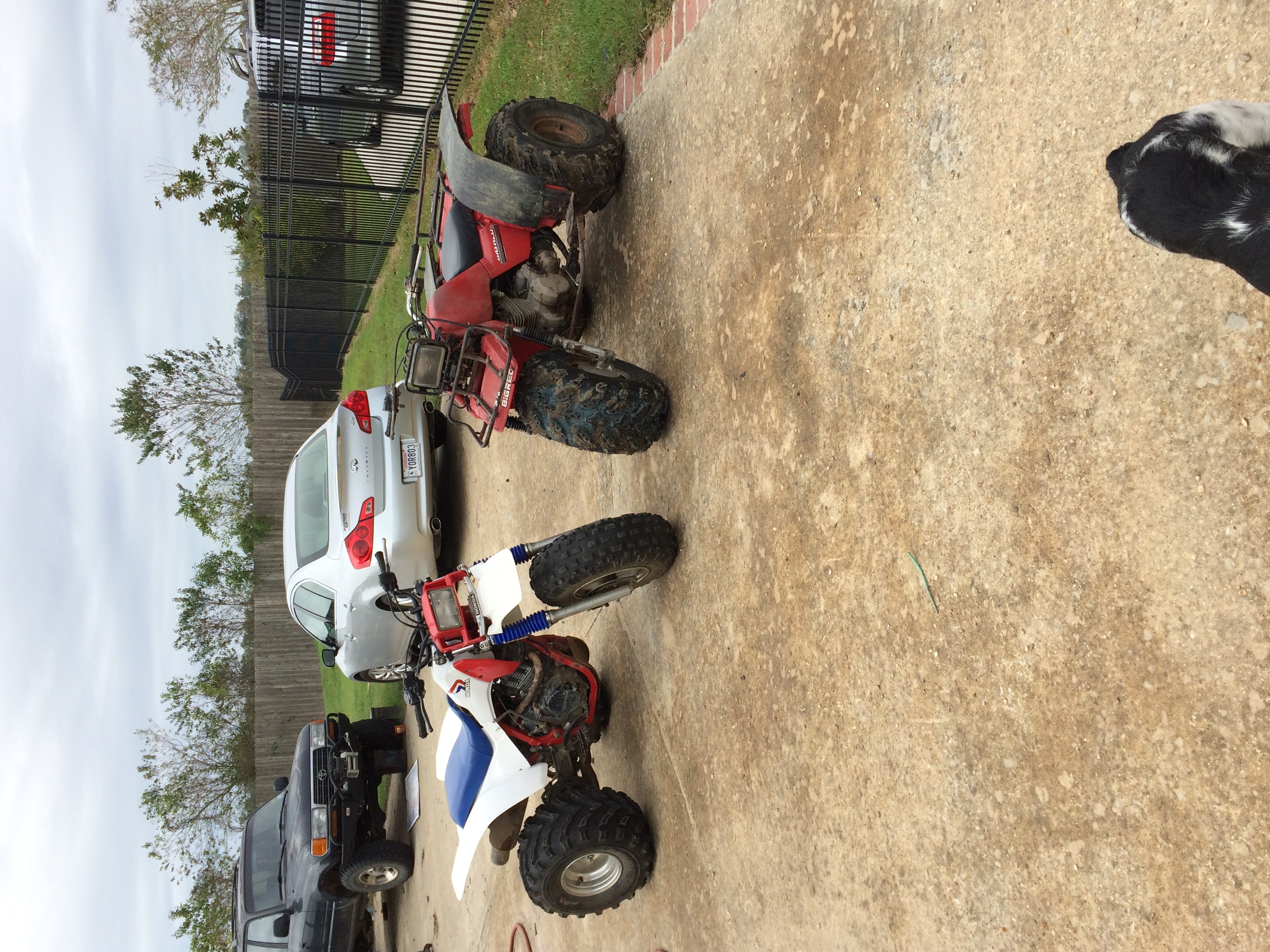

    I got a 86 200x yesterday and it's wonderful, but the rear brakes don't work I've bled it twice and made sure the cylinder isn't seized does anyone have an idea why the cylinder isn't moving.
