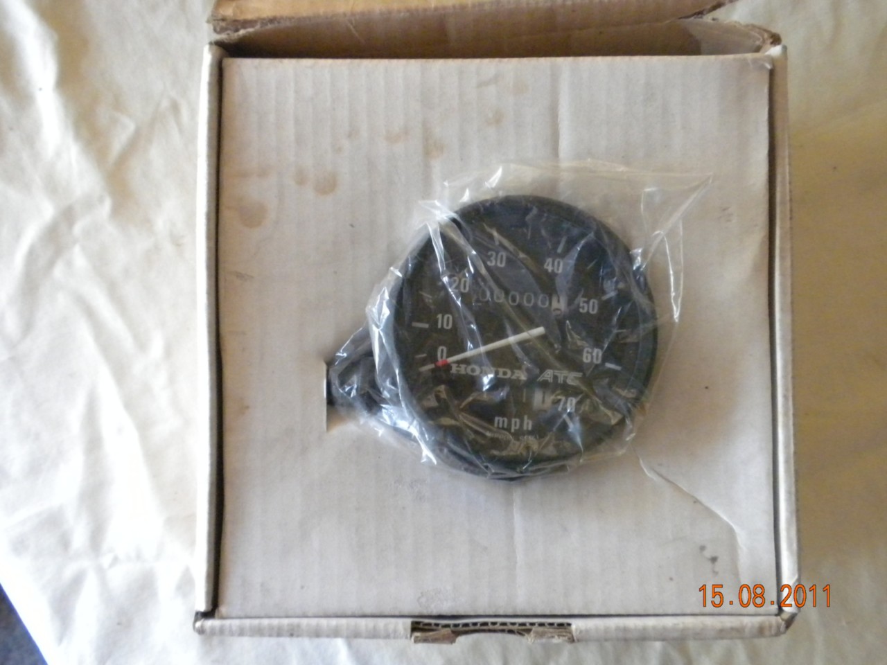

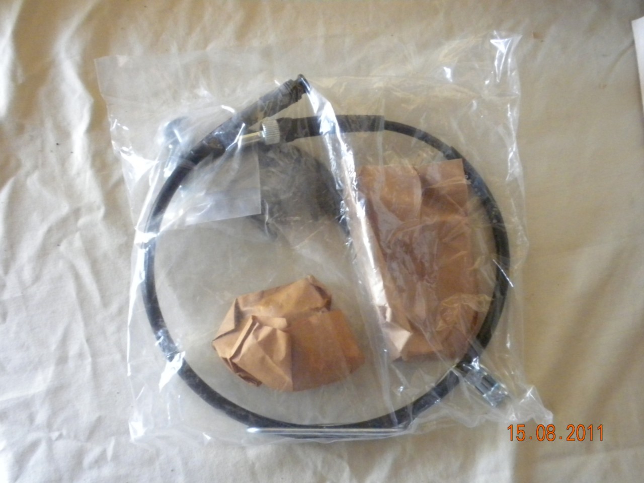

    Honda actually made a specific mounting kit for the Fatcat. Unlike the others that had the speedo head and mounting kit separate, the Fatcat had the speedo and mounting kit all in one box. As far as the cables are concerned, they are mostly all the same with the exception of the length. It is the gear box that is either a right or left side setup. I believe the fatcat uses a right side setup. These pictures are not very big but they might help. The gearboxes are mostly bike specific. They differ in right/left configurations and front tire diameters. Its not an exact science. They are meant to be within 10 percent of your actual speed. You could use another gearbox from a different ATC as long as it was a right side configuration. So you would need one from a 85-86 250r, 250sx or 350x. The fatcat uses a 24.5" tire, so any of those bikes gearboxes would be pretty close in speed.

    Not sure I follow exactly, the gear box fits perfectly, on the right side. It even has the little notch that drives the gear....it also mounts to the bottom or the back of the fork, I'm assuming that if one of the years mounts to the top, it may turn the cable the opposite direction?
    Arizona
    507
    Even though it fits on the right side, it would probably result in the cable turning the cable in the opposite direction. When the bike is moving forward, the cable should spin clockwise.
    The way it mounts up on the 200es is on the left side with the round portion facing toward the rear or the bike, so if "<" indicates the front of the bike, it looks like "<b" while looking at the wheel from the left side. If you mount it on the right, then it would look like "b>".
