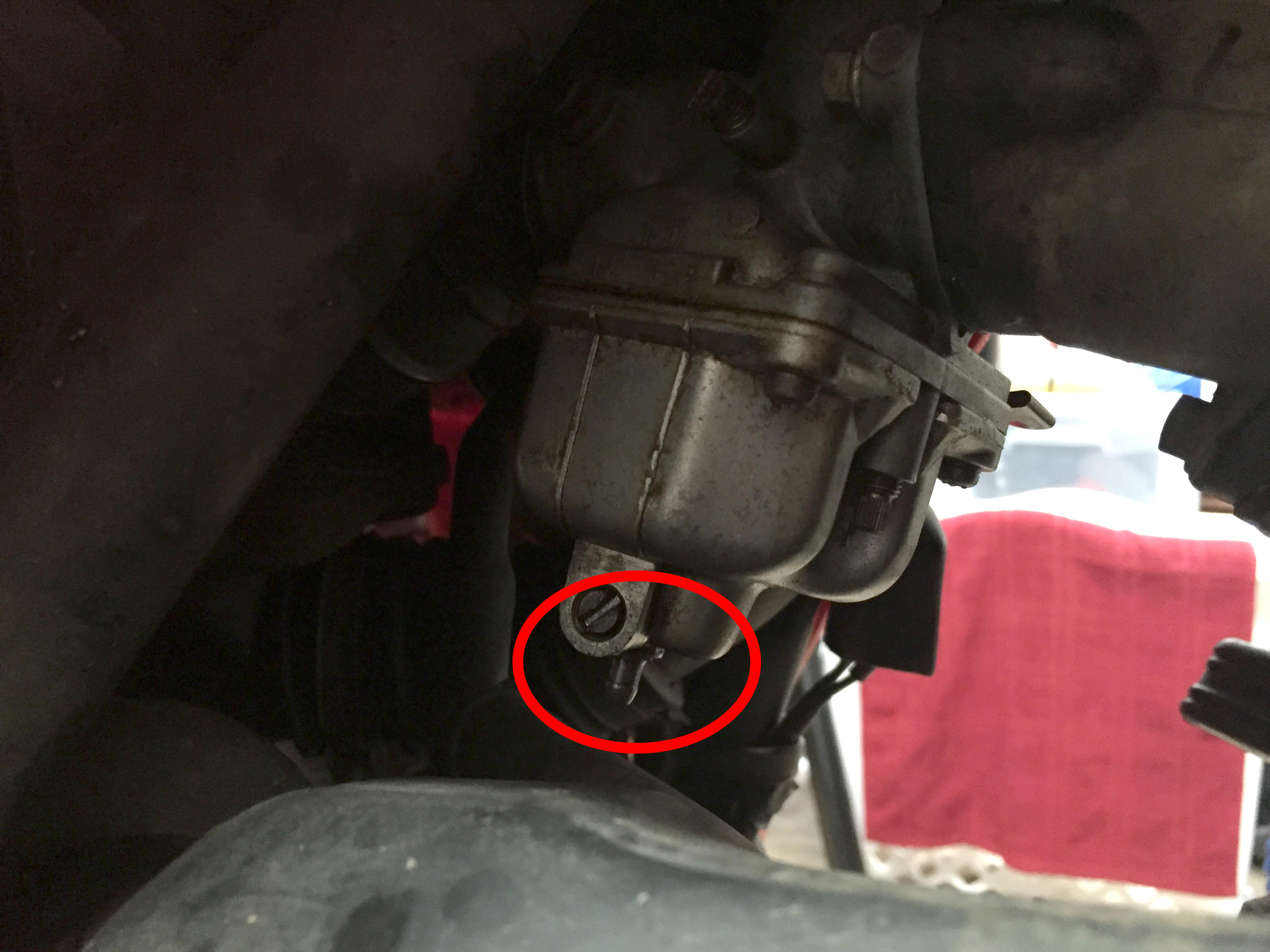

    Hey guys, picked up a new to me 86 200s and after looking everything over noticed that I may missing a hose connection under the carb. Below is a picture of what I'm talking about.
    Do you know if I need this? If so, what does that hook up to?
    Thanks in advance!

    That is for a over-flow drain tube.It just drains to the ground. Just run a small piece of tube from that p.o.c to below the motor,for drainage. Good luck.
