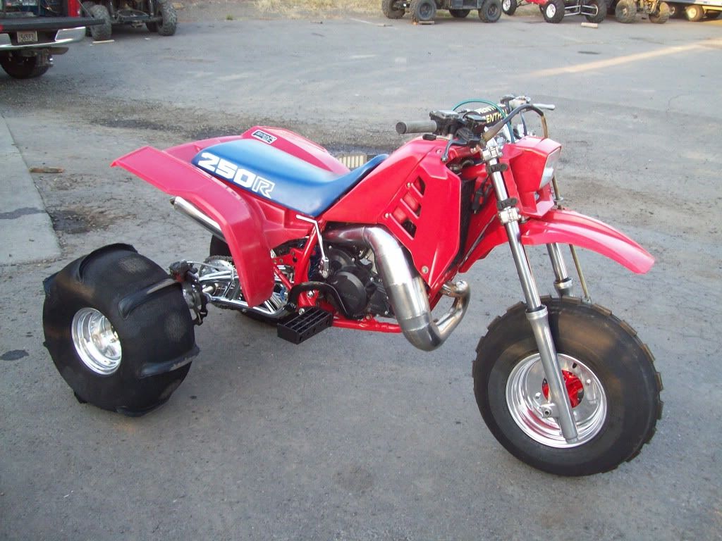

    Looking for any info on gusseting 85-86 250r frame.Im planning to race Unadilla trike race this year.Also any tips on front and rear mx suspension setups.

    I have seen Jacobs 330r with the inverts on it he rips on that trike.I didn't get a close up look at though. I was hoping to get pics of some gusseting so I don't have to ship a frame out. I can weld and I know a couple guys that weld for a living.

    As Lou suggested, I'd talk to Jason Hall. Even if you don't want him to do it, just give him a call.
    I haven't seen a neck break yet but it will. I already broke off the right side of the upper wishbone on my 350RX, so I have to do some work on the neck this winter running inverts.
    The R seems to have allot of stress on the upper main tube, Kintore broke his, but I'm sure it's got stress in plenty of other places.
    I don't know how big you are, Jason's son Jacob is a pretty lean kid and mostly muscle. He's a very smooth yet aggressive rider and he hits BIG jumps.
    I'm surprised he hasn't gotten another low hour and low stress frame to gusset. I bet he's headed in a different direction now anyhow with Jason Hall having the ability to convert a MX frame to 3wheels now.
    And Louis isn't too far behind him; 2 very smart people that couldn't be nicer to work with IMHO......

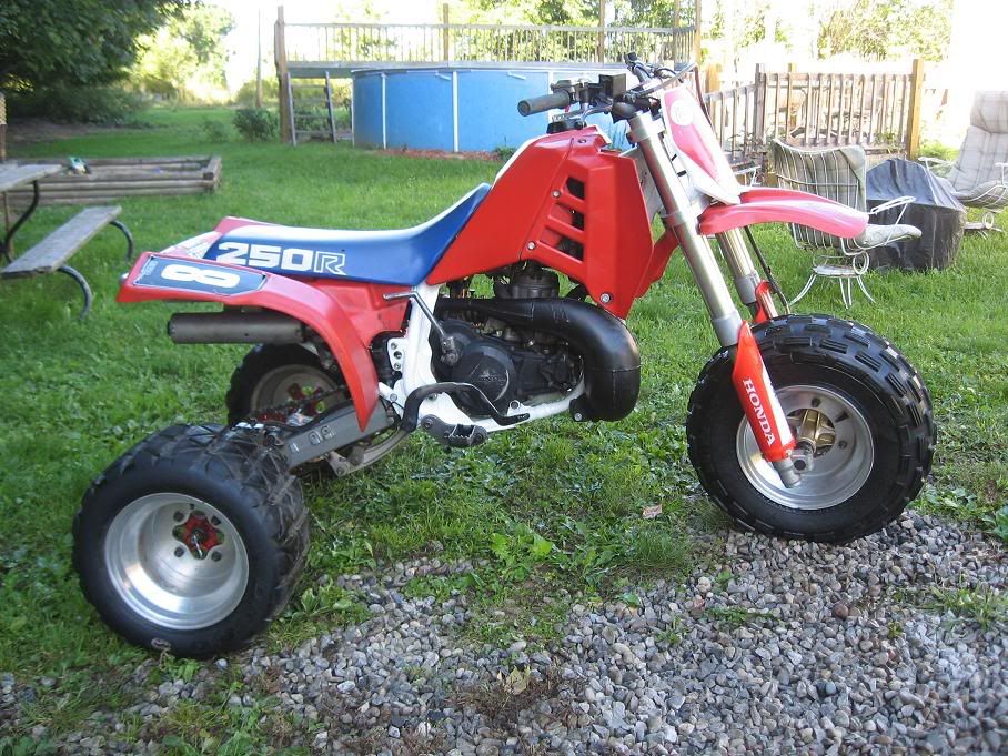

    A couple good places to gusset the 85-86 250R is the square tube above where the exhaust pipe comes through the frame. The main tube under the tank. Also the side tubes that come down to the swingarm pivot area. Most of the R's that I have seen break have been jumped big and bottomed out hard. When the suspension hits the stops Hard the stress on the frame is a lot worse. Also like Louis stated rust is a big problem. Most of the time you can't see the rust because it is inside of the tubes. I would try to find a clean west coast frame to start with. Another weak spot is the footpeg mounts on the 85 frames. A 86 is much stronger in the peg area.

    I see Jason has given you some info . . I started this a couple hours ago and maybe if Jason sees it and can add or change anything, it might help you a bit more.
    I have never seen an instantaneous catastrophic frame failure . . On the broken frames I have seen, they always started with a crack that went unchecked until the failure occurred . . At Kawi, we inspected every bike we tested for cracks at specific time intervals . . If a crack occurred, we would measure its length then mark the end of it then beat the crap out of it some more until eventually we felt it was unsafe to ride or the test was over . . After this, I would repair the cracks then add gussets where I thought they were necessary then we would beat the crap out of it again etc until it no longer developed cracks.
    The point being that no matter what you do to strengthen it, it still may crack somewhere else because the stress/load has simply been moved to a different place from where the gusset was added, so every bike that gets flogged should be inspected for cracks periodically no matter how many gussets are added to it.
    You could also check with HREATV to see if they make any kits for it or see if they have other parts you might want.
    http://www.hreatv.com/productionparts.html
    Below are couple shots of Jasons bike I shamelessly plagiarized off the internet . . I would guess he will send you more if you ask him, but from what I can tell, which isn't a lot, it doesn't look like he has done any reinforcing on the steering head . . It is also nearly impossible to break to steering head off one of those or most any bike unless the frame is rusty as mentioned, and/or gets bottomed hard as Jason mentioned, and if anything was going to break on the front, it would most likely be the down tube and the wishbone tubes.
    DOWN TUBE
    If Jason doesn't do anything to the steering head or down tube and you are worried about it breaking, one option would be to simply get a piece of 5/16" thick flat metal the width of the front of the down tube that will run from the gusset/bracket on the bottom of the tube all the way up to where the factory gusset/bracket is near the top, which is just below the Honda sticker on the side of the frame in the first photo, then weld it to both gussets and fully weld the sides and bottom to the down tube . . You will need to cut a slight V into the bottom of the new plate so it follows the contour of the bottom gusset/bracket.
    BRACKET REMOVAL
    It looks like he removed the small mounts that are on both sides of the steering head which can also be seen in the photo of the right side.
    REAR SECTION SEAT AND FENDER SUPPORT
    He made the rear section removable as he mentioned, however, you can put small triangle brackets on the rear section where it meets the frame like the 350x below has, but they can be smaller than that . . 3/16 inch material is thick enough . . You can also put holes in them to lighten them like Honda did on the top one seen in the photo.
    SWING ARM BRACKET AND REAR VERTICAL FRAME TUBE
    It looks like he attached a gusset to the leading edge of the existing swing arm gusset then extended it upward and down ward.
    MAIN BACKBONE TUBE UNDER TANK
    If Jason means that this tube can break somewhere between the steering head and where the rear part of the frame attaches, you can get a .125" wall tube that has the same id as the od of the backbone, then cut it in half lengthwise and long enough so it will weld to the steering head and the top bracket near the rear frame, then weld the sides completely.
    1985 FOOTPEG BRACKET
    I don't know where these mounts break, but my guess is that they can tear the metal around the perimeter of the nut insert which is on the inside of the bracket . . If this is the area they break at, it looks like, a flat piece of 3/16" thick metal the same size as the bracket could be placed on the face of it then fully welded . . The radius on all sides of the bracket will act like a pre-made groove for the weld to fill in . . Obviously this will move the footpegs out 3/16" but big deal.
    FRONT STEERING ANGLE
    It looks like he used non staggered triple trees . . If so, this brought the steering angle way in, and along with the leading front axle, it made it much more like....dare I say it....A "TECATE...The Best Turning 3 Wheeler In The Universe".
    1986 250R FOOT PEG MOUNTS
    1985 250R FOOTPEG MOUNT
    SOME NICE WIDE FOOTPEGS LIKE THIS MIGHT HELP SAVE YOUR FEET ON HARD LANDINGS BY SPREADING THE LOAD OUT OVER A WIDER AREA
    1985 STEERING HEAD GUSSET
