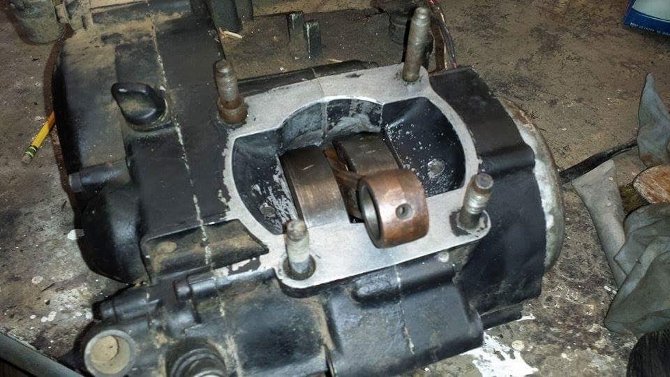

    I have a motor YZ 250 s/n 56A00 w/ Crank starter and cylinder of tri z and a connecting rod 3R5.
    And i buyed a yz 250 piston but it's not compatible with my motor and with a piston of triz it's the same.
    Piston excelled
    Connecting rod
    my question is, which piston is that I use?
    Thanks in advance

    You probably have to use the piston for the Tri-z. It is possible that the wrist pin won't fit the YZ rod. I'm not sure, but it's something to be aware of.

    I'm going to guess your rod is too long, correct part # for a z rod is 24Y-11651-01-00

    A colleague told me that a possible solution would be to put a spacer gasket between transmission and about 1/2 inch cylinder that is what stands out the piston
    You think it would be correct?

    A colleague told me that a possible solution would be to put a spacer gasket between transmission and cylinder... You think it would be correct?
    Yes. Unless you want to buy and install a new rod.

    Thanks for the reply I'll try
