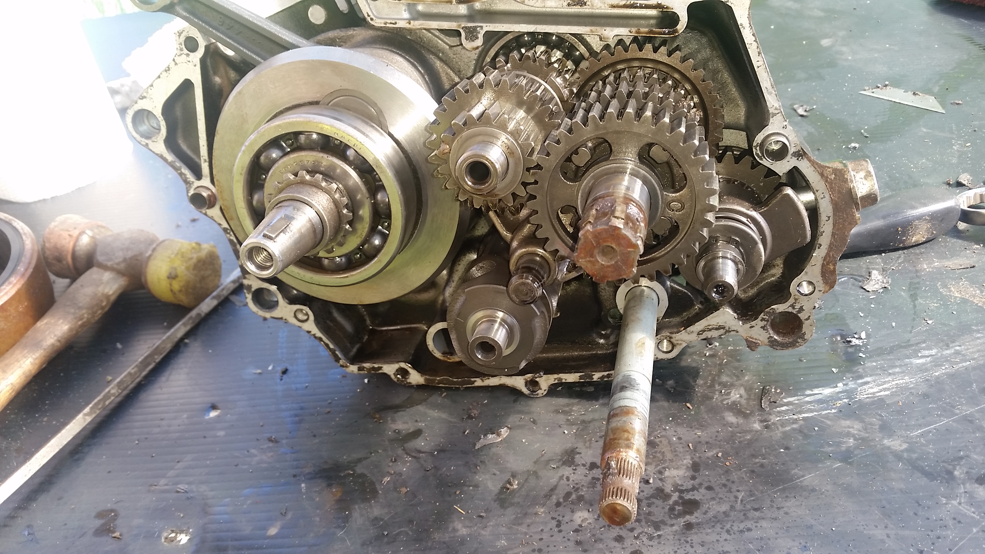

    I got my crankshaft out. The 7/8" socket worked perfectly. Now for the bearings. I am gonna have to get some of those. Weisco 65.5mm 10.25:1 piston on order, bottom and top end gaskets too. I have been looking at some threads here on the forum about the Kickstart gears slipping. Some guys were back cutting the gears. I may go for this mod as it seams fairly simple, since it's apart. As for the bearings in the third pic the bearing on the right seams sticky. Is there anyplace that sells a full set of bearings, or should I just replace as needed?

    I am wondering if anyone knows a good source for these bearings. Or can I just order from any bearing manufacturer.
    Slidell, LA
    4,738
    Last 200x I built I had to look hard for some of the needle bearings. Most of the roller bearings are still easily obtainable. If you can't find the needles you may have to take the old ones to a bearing mfg.
    Sep 2014
    Oregon
    591
    I'm hoping its just the one bearing in one of my above pics. It's a little sticky.
    Slidell, LA
    4,738
    If you are referring to just the bearings in the pic above then those should be readily available. Now that you have the cases torn down this far, I would replace as many as you can. Sticky or not, they are 30 years old and likely need some attention.
