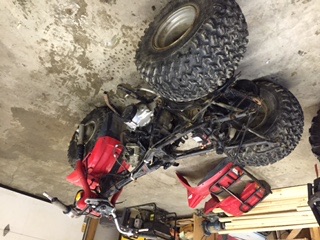

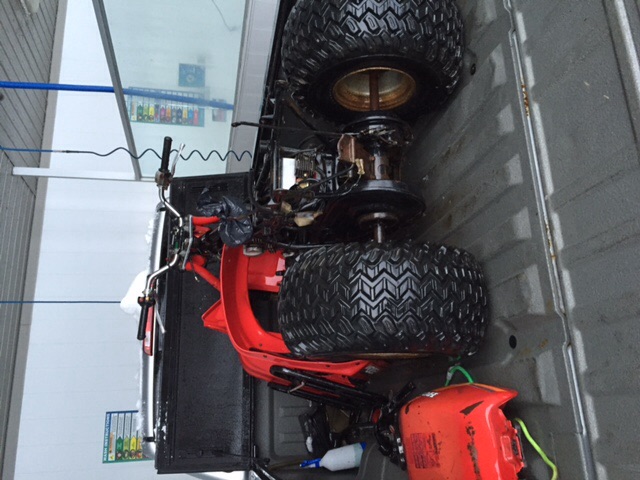

    I picked up an 84 200m for a$100 today! I started tearing it down, it's a little rough but seems to be all there!
    Battery is dead of course but I put my booster pack on and the light lit up and the starter even works!
    Tires are pretty crappy and I gave the seat to my mother to re-apolhster.
    Rear plastics aren't cracked but front is toast.
    What do you guys think ?
    Any suggestions where to begin?
    I'm starting with a new plug and a carb cleaning,
    Thx.
    I'm new here so I hope my pics show up

    an OIL CHANGE would be one of the three first things i do when buying any used toy(plug,carb clean,and New Oil) it wouldn't help to flush or clean the tank and petcock(fuel shutoff) and run new lines and grab a inline filter in case the internal one in the tank is full crap, wow i wish i could find them for that cheap even BEAT im going to be on hoarders if i keep it up with the number i buy, just started on the ATC thing maybe 6months ago and have 3 bikes( 1980 185/w 82 185s engine,1984 200s/w 82 200e engine, and a 1983 atc 200 that run and drive, one i had to rebuild the top end (200s/200e engine) with oem stock stuff and the atc 200 needed carb and some wiring done, and the 185 came with the top end rebuilt and just needed a tune, but hey i love them and i think 4 wheels is 1 wheel too many.....LOL

    First thing to do is download the service manual and start reading. You can search this site for the link.
    Then I would start with draining all the fluids and replacing. Don't forget the diff. Check the tank well for rust and leaks. I run clear tubing and a see through filter on my 200es.
