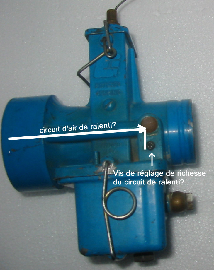

    I don't think there are any new aftermarket carbs that will be long enough, however, a vintage EI or Lectron carb should be, unfortunately, most of those have a 4 stroke style needle jet, so you would need to see if a 2 stroke needle jet from a later style Lectron would fit, plus you might have to change the air jet sizes so it's a bit of a gamble and a hassle.
    This has a long bell which is one of the things I mentioned that you could do to yours somehow.
    This is an EI carb and all of them were blue, but it is nearly identical to the Lectron because the same person designed both of them.
