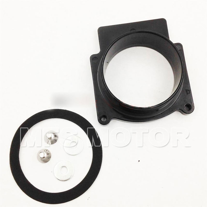

    I went with this adapter:

    Well, all the parts are here and i temporarily fitted them to see how it's going to work.
    Overall I'm pretty impressed, I think it will be a great upgrade over the stock set-up... I took a few pictures so here they are.
    For the price, the plastic mounting flange looks good. It comes with 2 screws that thread into the flange and a foam ring to seal it to the airbox. The foam ring doesn't fit into a groove or anything so I'll probably just use some RTV sealant instead.
    The uni-filter I used was model UP-4275AST, which is a dual layer 4.5" x 4" filter with an angled 2.75" opening. I went with the angle because it would give me more mounting options and not stuck against the side of the airbox.
    The 2.75" opening fits the mouthpiece perfectly.
    You can see the adapter is more than big enough to supply the air required for the 200 thumper.
    Also fits into the factory filter "notch" nicely, the 2 holes that will need to be drilled are not obstructed by anything on the other side.

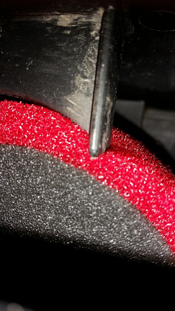

    Mocked up you can see why I chose the angled filter, the filter itself is about the same size as the factory unit except has foam on the end instead of a plastic cap so It'll provide a little more air.
    Note that with the factory airbox installed the grooves that hold the stock airfilter will hit the new filter, not sure if I'm going to trim them off or leave them be. It wont really obstruct the filters performance and I can still close the lid securely. If you slide it forward as you close the lid you'll actually just compress the filter a little which is fine. The filter as a spring to keep the filter rigid but allow for flex as well.
    This dual layer filter has the option to run without the external foam, it'll clear everything then but I like the idea of the added filtration.
    Hopefully that helps anyone else out looking to do something similar, I'll report back once I have it fully mounted and secured and fire up the bike.

    Here it is mounted, I did end using black rtv to seal the flange to the airbox. I also ended up trimming the tabs off of the airbox lid. The chance of this thing ever running a stock filter is highly unlikely.
    I did reinforce the areas I trimmed with epoxy though. I used longer mounting bolts that came with the kit and secured them with lock nuts. Bike seems to be running good, I will dial in the carb when it warms up outside.
    Ugly... but no one will ever see it.

    $30.47 total, I ordered the same parts after I read this. I have a paper filter on mine due to the factory seal failing on my trike back around 1985. I'm looking forward to getting it installed. I can assure you it will not increase or decrease the power of your YTM. These are what I ordered, can't guarantee they will fit though as I haven't received them yet.
    http://www.ebay.com/itm/141884880552...%3AMEBIDX%3AIT
    http://www.ebay.com/itm/201508040210...%3AMEBIDX%3AIT
    Mexico
    9,018
    I installed mine today. Perfect! (almost) I didn't have to cut any of the factory box ribs. I did have to raise the hard plastic flange up about 6mm from the lowest point it will go into the box. If you don't the thick flange on the air filter takes up all the space and you can't get the clamp on properly. The other thing is that the flange bolts are useless. They're tapered, but there's no way to countersink the air box that deep. The bolts aren't Metric and one hole in the flange doesn't even have threads I drilled out the holes and used SS button head screws with nyloc nuts on the inside.
    The foam seal is pretty cheesy too. An O-Ring would have been perfect.
    I'll give it an 8 out of 10. It may not be perfect, but it solved a problem that's been bugging me for a long time.
