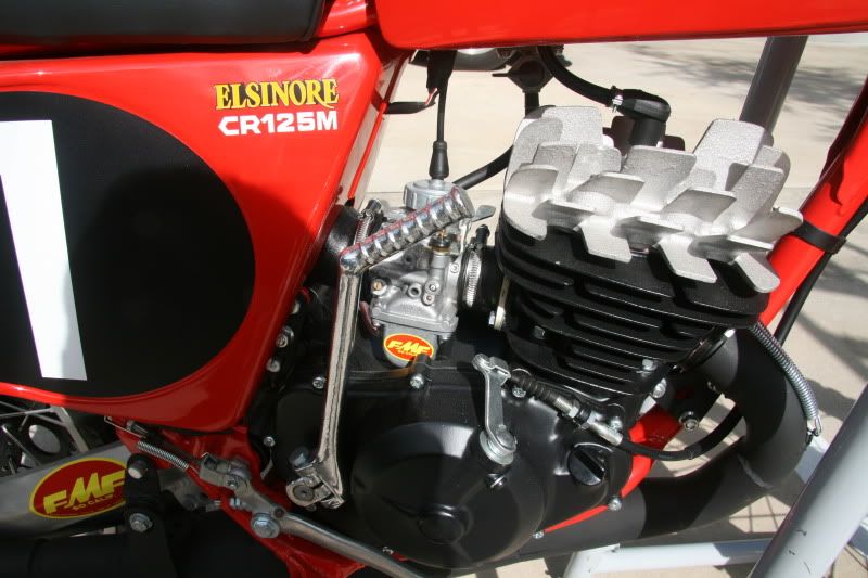

    yes i know there were some aftermarket cylinder heads like the dg for the cr125 and 250 and the one for the cz's that falta had on his works bike that used staggered fins, but that in no way meant they were more effective and may have partially been a marketing tool . . if the mfg said it worked better, it must have, but then one should ask themselves why other high perf aftermarket parts mfg's or bike mfg's used straight fins instead . . one think is for certain though, back in the 70's, people thought that staggered fins made their bike ook more aggressive and "works" like so many people bought these types of heads for that reason alone . . i put one on my "works" 1974 CR125 for that very reason.
    FMF Porcupine head
    DG GOLD head . . Notice the silencer coming thru the middle of the rear fender in the wheel area.

    Cool looking head. That was exactly what I was thinking. I had a dg head on my FL250

    yeah, that FMF head just has wicked written all over it . . the dg head is just the opposite with is elegant, smooth, radial design.
