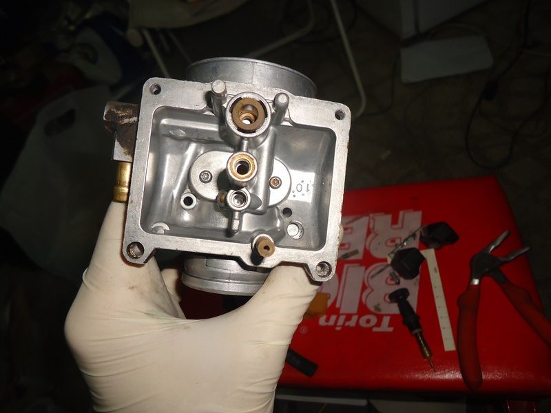

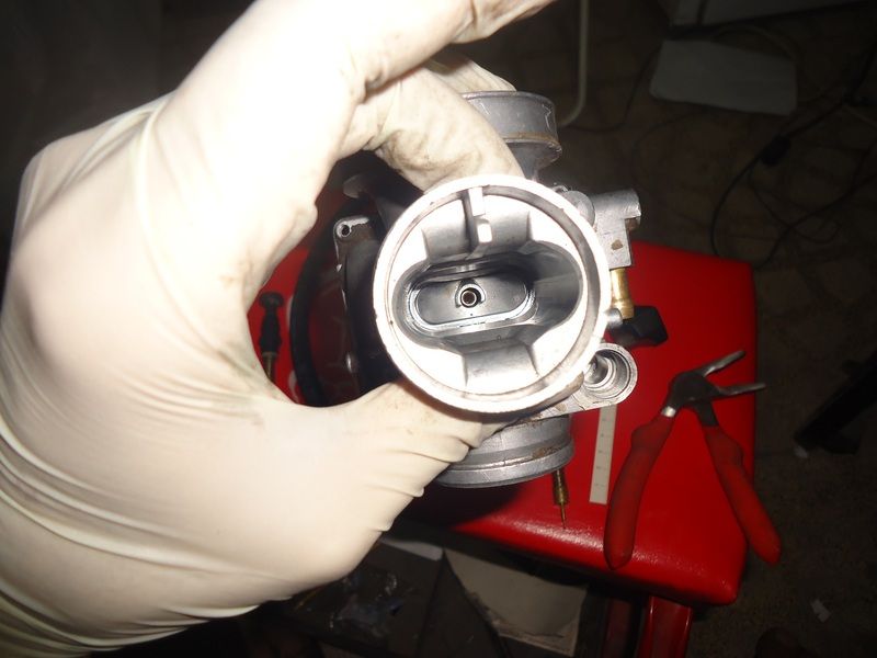

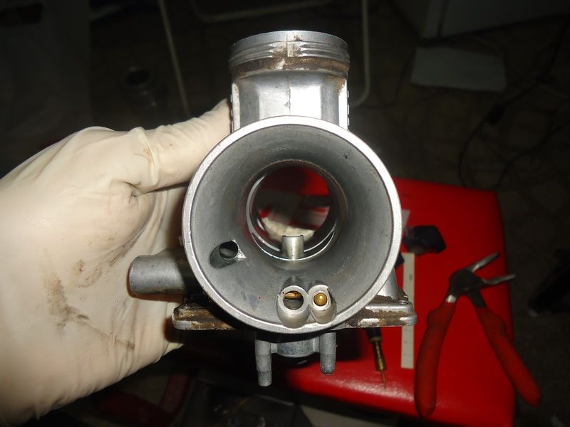

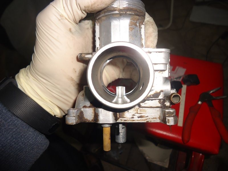

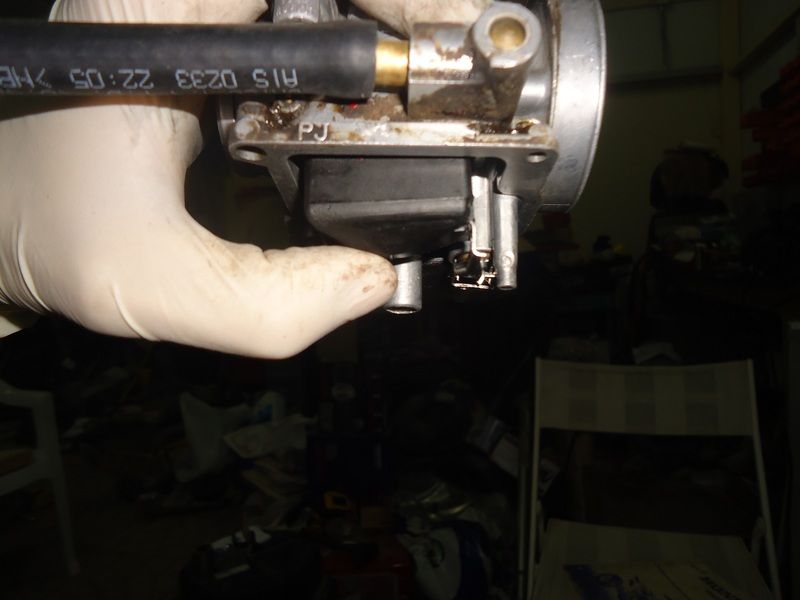

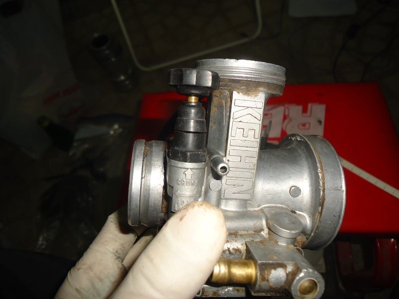

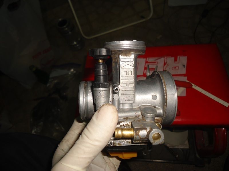

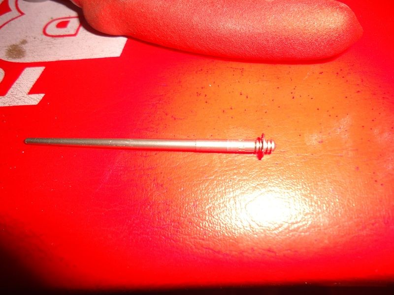

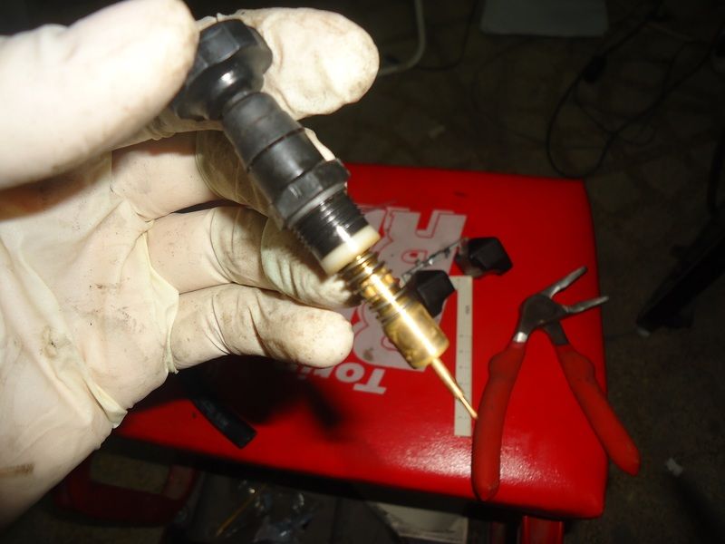

    I'm trying to start up my '86 ATC 250R using its original carb and two other replacement carbs, they all share the same problem : super rich!, its so rich that I can't keep it idle (I need to open the throttle aabout 1/8 up), and the spark plug will get gas soaked instantly, I tried to rebuild all three of them using the factory jets but none of them seem to fix the problem. As soon as I put in the carb out of my '85 250R it started right up and ran very well. I can't seem to find what causes all three of them to be that rich, obviously I'm doing something wrong, but what is it?!! Here are some pics of the rebuild and some info about the setup :
    main jet : 145
    slow jet : 42
    needle : 3rd groove
    mix scree : 2 1/4 turns from fully seated
    idle scre : 24 clicks (4 turns) from fully seated.
    Please let me know if you see anything wrong with these pics :

    when you clean a carb clean the whole thing not just the internal parts (yours looks dirty on the outside) because when your assembling it you may get some dirt inside. Soak the whole carb in a degreaser with all your jets etc... then take a small wire a torch tip clearer works well and clean all the little holes on your jets. Blow compressed air through all the passageways along with carb cleaner . I would be willing to bet you either have some dirt left in one of your passages or you have some varnish in there still. The best way to clean a carb is with an ultrasonic cleaner some small engine shops will do it for you for a few bucks or you can buy one my 2 cents.

    These pics were before cleaning everything in this carb to a brand new look. I'm still scratching my head looking for where the problem might be!, its even more weird that all 3 carbs did the exact same thing, and I'm sure its the carb because when I used the carb from my other bike it ran very well.

    - checked the needle/seat, did the blow test and it was working fine.

    - tried all the needle clip positions, no change at all.

    I have never had a PJ carb apart, but I've been into a few PWK's, and more round slides than I can count. See those two Torx screws that hold the jet extension into the main body? I will guarantee there is a formed o-ring type gasket in there just like on a PWK. If that gasket degrades it will be impossible to get the carb to perform properly. Sudco might be able to get that gasket for you. Also, I second the notion that you need to clean that carb more thoroughly. I'd suggest 24 hours in 50/50 Simple Green and water. It will look like new afterwards, and simple green won't harm any plastic or rubber parts.
