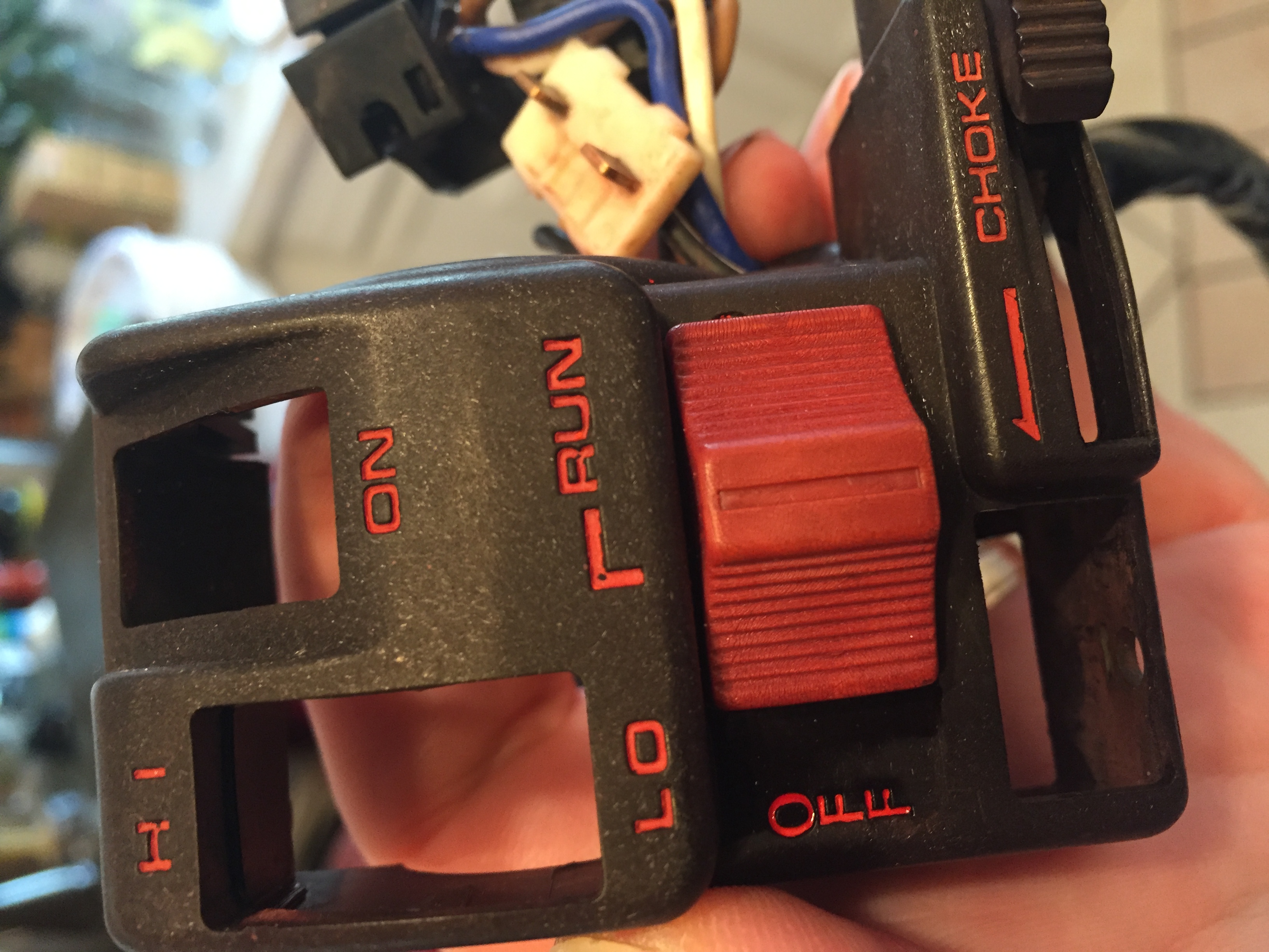

    Hey Everyone, just wanted to post the results of my Switch Dyeing project. I had scoured the internet and found a few references to this but never any pictures of the results. Below are my results. not bad at all I think.

    Holy shyte that looks great!
    Did you wipe it on and of or did you soak the button for awhile in the dye?

    just like you were dying fabric, boiled water on the stove, added the dye and stirred to disolve, took the pot off the heat and put the switch in there for about an hour total. it looked good at 1/2 an hour but I left it in longer. I had tried to get the switch completely off. but that didn't work out,

    the Dye package didn't specify the amount of water to use, just said enought to cover the fabric, so I probably had 2-3 cups of water and the packet of dye, I poured the Dye into a bottle after I was done to use on another switch.

    I have found the liquid RIT dye seems to take even better than the powder.
    Nice work, it looks great.
