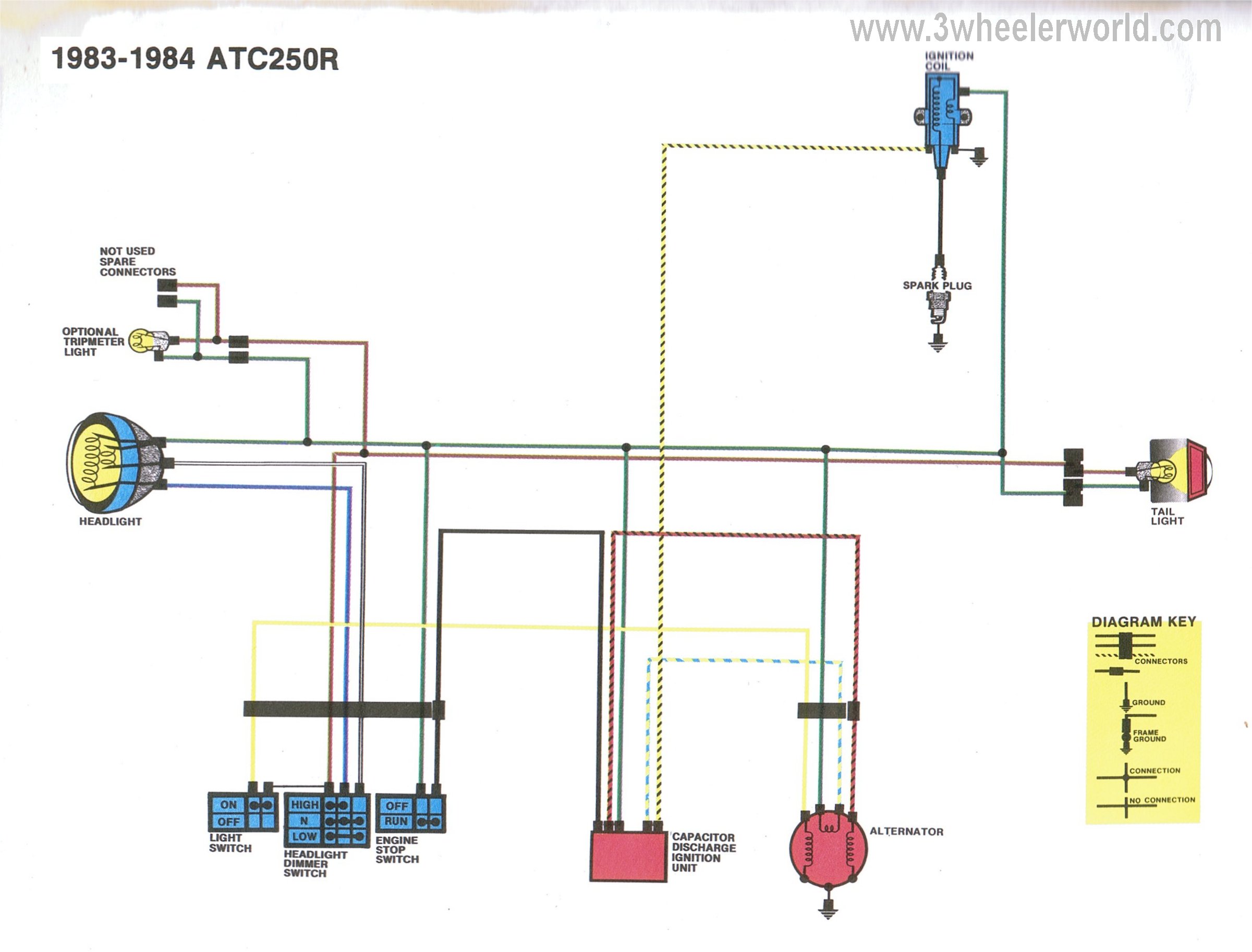

    this is the 250r wiring, I guess I need to know where to tap a two wire regulator into...
    I personally don't know if I need a reg. or not.. I have read the 250r will blow the bulbs with out a regulator... I was hoping some one had done this kind of thing before

    The 2-wire regulator should tap into the yellow wire coming off the stator before it goes into the headlight switch.
    The 3rd gen Rs will blow bulbs without a regulator. They make real power for lights.
    I'll buy you 3 bulbs if a 2nd gen R blows any bulbs - as long as all 3 (2x35W 350X headlights + stock taillight) are hooked up and working.

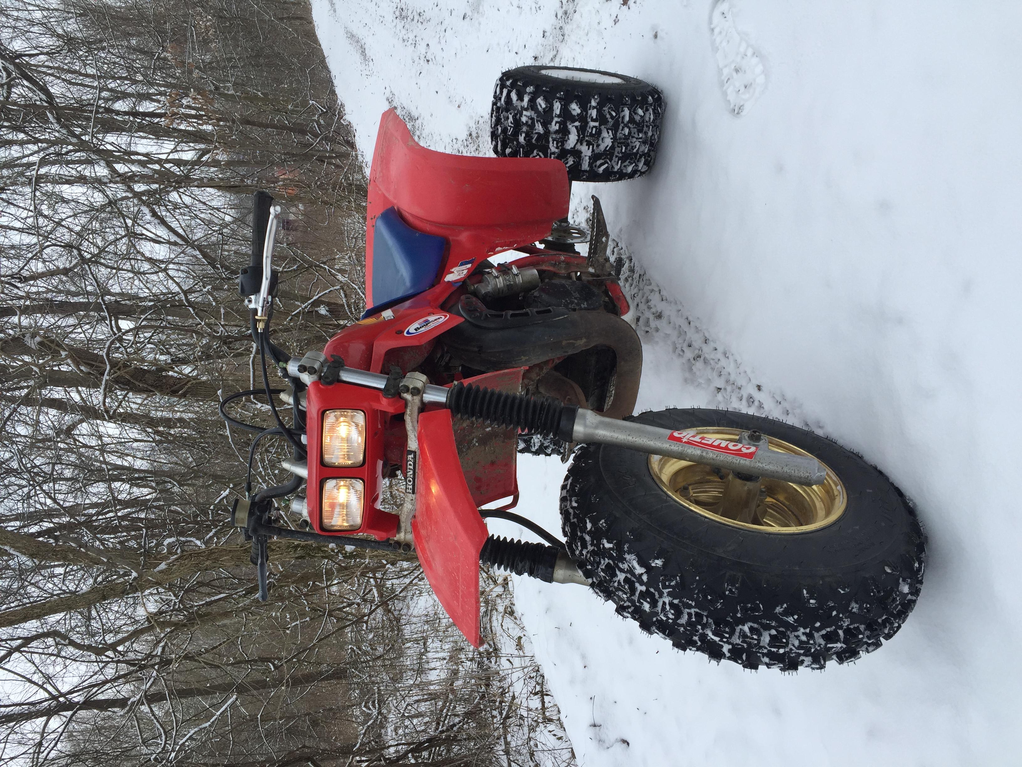

    here it is! kkkkkkkkkkkkk
ID:	227668   Click image for larger version.
ID:	227669   Click image for larger version.
ID:	227670   Click image for larger version.
ID:	227671   Click image for larger version.
    Sep 2015
    So il
    11
    OK, guys
    You were correct! I simply put new ends on the 350x headlight doing no mods to the oem 250r wiring harness.
    so far it works great. I haven't blew a headlight yet. so I guess a regulator isn't needed, not yet anyways.
    the 85-86 250r headlight would look great as well. but we all know parts are getting hard to come by and this 350x headlight was up for grabs.
    The install was easy, id say a "2" and a scale 1-10. as long as you know the basics and have the tools id say anyone could do it.
    I haven't had it on at dark so I'm not sure were there pointed but they have adjusters, so I should be able to point them were the need to be.
    I think it looks great and is a total upgrade over the oem 83-84 headlight assembly.
    I have not a clue, but I think the 81-82 headlight would look goo, also the 200x head light, they both look more sleek compared the 2nd gen R. But I do not know if they will fit!
    You can see in the picture were I modded the 350x headlight so it can plug right into the oem connector, can easily switch back.
    Well if you have any questions just ask, I hope this post helps at least one person out! I'll keep in touch after a few hours of ride time with the light on.
    Thanks for all the help!
