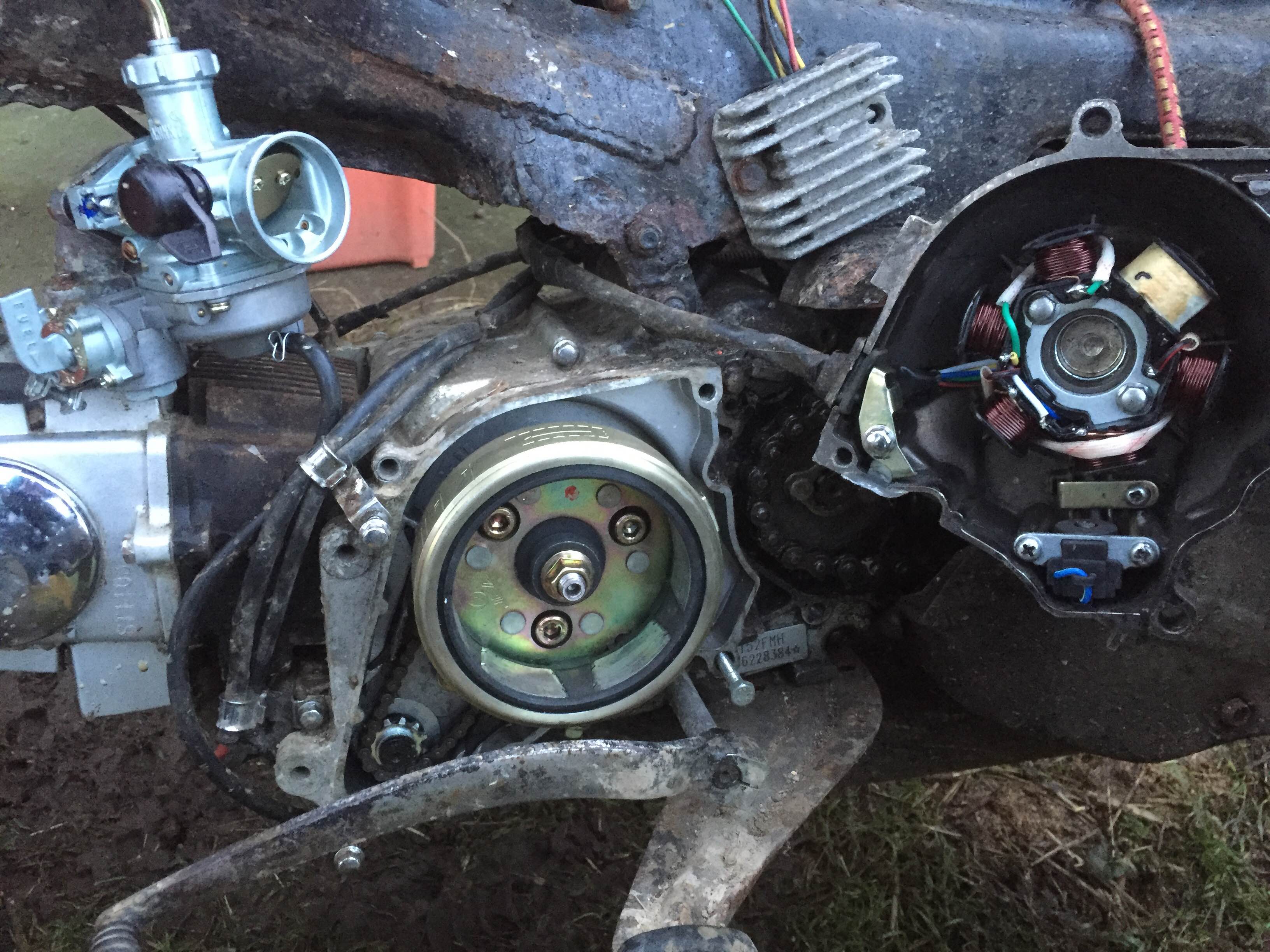

    Hi guys, just new to the forum and need some technical help, definatly think I have come to the right place!
    I have just bought a Honda 1980 (from frame number) ATC with a Pheonix engine in (don't know too much about the engine??) and can't get it to start.
    When I bought it it was up and running but had been sat for 6 months, I had a little test drive and all seemed fine. I then got it home and could only jump start it but would die within 30 seconds and then nothing!
    I took the carb off and the top set snapped so I bought a new carb of eBay (only £20!) Put that on but still nothing. It has a good spark and 130 psi compression. It doesn't even sound like starting! I have tried a squirt of fuel in the spark plug hole but still no! Spark plug is pretty dry when I take it out after trying to start it, but has slight gas residue on it.
    Any help would be absolutely amazing as I am running out of ideas!

    Hi guys. I really really appreciate the help and advice, I honestly do so thank you all very much!
    To confirm, it is a Honda 110 atc 1980. It appears that it may have had a new head put on it but I am not sure, it definitely appears to be a lot newer than the rest of the engine! I live in the UK and found this website:
    http://www.phoenixrebore.co.uk
    It may be that at some point some work was done here, which maybe the reason for the 'Phoenix' logo.
    The guy I bought it off said that it had a dodgy carb and the carb was leaking fuel, so I took it apart and the top set nut snapped. I just presumed that it was the original Honda 110 carb so I bought a replacement Honda 110 1980 carb from Ebay. I changed the oil as the oil stunk of gas.
    Hope this gives a bit more info!

    You have a different motor, it is not stock. Looks like someone tried to make it work. The motor might be Chinese but I'm not quite sure, Honda's were made in Japan. What color is the spark? You want a crisp blue spark. Yellow is weak which could be a weak coil, corroded connections, bare wires etc.. I would look at all wiring, make sure it has good spark, getting fuel, and make sure timing is correct.

    Is the new carb bolted on nice and tight? In the photos it looks loose/air gap on the front side of the engine. The side cover is engraved with the brand, so I guess most likely it is a china made engine with that name (never heard of them). I can see the wiring was worked with quite a lot, but it isn't the factory engine so kind of expected.
    Did some quick searching and found a very similar engine which gives some specs. Based on the search I did it most likely is a 110cc, but some 125cc had the same engine code.
    http://www.cncyclesparts.com/productDetail_437.html
    I can see it is kick start and manual clutch. The china engine does not have a mechanical pulse generator spark advancer like the OEM engine had, so the advancement has to be done by the CDI, but I think it has the correct china cdi of what I can see.
    On the left side of the engine is two removable caps for checking the timing. That is how to setup the crank for top dead center, but Not sure how you check the cam timing on those engines.
