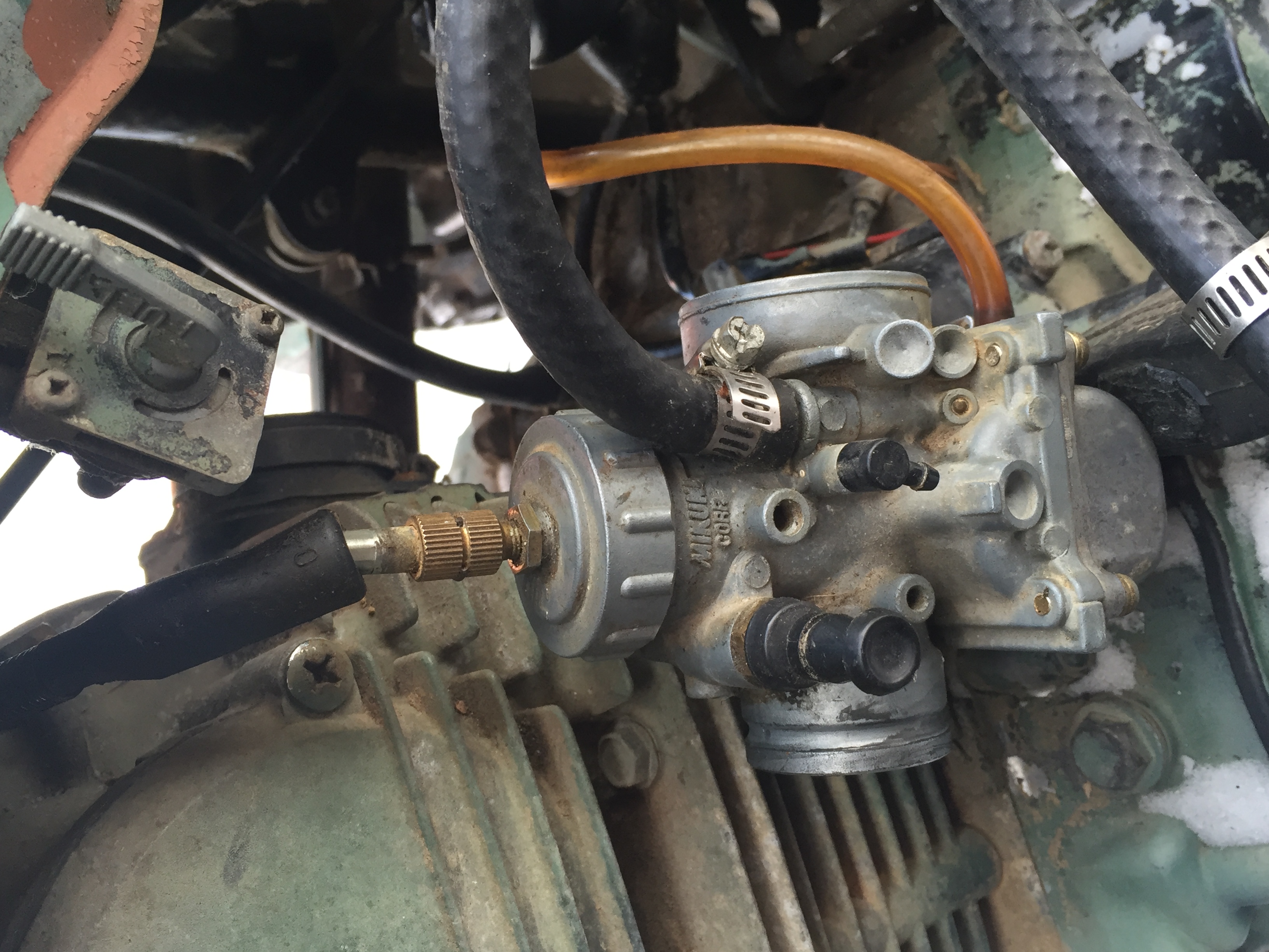

    So I got good deal on this KLT160 and have since found out that its rare and hard to find parts for... I only paid 75$ so I am ok with spending a few bucks to get it going. I am wondering what site you guys suggest for a carb rebuild kit ? The carb is a VM22SS Its gunked up badly and the seals are all dryed out. I also need an air box and I noticed it doesn't have a choke but it has a small round pull knob on the carb that opens and closes a small port, is that the choke ? I only have a yamaha 125 and Im not to familiar with the different designs, the yama has a choke cable like a mower, anyway Thanks!

    Do you think the Jets would be the same? Or maybe I could swap in my jets I guess if I had to. I'm also trying to figure out where the choke used to be on this,it has a little pull knob but it's not like any choke I've seen.

    A pic would help for sure.
    I'll get a few pics here in a bit

    Well thats not the original carburetor. If it were me I would buy a new carb. You might be able to get that one working on that klt but I have always found it easier to start from a baseline with stock parts.

    Quote Originally Posted by Trike_crazy View Post
    Ah ha! Thanks man I've been wondering why I can't find and pictures that match the carb I have

    that looks almost like a 220 bayou carb.
