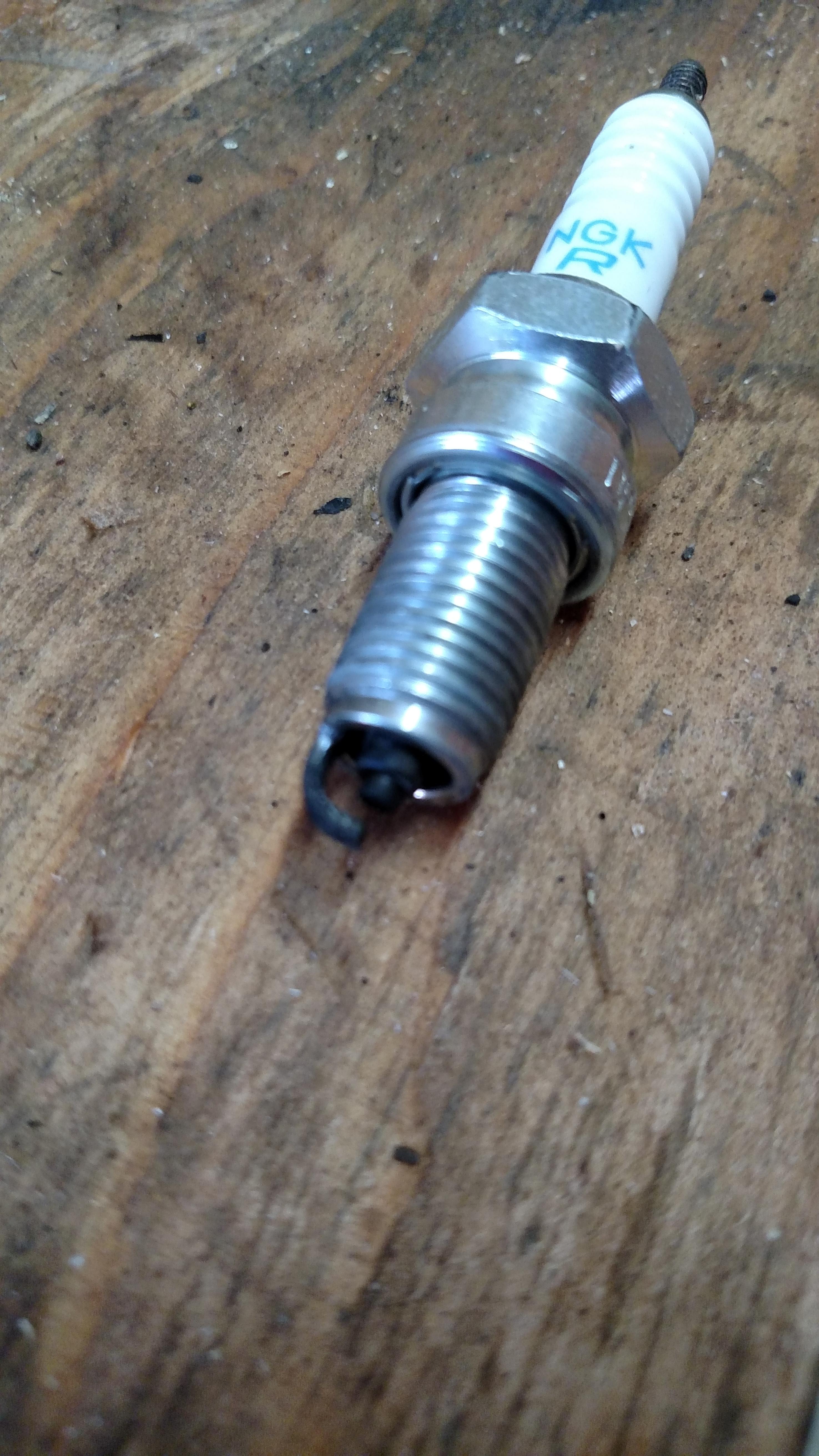

    Here's a photo of the plug
    Slidell, LA
    4,738
    Your plug indicates a Rich condition. What size pilot and main jet are you running?

    110 for the main jet. Not sure about pilot. Whatever came in the repair kit is what im useing
