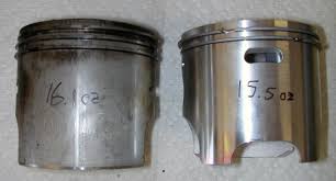

    Remove 1.5 mm from the rear of the piston skirt . Use a large round file and file out the center leaving around 15 mm on each side untouched . You could actually put holes in the rear of the piston but I would try this minimum mod first to see if you get the level of power you want . You can always remove more later if you want but it's kinda hard to put it back.
    Modify bottom of piston like the one on the right but don't remove as much material . The left is actually a stock Kawasaki 350 Big Horn rotary valve engine piston and the right is a forged Yamaha one Harry Klemm modified the skirt on for higher perf.
