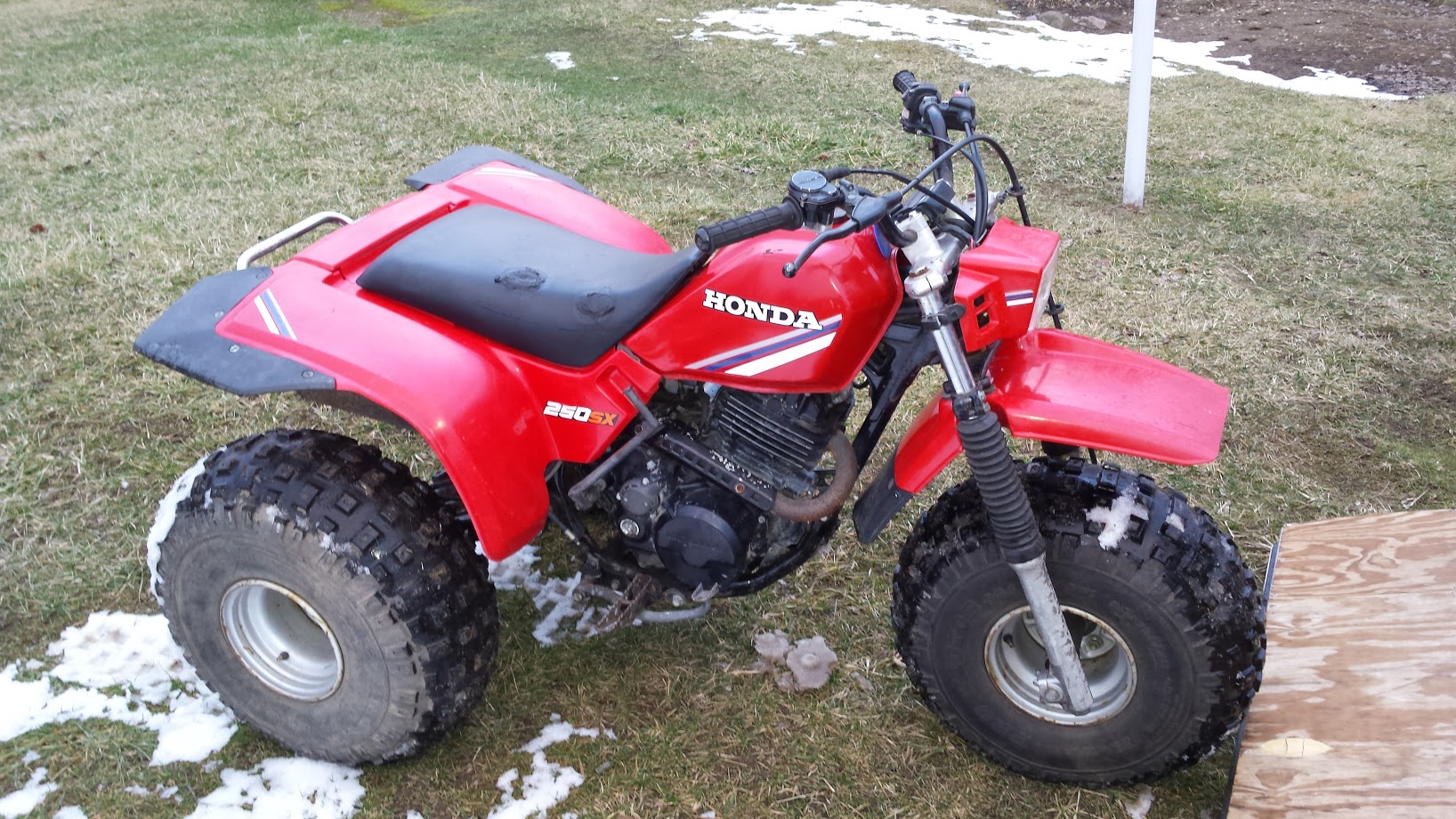

    Hello all. I have been an atc fan for a long time. I may have been a member on the old site about 15 years ago when I had a 200x but that has been long gone for a while now. It is nice to see how much this site has grown. After a little bit of wheeling and dealing I traded some old mini bikes for the 85 250sx you see below. Seems to be in pretty good condition with exception of the dry rotted tires and the non existent air filter. To remedy the problems I picked up a uni air filter on my lunch and also located a front tire and a set of rear tires locally on craigslist (picking them up tonight). The front is a 23x8x10 so I ordered the correct front rim and it should be here next week. So far with the tires, rim+shipping, and filter I am at $134 which is not too bad as my funds are limited at the moment. I am planning on making it a light mud/trail trike. I have always been a fan of the 250sx and it was nice to take a spin on it last night. Hopefully I will have some after photos once I get the new rubber installed. I am also hoping not to have too many issues with the front axle as I hear they can seize up?
    Thanks for looking,
    Bryan

    Nice find! Looks like it was stored inside.
    Feb 2013
    Senoia, Ga
    635
    I'm not sure what the bikes looked like that you traded, but that's a clean SX, and I'm thinking you did pretty good on the deal. Congrats.

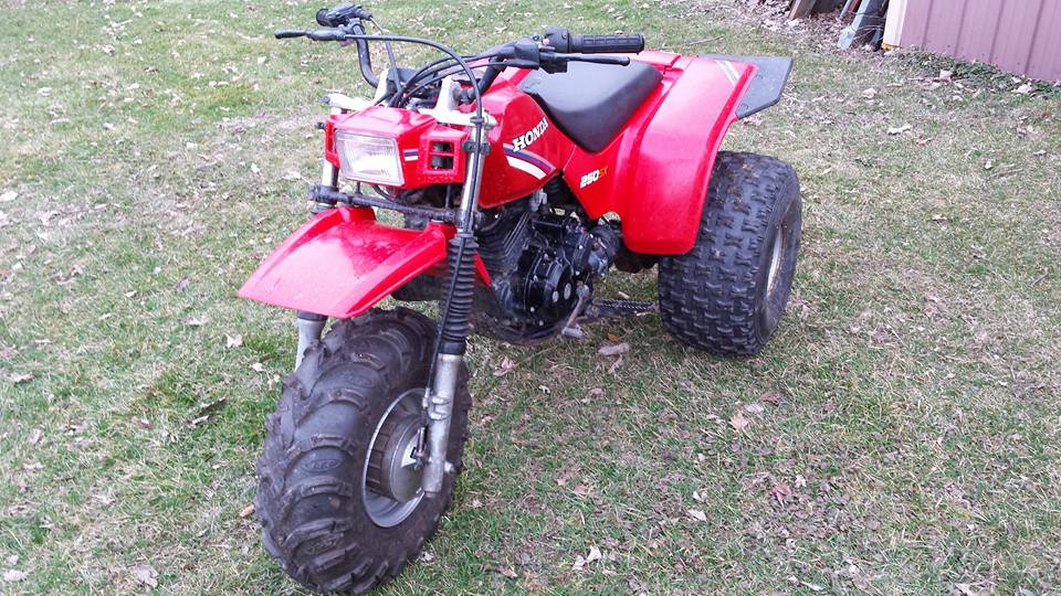

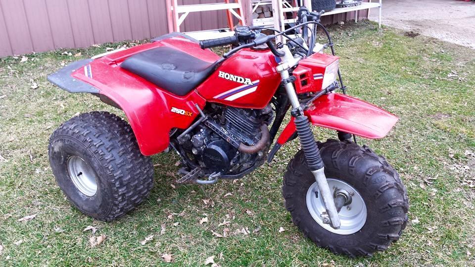

    I did the tires and new front rim last weekend. The axle came out with no issues and the swap was simple. The front brake pad did come off one of the shoes however. I have a package waiting for me. It is either new shoes or the carb kit I ordered.
    The new issue that I am now having is that it will run for a while and then just cut out and stop and I have to sit there for a few before I can get it started back up. I thought I was losing spark but when it happens I pulled the plug wire and it still gives me a pretty good shock. After I sit for awhile it starts back up like nothing has happened. I am now leaning towards it not getting fuel (hence the carb kit). I think I also need to check the petcock to make sure there are no issues with it as well. Has anyone here experienced anything similar? When I put it away Saturday it happened again to the point that my battery died before she would fired back up. I am hoping it will be an easy fix as I am not one for projects. I have taken too many things apart and never put them back together. I will have to find the carb rebuild thread. I think I saw one not too long ago.
    Anyway here are updated pics, I think it looks much better and I prefer this set up as far as handling goes.

    With regard to your stalling issue: I agree it seems to be fuel related. The petcock on that machine has a small bowl with a screen. Unscrew the bowl and check for crud. Of course, make sure you have good clean gas in there. Other than that, a carb disassembly is probably needed. The key is to not just pull it apart and throw the new parts in. You really need to clean all the passageways and make sure all the openings that need to open are clear. Compressed air and carb cleaner are the minimum needed.

    I just had the same exact issue with one of my SX's. I initially thought it was a carb issue also, but since the carb on it was a fresh rebuild courtesy of Jim (flyingw) if was able to rule that out. I soon found that it was my CDI, and confirmed that by pulling a known good one from my other SX. I was able to find a used one, here on the forum, and once replaced, ran like a champ again.

    I will check the bowl/screen. Even if that is the culprit I still want to run through the carb as it has a bit of a hesitation at certain rpms. I am not the best with carbs but my buddy can give me a hand if needed and he also has a compressor and that is currently where I am storing it (he also butts up to a gravel pit ).
    I would rather not put holes in my plastics. Maybe I will settle for a six pack rack down the road, or fab up something small.
    Quote Originally Posted by UPNATM View Post
    That was my initial thought as well but when it happens I pull the plug wire right away and always receive shocks. Is there a way to test it without having a spare on hand? Also with a quick ebay search I see that there are new one listed for under $35 but they state that they are only compatible with 86-87 model years. Is the cdi for the 85 different?

    Could it be as simple as the on/off gas cap vent being clogged? After you stall it try opening the the cap to allow air in and see if it starts.
