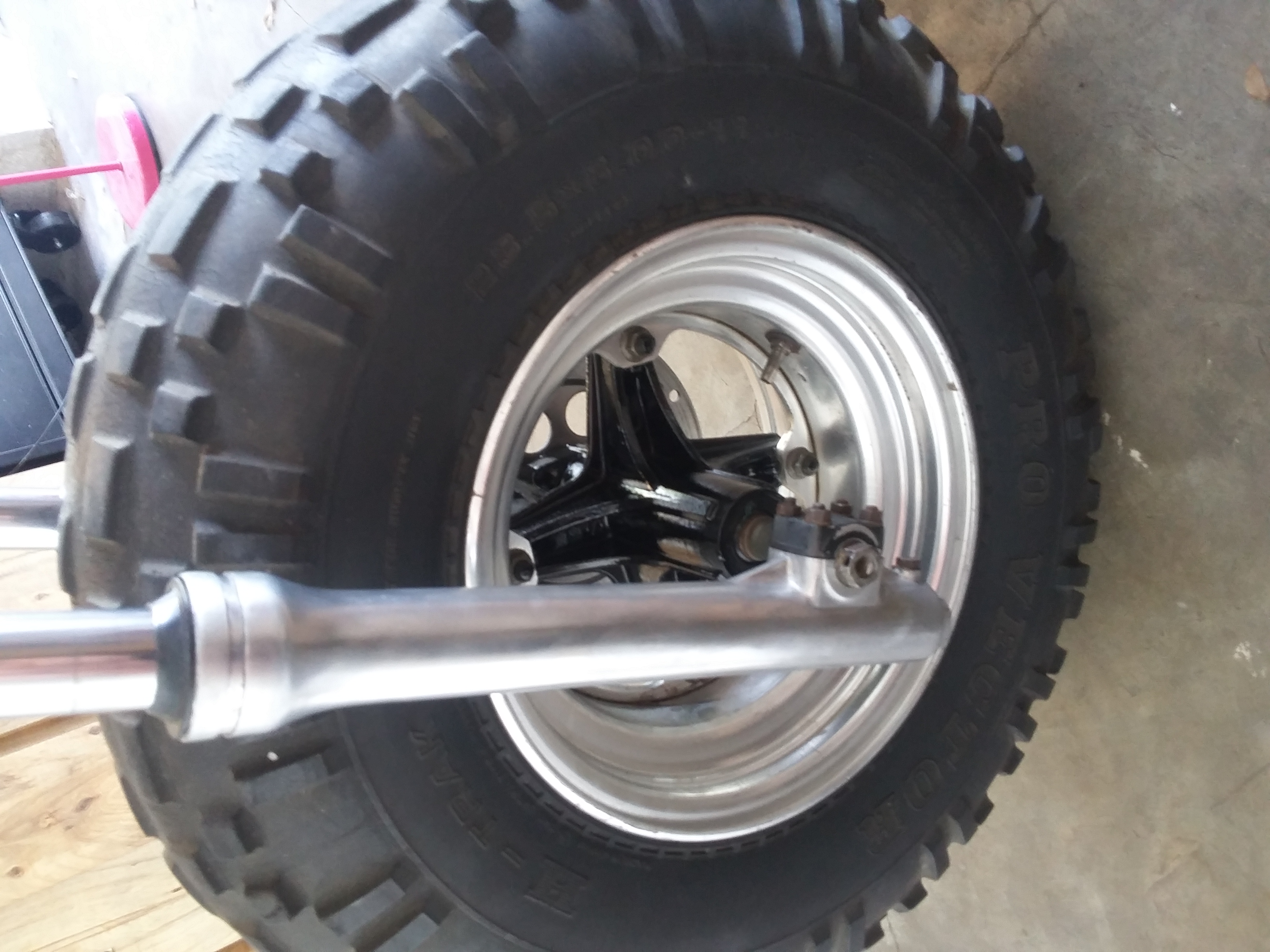

    Swingarm done. Ive put new bearings and seals, 100% in the entire bike so far. Even the ones that were still good, got replaced with new All Balls, bearings and seals. Swingarm, rear axle carrier, steering stem bearings, front axle bearings and seals. Click image for larger version.
ID:	228973Click image for larger version.

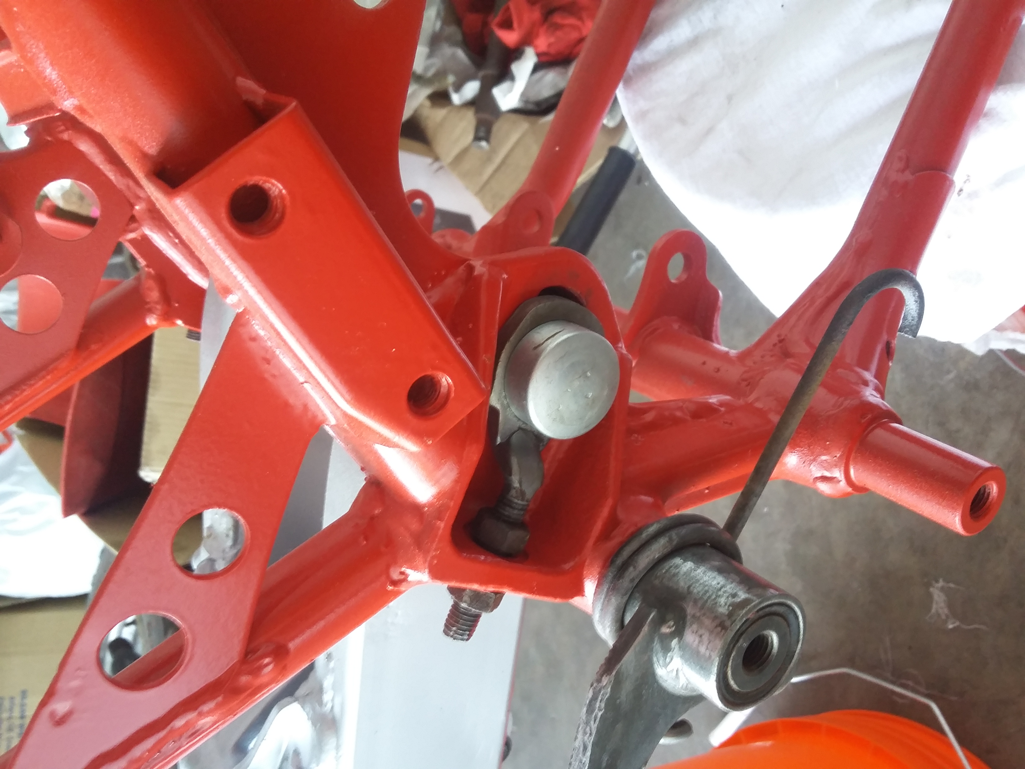

    Rear shock, swingarm before and after. I had to cut the swingarm bolt. I marred up the threads a little getting it out(first time doing it) gotta learn from my mistakes. So i got it out just enough to cut it and get the swingarm off. Then bought a nice slightly polished bolt for $40 on ebayClick image for larger version.
ID:	228976Click image for larger version.
ID:	228977Click image for larger version.
ID:	228978. Yes 40 for a bolt!!!!

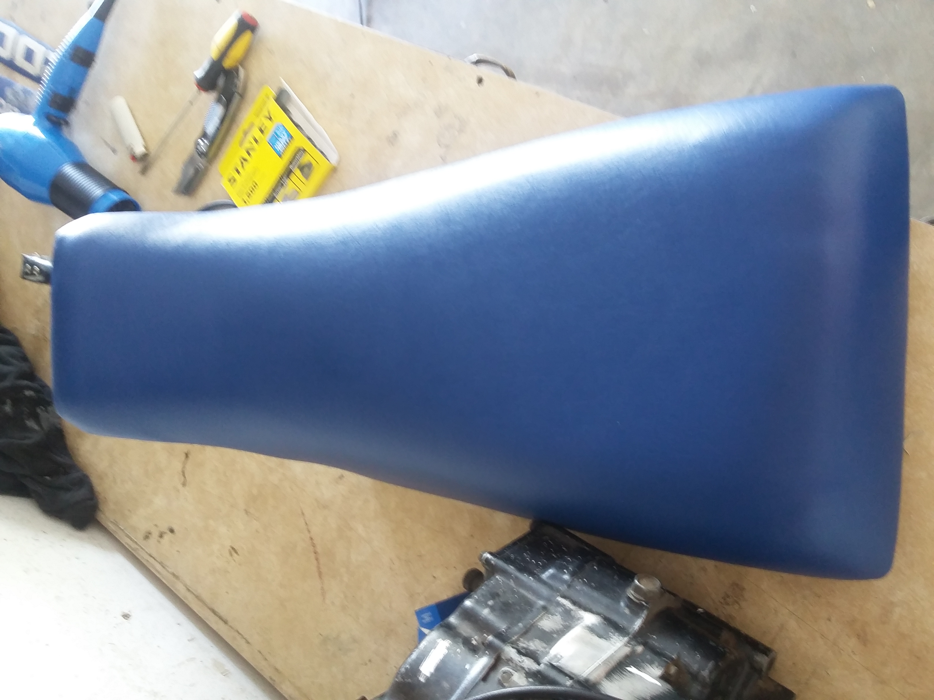

    Seat re-cover results. Marine grade vinyl. Still need to do the stenciling. Came out pretty good IMOClick image for larger version.
ID:	229104Click image for larger version.
