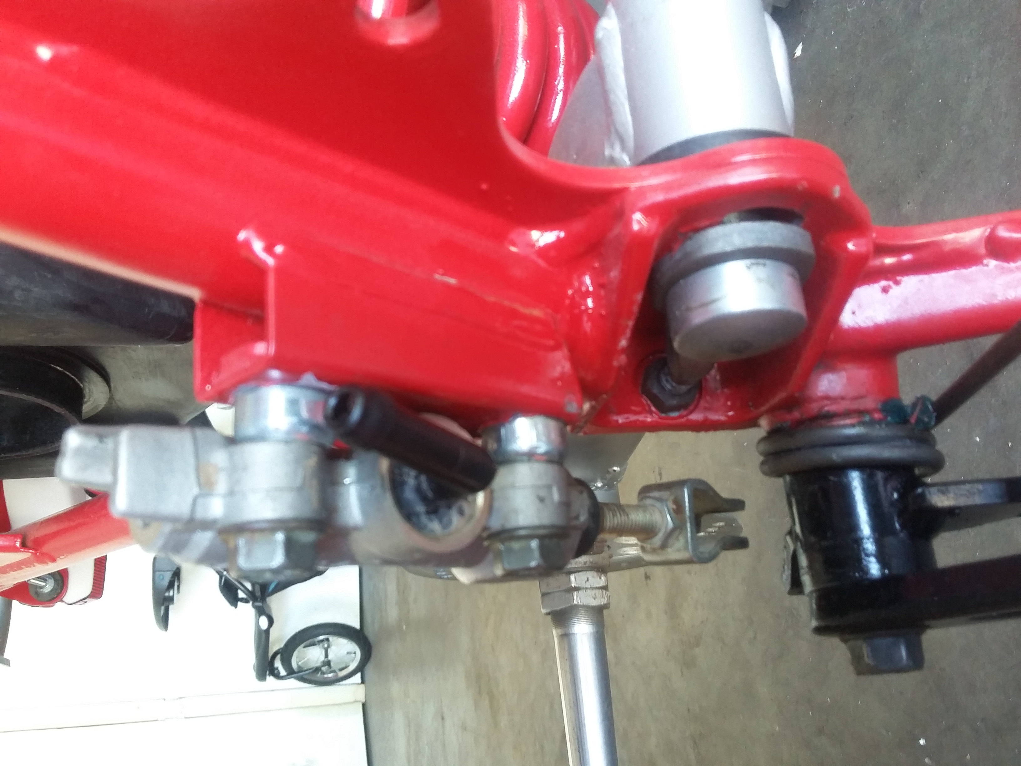

    Got the CR rear master cylinder mod done. Well, mounted. I used a thread on 3WW as reference. Drilled out the CR master bolts holes with a 5/16 bit to accomodate the stock 200x bolts. I only made my spacers .300 instead of .375. That allowed me to use the stock bolts in that spot rather than needing longer ones which i didnt have, i had some too long, or too short. So i gave it JUST enough room with the .30 spacers to re use the stock bolts. The master is off of a 2002 Cr 80 i believe. Cost like $18 for a nice working part. Heres a few pics.
