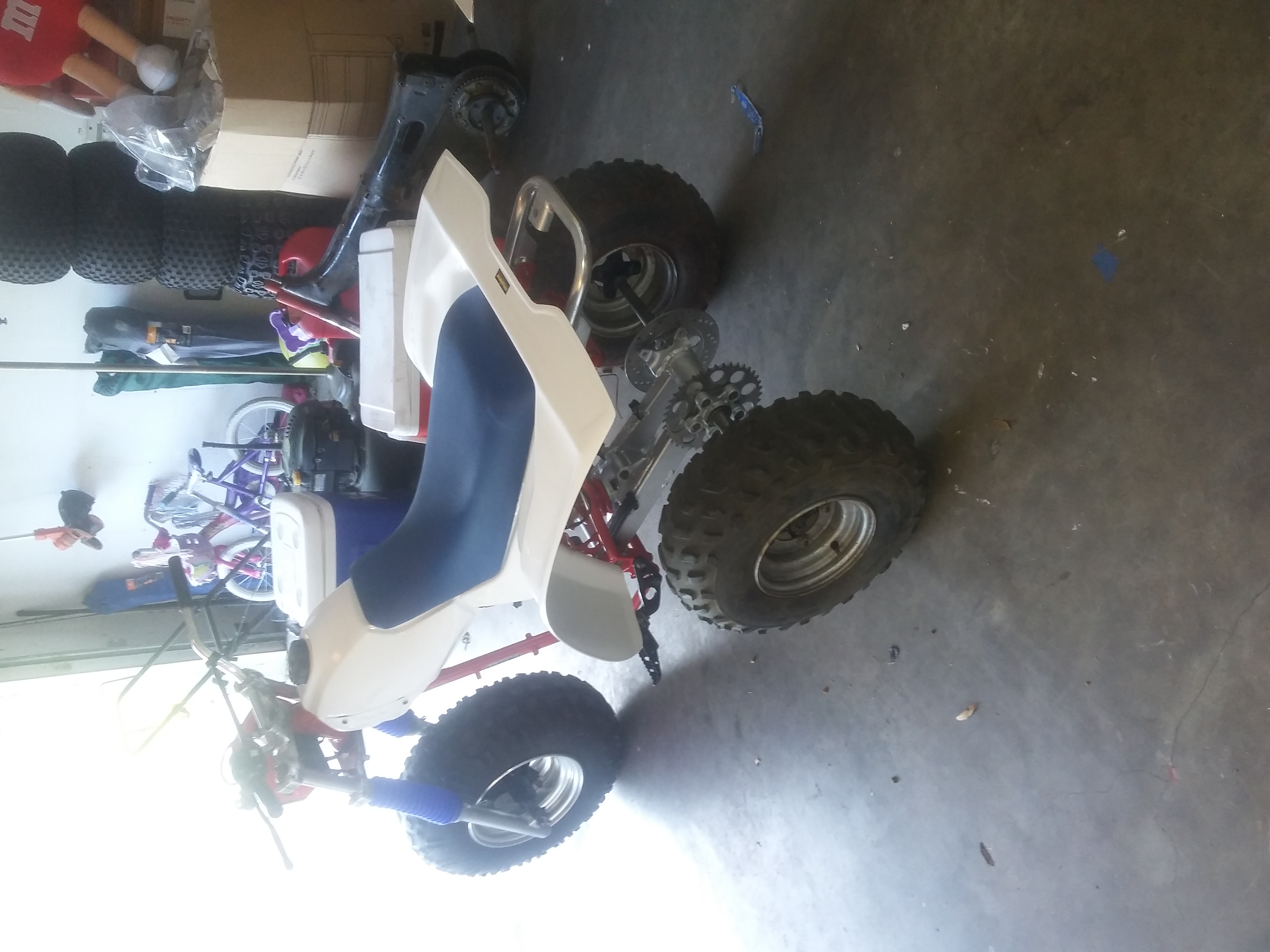

    My white Maier rear fenders!!!!!!! Yes!!!!. Found this set on amazon for $185 with free shipping. Cant beat that!

    You will want to take your factory seat holder and cut it up, then drill a 1/4" hole thru it, go to lowes and add some rubber groomets and nuts so its rubber mounted. The Maier fenders do not have the tap that the seat holder needs to fit in and if you do not use it they will just flop all over the place.
    see attached photos. I do this on all my 200x fenders.
    I actually just got done reading that post those pics came from last night.! And yes i will be doing the same thing.
