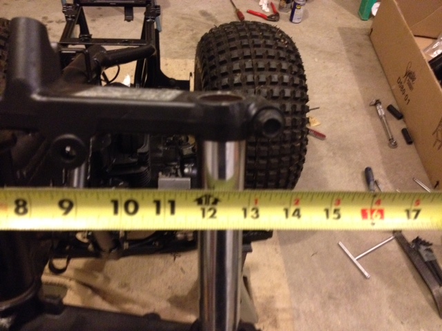

    Thanks for the pics of the hub. That's the same one I have. Would you mind giving me a measurement of the front forks? I am showing 11 3/4 from inside to inside if I measure from the top closest to the triple clamps. Ive attached a pic.

    I have a feeling you have a set of triples off of a dx, or chain driven 200. They will bolt right up on the frame, on a side note I actually prefer the 22" tires to the 25 as the turn better for me, but if you are going to do 22, do 22 all the way around as it will sit high in the rear otherwise. I used to know the difference in widths between the two styles of triples, but I cant remember anymore. after looking at you pick with the tape measure I am almost certain you have the narrower triples, which means you will have to use the 22" tires and rim, but there is a chance you can tube the 25" front tire and in doing that it will force the center of the tire to go bigger and narrow it to be able to use it.

    Yeah that's your problem. You have the triples from a 225 or chain 200. The 200e is 13.5 inside to inside.

    Thanks everyone. I'm going to Ebay right now to see if I can order the right triple clamps. Wish me luck.
    glendive, montana
    1,822
    if you do get other triples you will need different spacers as well as they are longer.
