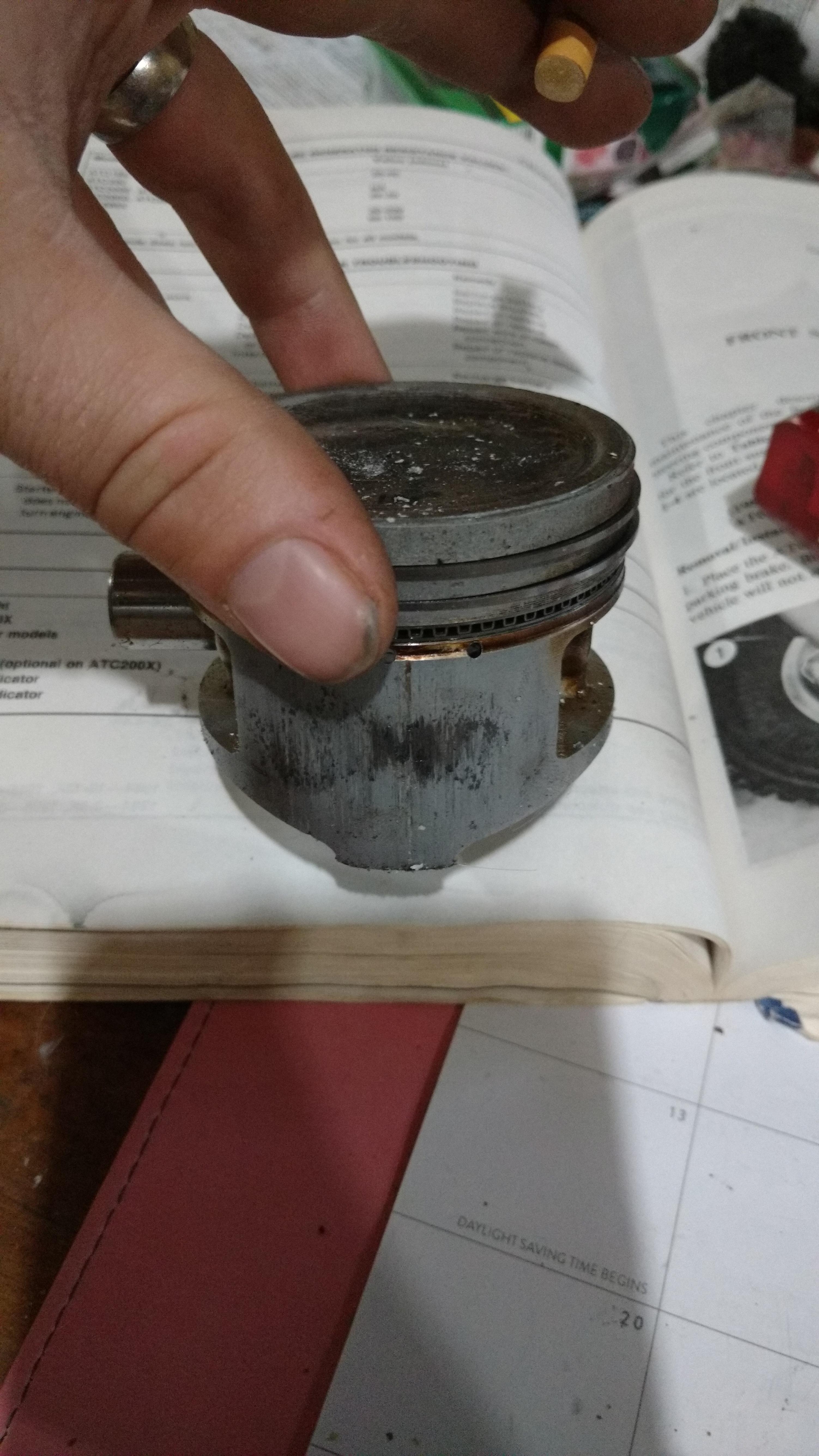

    Back story: my old trike was smoking bad, so I pulled it apart to rebuild it. Easy as pie. Found it was obviously ran dry by previous owner at some point as the piston was gouged pitted and scuffed. Figured " hey if I'm doing an overhaul I may as well get some oomph" and opted for a wiseco 10.25:1 compression forged piston set. Went well after honing it slightly (it was still perfectly 65mm and no damage strangely) assembled as usual.
    Problem: I neglected to realize how hard the sucker is to pull start. It goes half a turn and stops dead and sucks back in. (It will spin perfectly fine without plug or pulled slowly, so no interference issues I checked often) and with the decompression lever used it won't start. I get one good rotation and that's it. So I tried bump starting it. It would roll roll roll "putt" roll roll "putt" as if it's catching but won't keep going. Good fat blue spark. New fuel line, petcock, refinished tank. Took carb apart and did mild cleaning, blew out jets, set mixture sxrew to 2.25 turns out. Same thing. Plug gets wet, beleive me it has compression now, so that leaves timing right? My cam sprocket mark just comes shy on the right of the head mark. It's like not even half a tooth off. Checked multiple times to see if it skipped. Pulse gen is timed at the F line via flywheel. This again circles me back to fuel. I dried it out emptied the carb, heated up the plug while I was smoking with my lighter put a little fuel down the hole and put it back in and when I cranked it I nearly kissed the seat. I'm in the military, and when I say it was like holding a rope attached to a car at highway speed I mean it lol. Please help. Thanks in advance.

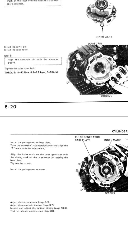

    Not sure if you have a manual, but here are screenshots from my 200x. Timing the motor is the same on either machineClick image for larger version.
ID:	229128Click image for larger version.

    Quote Originally Posted by McQuade View Post
    That's actually exactly what I did, set the cam, on T then nudged it over to F. But since then the engines been rotated over and over. No change.
    I suspect this is where your problem is. If you just nudged it over to the F mark, its trying to fire at the same moment the intake valve is open. The purpose of turning the crankshaft counter clockwise until it comes all the way around and back to the F mark when setting the spark/ignition timing is so that it fires on the NEXT stroke. I think its trying to fire at the same timeits pulling in the fuel from the intake. Start over and do it the way the manual explains it EXACTLY. And i think you will get it to fire. The timing is still off IMO. Im pretty certain this is your problem
