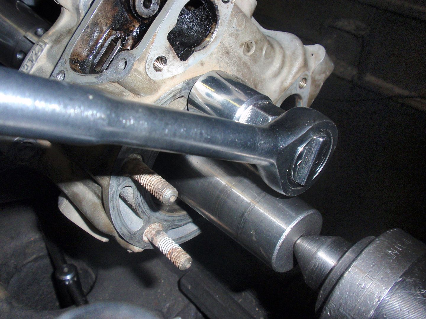

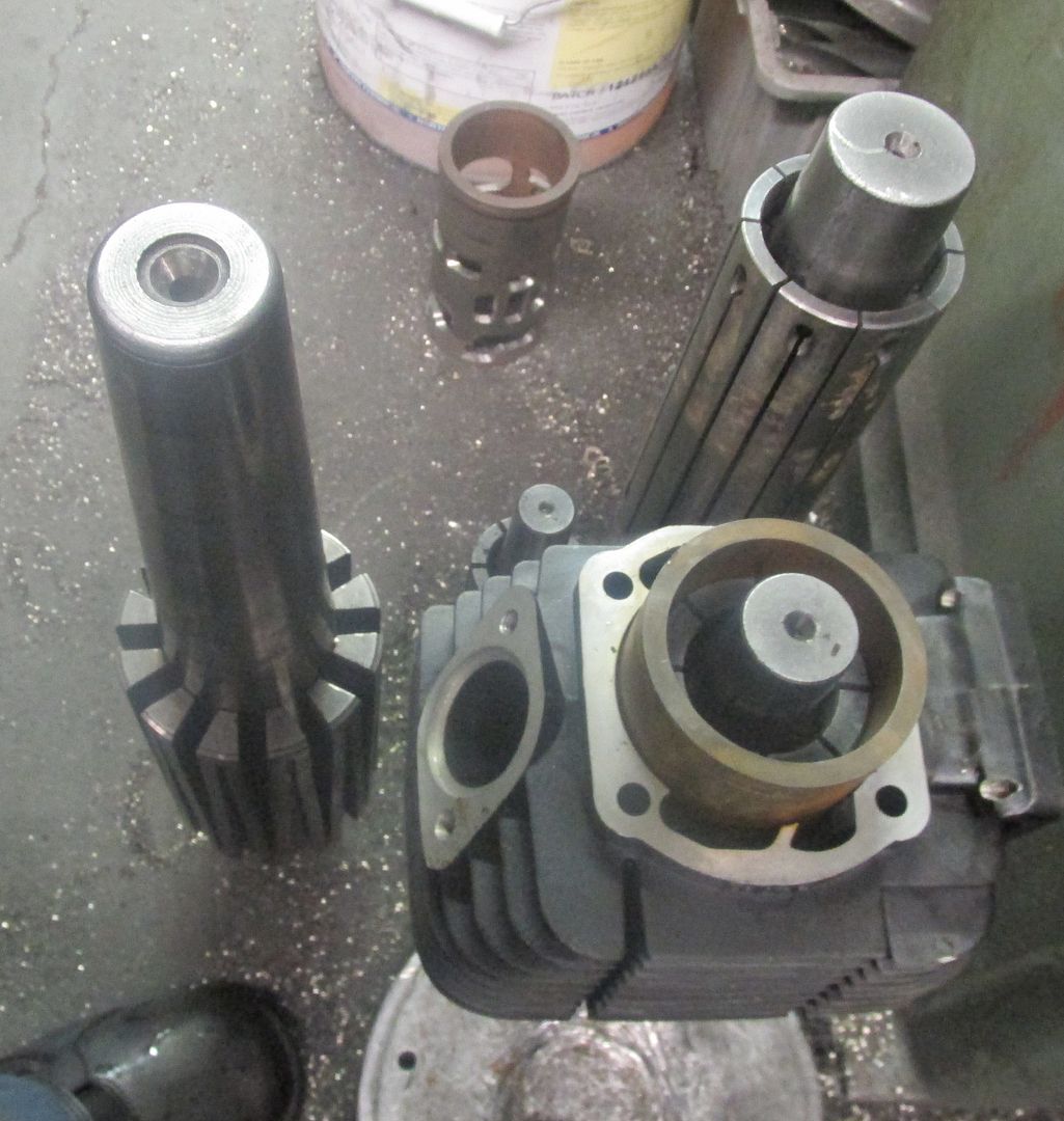

    I’ve been removing studs for other customers for many years now. Even with good stud pulling equipment will fail when the studs snap off with a good twist. Our favorite tool is a set of 4 ea., 6,8,10, & 12mm. Also the cylinder is mounted on a mandrel & chuck mounted in the lathe. This is the only way which I’ve found that the cylinder can be protected from damage

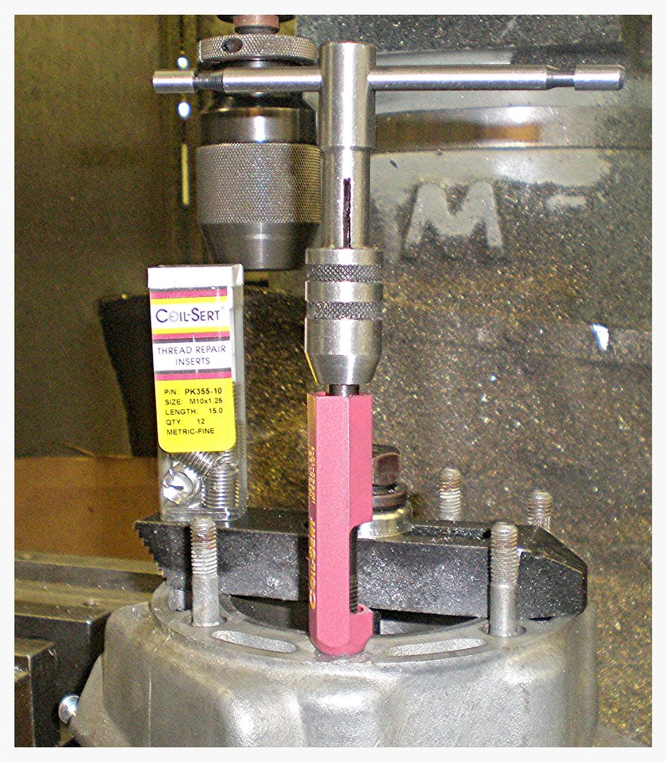

    The tools have 3 fingers which grab the length of the studs, the fingers cam in on the studs & if you’re careful the threads won’t be damaged. When all else fails & the studs snap off; a heli coil is in order.
    This is the Hash type of stud puller; it will grab the stud but destroys the threads in the process.
    Installing Heli Coils

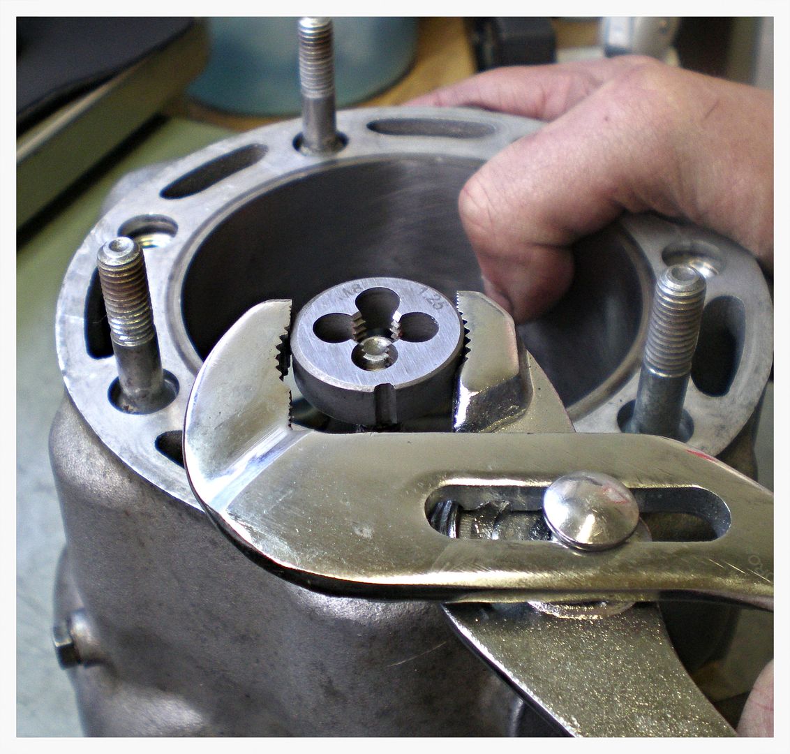

    Chasing threads

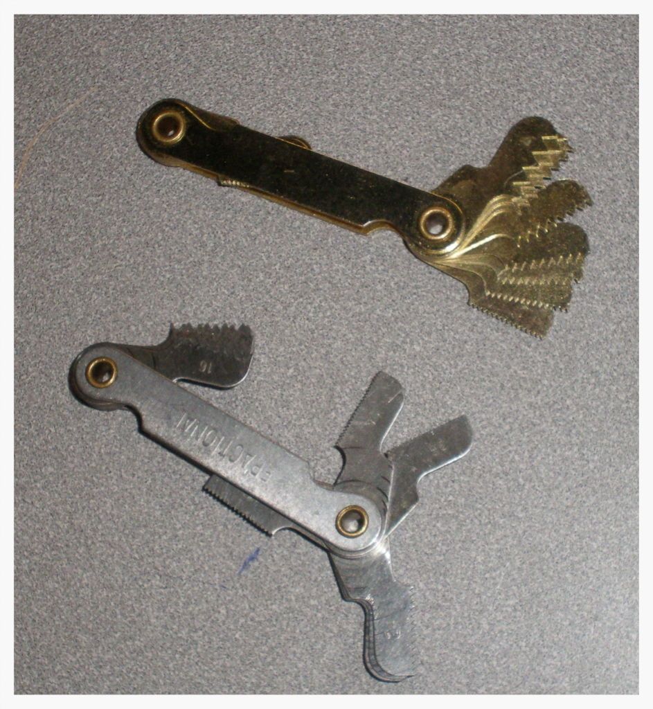

    Checking thread pitch with thread gauge
