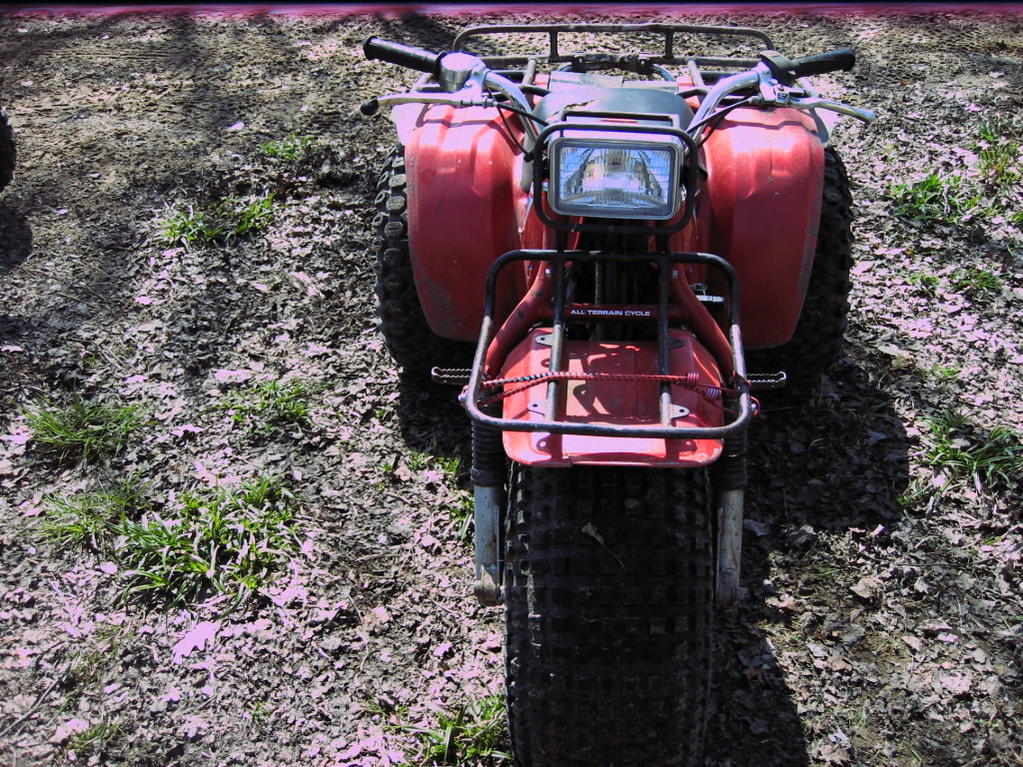

    Here is an older photo of the 200es I have after I replaced the tires. Camera was going bad so not the best photos. You can see how badly worn the front shocks are though by the angle difference of the housing vs tube.

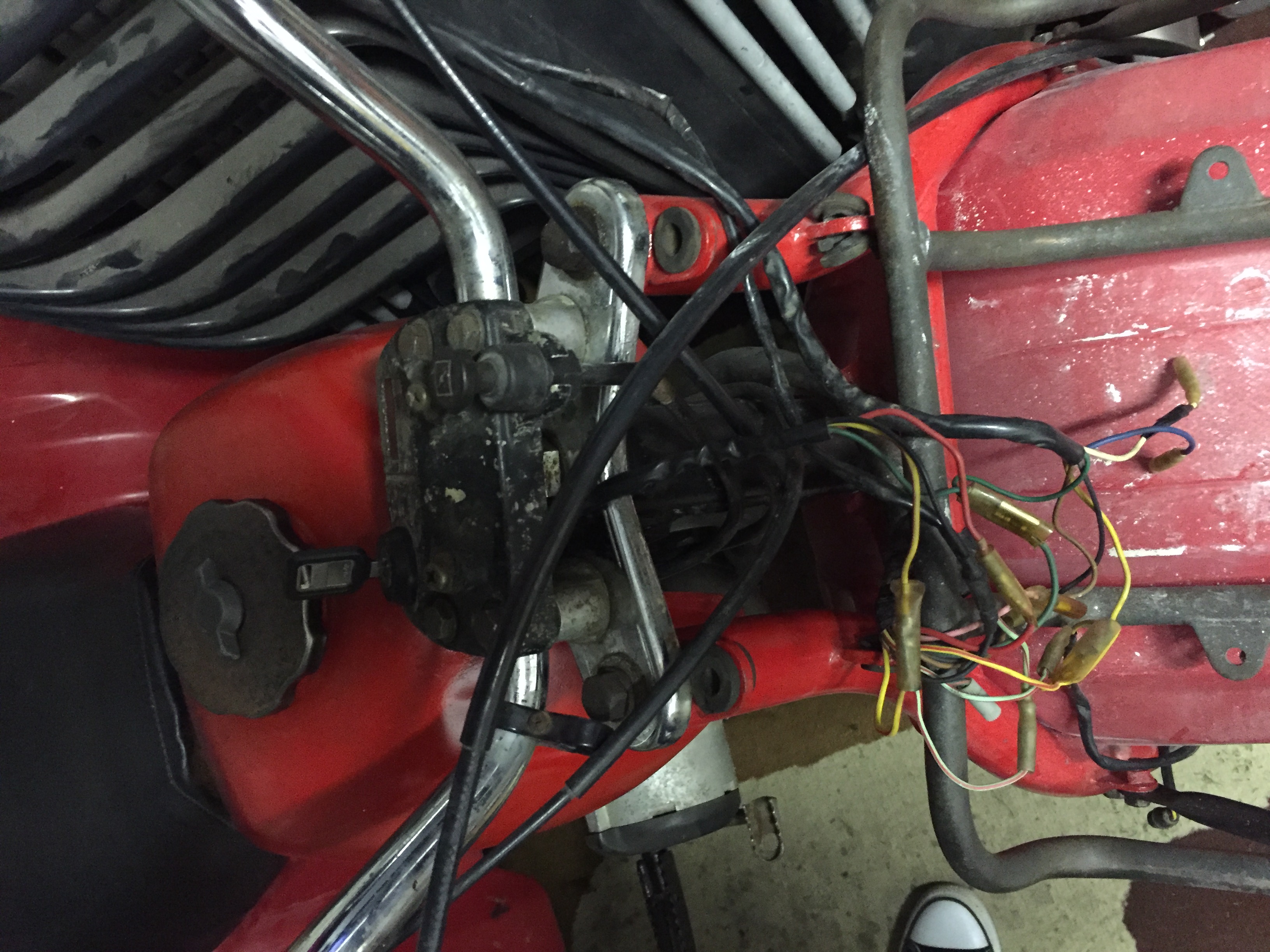

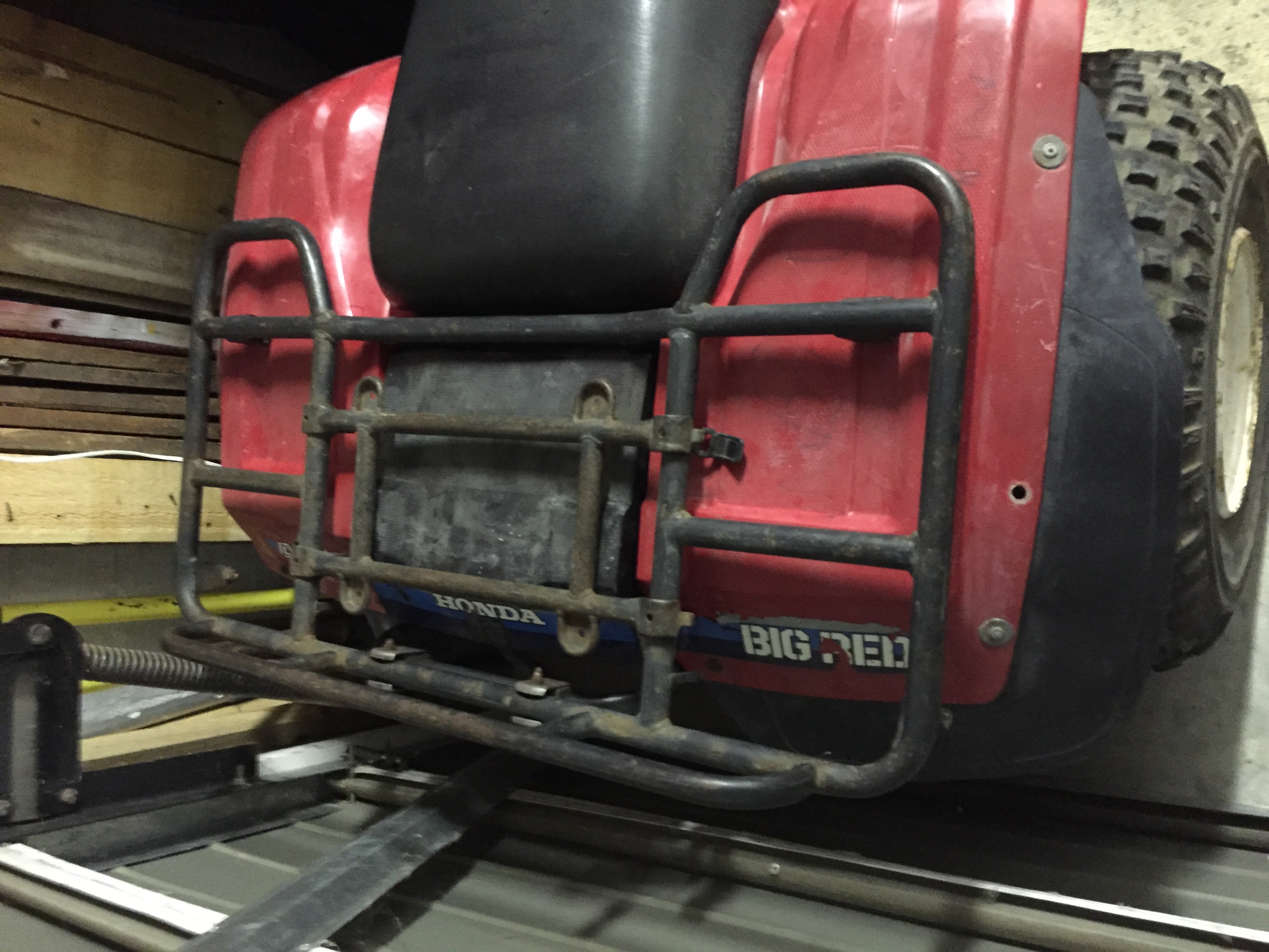

    Here are the pics .... I can't fins a serial no anywhere ...

    Pretty nice clean looking machine. Looks like the tank was repainted and maybe the frame too? Based on memory, I think the frame serial number was a sticker on the goose-neck of the frame. The older machines used to have it stamped right into the frame metal in the same spot.
    Looks like it might have some spare parts unless the airbox, exhaust etc are off the machine.
    The tubing is for the bottom of the air box, and engine crank case vent
    Bracket appears to be for the rear fender/rack (under side of the fender)
    Skid plate goes under the rear end
    The black plastic that says hond is for the handle bars, the rounded off honda part comes out and there is 2 bolt holes that are extremely commonly ripped out, it also has a bit of a clamp effect on the other side, so not too bad if it is bad.
    The plug with the wires is the aux power plug, goes up on the left side of the rack/front fork area
    First bracket (left) looks to be the bracket that goes on a shaft drive machine right on the output shaft, not sure if the chain drive version uses that one.
    2nd and 3rd brackets appear to be front engine mounting brackets
    Vent hose on the skid plate looks like the vent tube for the rear diff on the shaft drive version
    White plastic part is for the battery box to keep the battery from getting beat up
    Wing nut style bolts are for the airbox lid
    Brown wire bullet connector that is cut off would be for the taillight positive, runs from the handle bars back to the tail light, hopefully it isn't from your harness.
    Left of the skid plate, the round rubber part is for the starter solenoid to frame mount.
    I think that covers most of what is there except the extra bolts.
    I looked up the output shaft bracket, and the diagram looks different from that bracket so might be wrong there. #5 in diagram.

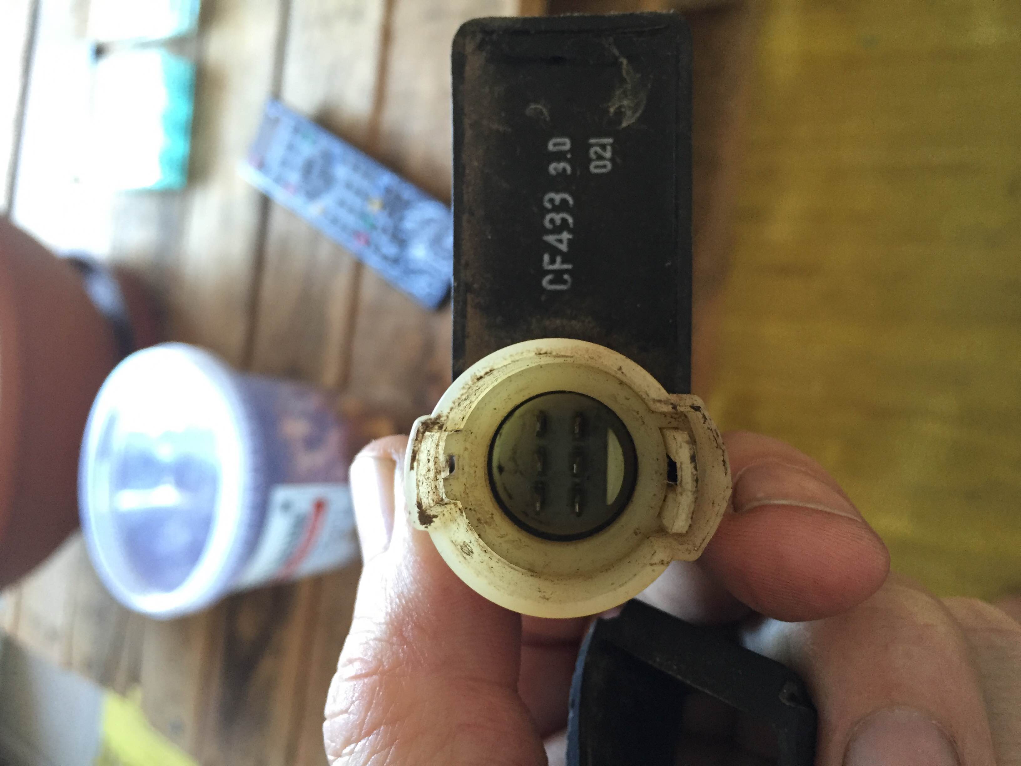

    Stripped the whole trike this weekend, started cleaning every part. Gas tank was badly rusted on the inside and cleared it right up with some pool acid.
    I tested my coil and got some strange readings, bought a generic coil (chinese) fits perfectly but the coil itself is much smaller than the original, I hope this won't make a difference.
    I also tested the CDI according to the manual and could only get readings from 2 of the connectors, so I suspect my CDI is fried, would it be as easy as replacing it with a generic chinese CDI?
    Another strange thing I picked up is that the CDI I have does not look anything like the CDI from the manual and/or replacements I see on eBay ... see pics attached ... it looks like the CDI from the ATC200X, ATC200M ATC200S

    I'm pretty sure the CDI from antoher 200cc honda 3 wheeler would work. The CDI plugs changed around this time, before 84 they were a square 6 pin plug, then ~84-86 they used the round 6 pin like you photoed, and after that to modern machines they have been using the 4+2 pin connector CDIs. Looks like your CDI is the same as the 84 200ES in America
    Here is a good thread on a China based CDI - http://www.3wheelerworld.com/showthr...ent-MythBusted
    I'd suggest removing the pins out of the old CDI, and putting the new style connector on it with the Chinese CDI if you don't mind the possible lower quality (keep a spare on you).
    Here is the 4+2 cdi connector, not sure if you would be able to source one local though. Scroll to the bottom of this page http://cycleterminal.com/
    The other option is to cut and splice the wires, not really a fan of that myself. The round style CDI isn't really common, I have seen a couple listed on US Ebay, but they are $40-50 and claim to be made by the same company as OEM.
    Here is the 200es service manual page for the CDI - https://gyazo.com/ea504677ebe91bb620657ad5f396c643
    Generally most people test all of the coils (pickup, ignition, etc) and if nothing there is found bad and still no spark, then the CDI is blamed, so I'd try the china coil and see if you get any spark at all. Being smaller might mean a little weaker spark, or they used smaller wire, doesn't seem to be a huge factor unless you're into racing and going super high compression etc. A nice bright white/blue spark is what you should have. Dull yellow/orange is too weak. Don't forget to get another spark plug to rule that out as a possible issue too.
    Good luck!
