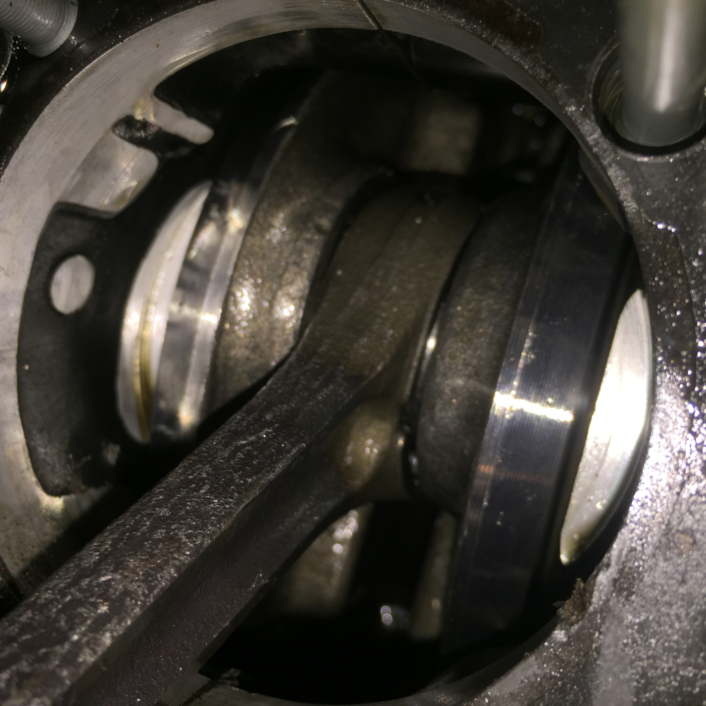

    Do you have shavings in the oil or the oil screen?

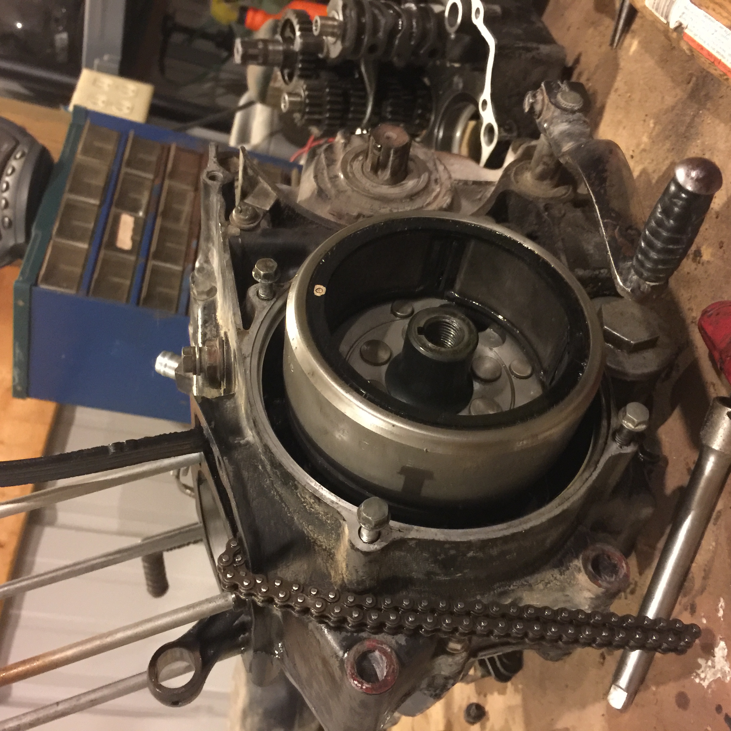

    Ok guys. I pulled the top end. The problem was the rod bearing. It's shot. I've got an extra crank and rod with good bearings that I'm about to put in. Yes there were shavings in the oil, a good amount. I'm stuck at the flywheel though. I don't have a fly wheel puller. This looks a little different than most flywheels I've seen. do I need a special puller, or can I go to town and buy a regular one?
    Here are some pictures of what I found. Timing chain is good. Valves are good, piston is good. Just bad rod bearing.Click image for larger version.

    Aside from the flywheel pulled I posted in your other thread you need to invest 60 bucks into a tusk case splitter.
    Jan 2014
    Massachusetts USA
    782
    I'm 99% positive that a 14mm x 1.5 bolt is all you need to pop the flywheel off that engine. And I know for sure that my 200x case split easily without a separator tool or any prying. You will need the funky spanner nut socket to get the clutch off though. Good news is that socket is cheap and fits tons of other Honda engines. Oscar Mayer has the OEM manual on his website for download, and we're here if you have questions. Now order a gasket set and get that thing split!

    Ok, so I used the front axel to remove the flywheel. So, I'm in the clutch case. But I got stuck at this special tool you need to remove a special nut. It's on the crankshaft on the clutch side. What is this tool called? And could someone show me a picture of the tool needed?

    Go on eBay and search "Honda clutch hub socket spanner tool." That will give you an idea of what it looks like. You can easily make one out of an old socket and a grinder. Use and impact gun to remove. Be careful though I believe that is reverse thread.

    It's regular thread, and fairly tight. Also, the nut has a beveled side, it's directional (and marked) when you reassemble.
