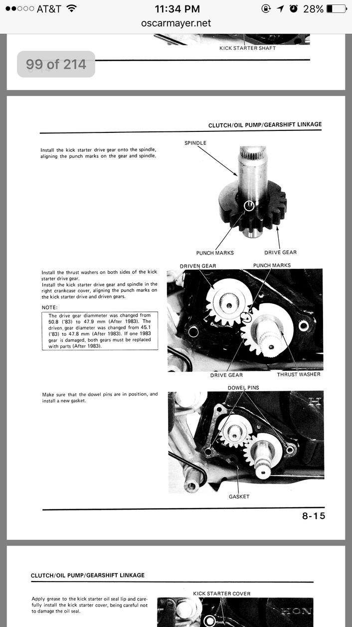

    Nope. I didn't have to take those out. Only thing I really took apart was the gears that are outside of the clutch case. These in the picture. I'm thinking maybe they are at the ends of the teeth so they won't move anymore? Maybe I need to take them out and put them the opposite way? Like maybe they are unable to move because they are touching at the end of the teeth?

    Looks like there's a specific way the gears go in.

    Yes, if you didn't remove the ratchet/return bolt/return spring, then the only thing it could be are the gears/shims are assembled incorrectly. Note the tick marks on the gears. Those must line up. Also, if you do not have the shims in the correct location it can cause a binding effect. I would take the kicker cover off and re-examine the gear alignment and shim/washer placement. Don't forget to use a fresh gasket. I have heard where an old or missing gasket can also cause binding with the gear set.
