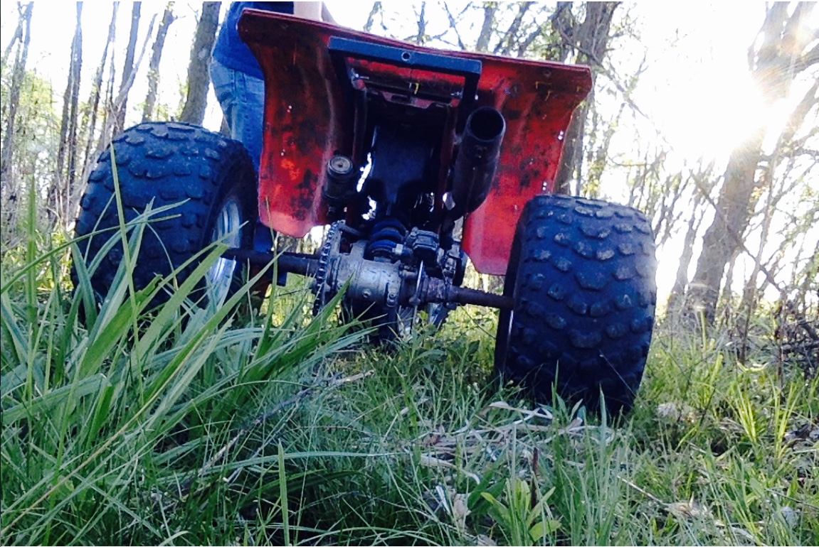

    Hey guys! I have been putting in countless hours on this build, she started life off as a stock 200x. I then swapped to a 350x front end, and a 350x shock, swinger, sprockets, and axle. The motor is a 200x top end with a 185s lower end. But I blew a fork seal last night while I was out ripping in the field, so I am gonna go back to a stock 200x front end, or run an 85-86 250r front end setup for even better suspension!!
    Mods list: 66mm Helm & Son 10.5-1 piston(thanks to Shortline), xr200 intake, xr200 carb, uni filter, and jetted for these mods!

    The 83-84 R suspension is the way to go on a 200x.

    How much fab work went in to putting a 350x swinger on the 200 frame

    What jets are you using with this setup. Mines pretty similar setup except with a wiseco 10.25:1. Ive asked around alot but more opinions are always welcome
