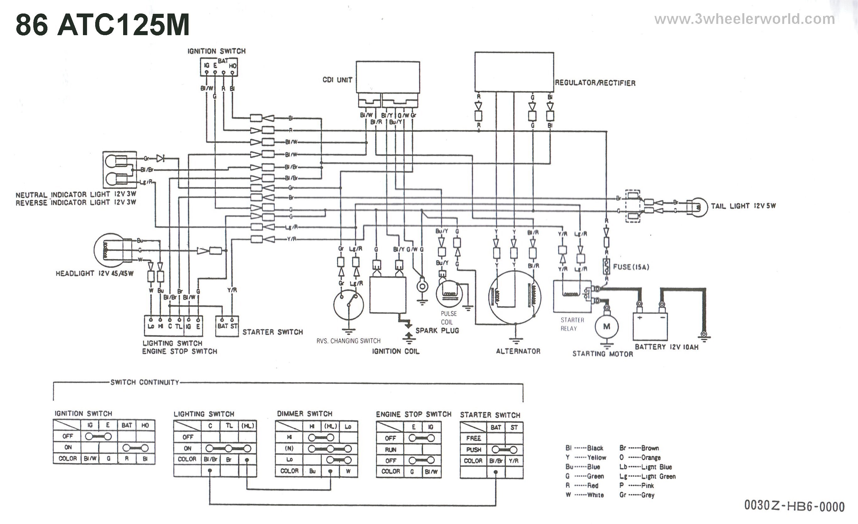

    quick question would not having a regulator rectifier cause my 86 honda atc 125m to stop sparking

    No. It's for charging the battery. Click image for larger version.

    To diag the no spark issue, you'd want to test your ignition coil, alternator/generator, pulse generator, and if all test good, then possible CDI replacement. Everything is tested with a multi meter, specs are in the service manual, if you can't find it post and I'll screen shot the specs.
