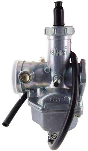

    Does the carb on the 200s have a throttle stop screw like the carb on my 110 does? Look at this picture. That screw in the middle looks like the throttle stop screw. You turn it clockwise to increase the idle and counterclockwise to decrease it. Put it in neutral, start it up, and adjust that screw counter clockwise until it idles lower.
    If that screw doesn't have any effect, then your needle or slide were reinstalled incorrectly.
    If it idles correctly and then lurches in gear, then it's probably your clutch, but the high idle makes combined with the fact that you just worked on the carb makes me think it is either the throttle stop screw or the slide. Turning that screw clockwise is exactly the same as giving it more throttle with your thumb, so if that screw is turned too far in then it makes sense that the bike would lurch forward just as if you were giving it gas.
