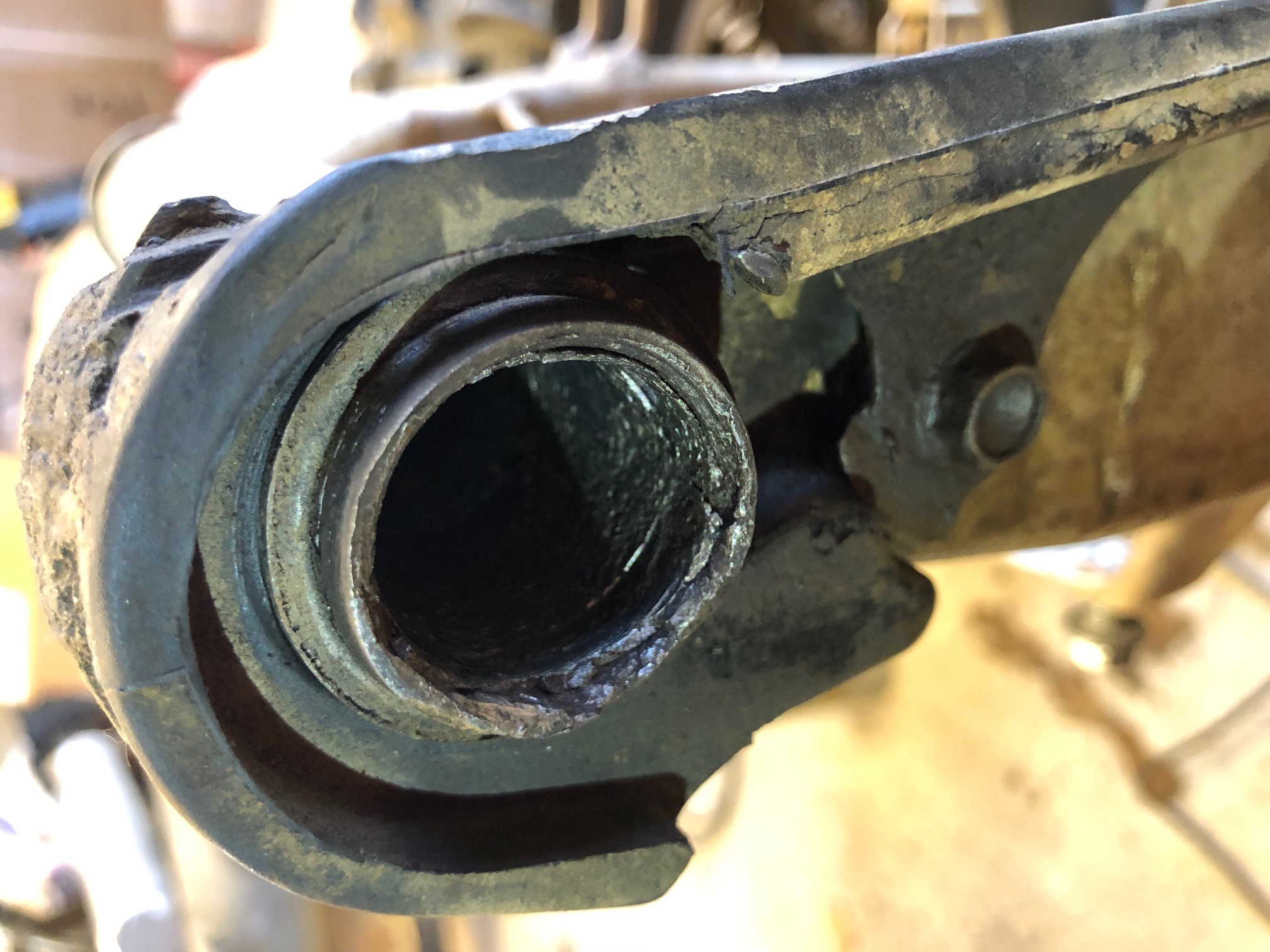

    I know this is an old thread but I've tried both previously mentioned methods. When I went to remove the bearings, there was nothing to remove but a thin wall of steel left from the bearing race. What you see in the pics is all that was in there. The one pic is from the side I was working on. Is the swingarm even salvageable? I tried the torch and PB method, I've cut one with a Sawzall and mini hacksaw. It looks like its all the way through but its starting to score the swingarm. (I cut it even more after I took the pic) I beat them with an impact socket (destroyed) and even rapped it a bunch of times with a cold chisel. It seems as if its welded to the swinger. Any other options? Thanks guys.Click image for larger version.

    Just replaced the same on my 350x swingarm. Tried everything. Used a cutting torch with a small tip and vary carefully cut what was left of the bearing out.
    Replaced with Delrin bushings. Won't have that problem again.
