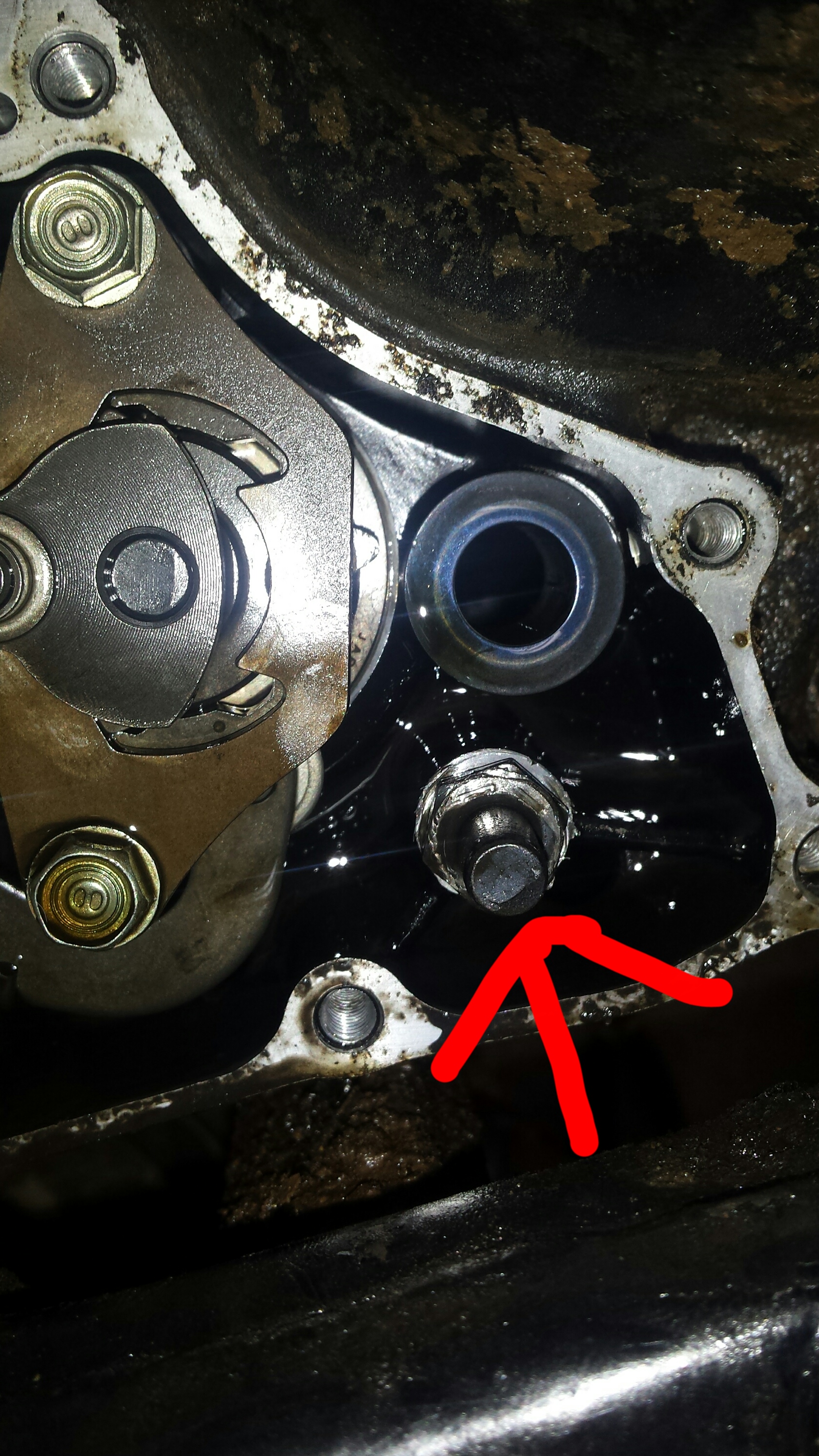

    My 250sx has been sitting for a year but now have come back to it. The shifter had been sticking and I have read the multiple threads on shifter issues. I opened the case, took the shaft out (straight) and as far as I can see the spring is fine, then I went to take the collars out and i hear something drop into the case. Pulled it out and took a pic (with the red arrow) I couldnt find anywhere what the name of this piece is called but i know its jacked. it is definitely broken off and has wear around the bolt head. I know this is definitely an issue but would it cause my shifter to stick down and/or failure to shift into gear? What would cause this to snap halfway down?

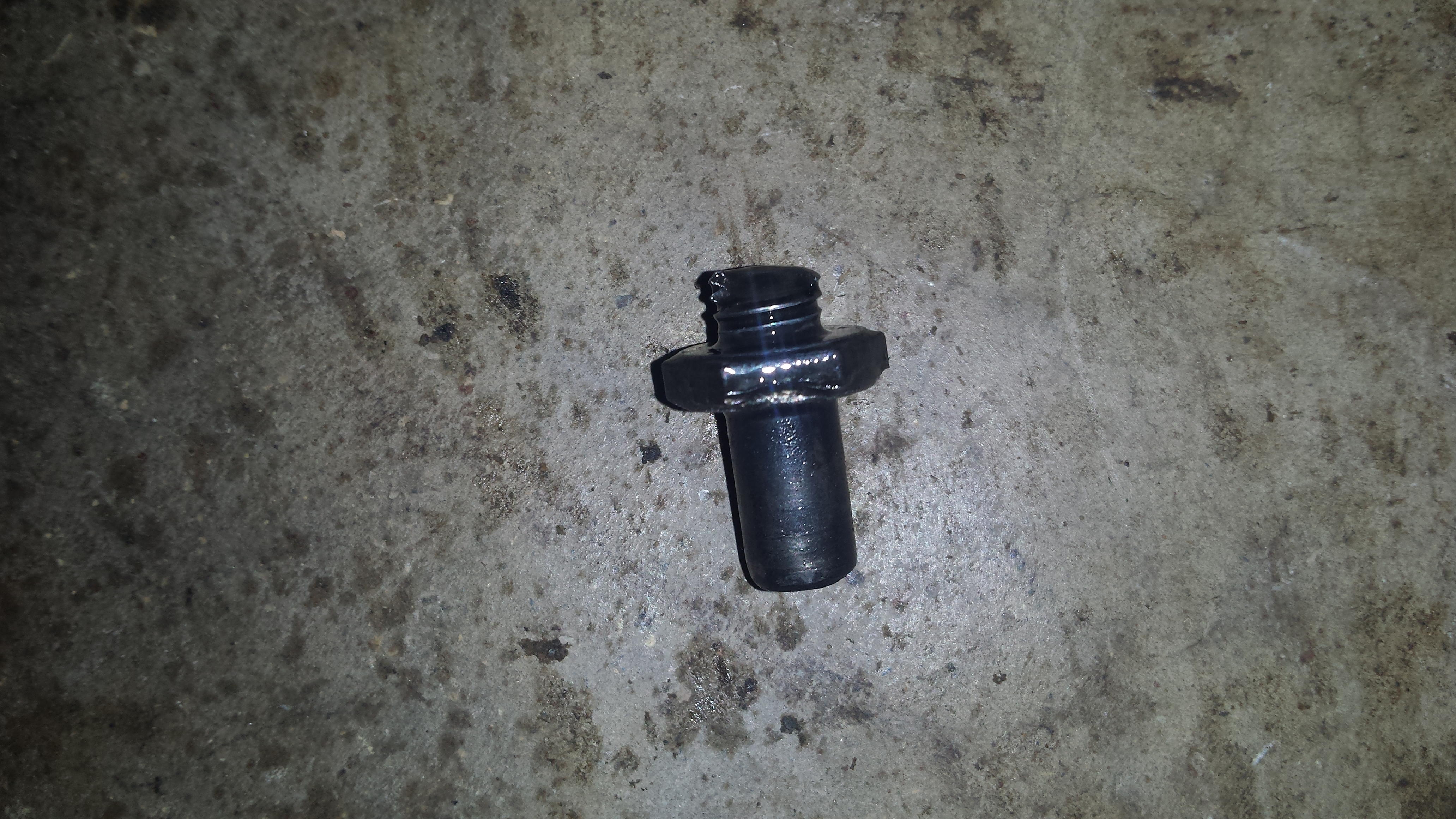

    Quote Originally Posted by dlmeyer0325 View Post
    Yep, that being broken would cause the issues your are experiencing. The cause of it being broken, 30+ years of hard shifting. Lol
    Here is a pic of the one I pulled out of my SX. I was lucky, and able to get the other half out of the case by using a punch around the the outer edge to back it out.
    When I replaced mine back in 13, it was still available front Honda. Here is the info you need....
    PIN, GEARSHIFT RETURN SPRING
    24652-HA0-000

    had the same thing happen with a fairly low mile sx, i think its common.

    Thanks UPNATM the part is ordered now I'll try to get the other half out.

    got the shifting problem taken care of. now the case leaks oil. seal kit ordered
