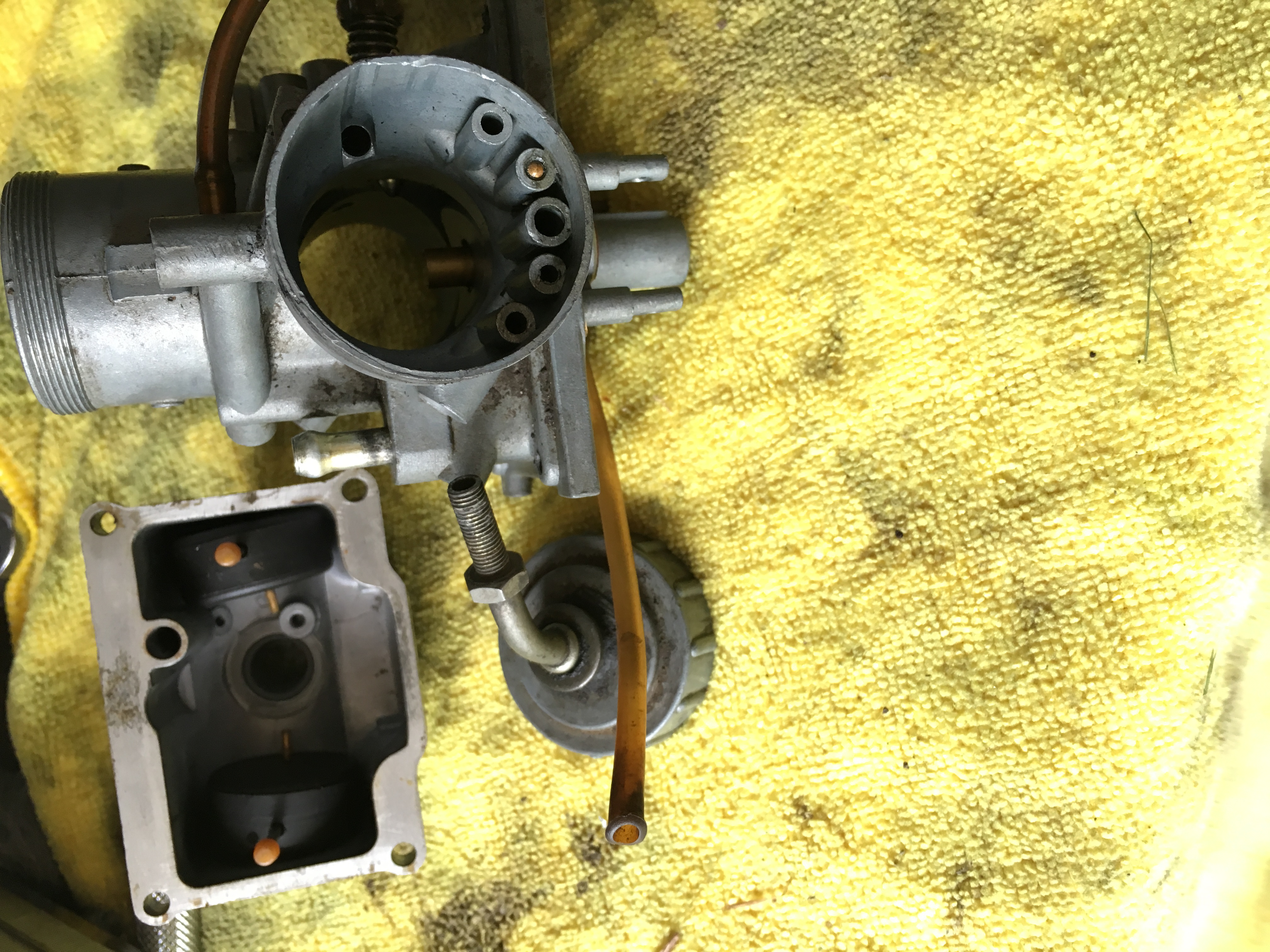

    I just picked up a 1986 Polaris scrambler 250r/es in not running condition. The carb that was on it is I believe a Mikuni vm but it has no indicators other than MHC on once side and JAPAN on the other.
    Can anyone tell me what this carb is? I need a rebuild kit and throttle cable for it.
    I'm also wondering what carburetor this machine came with the from factory, is it the same as a later year trail boss 250?

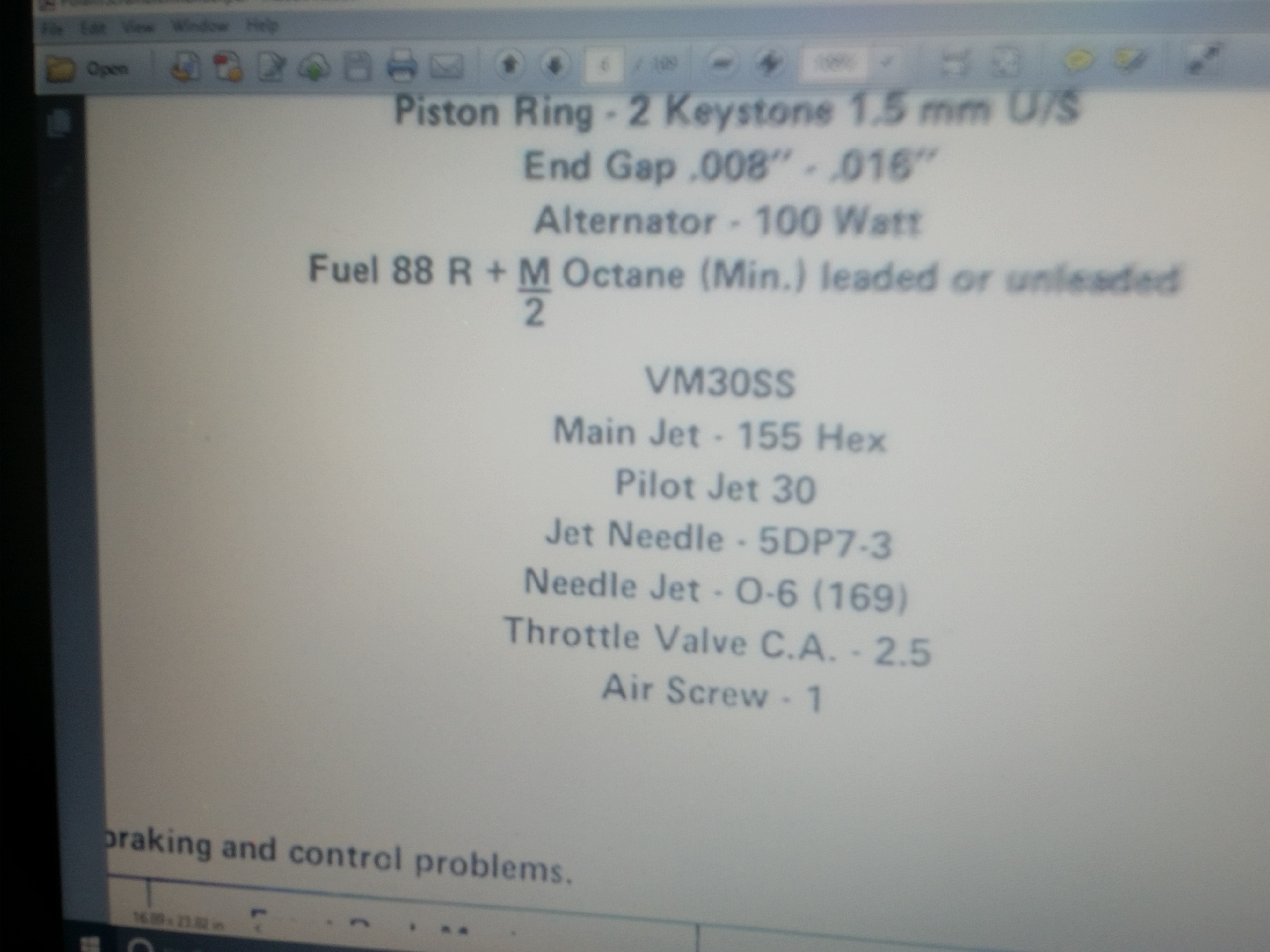

    That is the correct carb you have.
    Apr 2002
    s.w. michigan
    6,498
    info
    Here is a shot of some info,,, howdy is looking for clip setting,

    Apr 2002
    s.w. michigan
    6,498
    more info
    And more info
