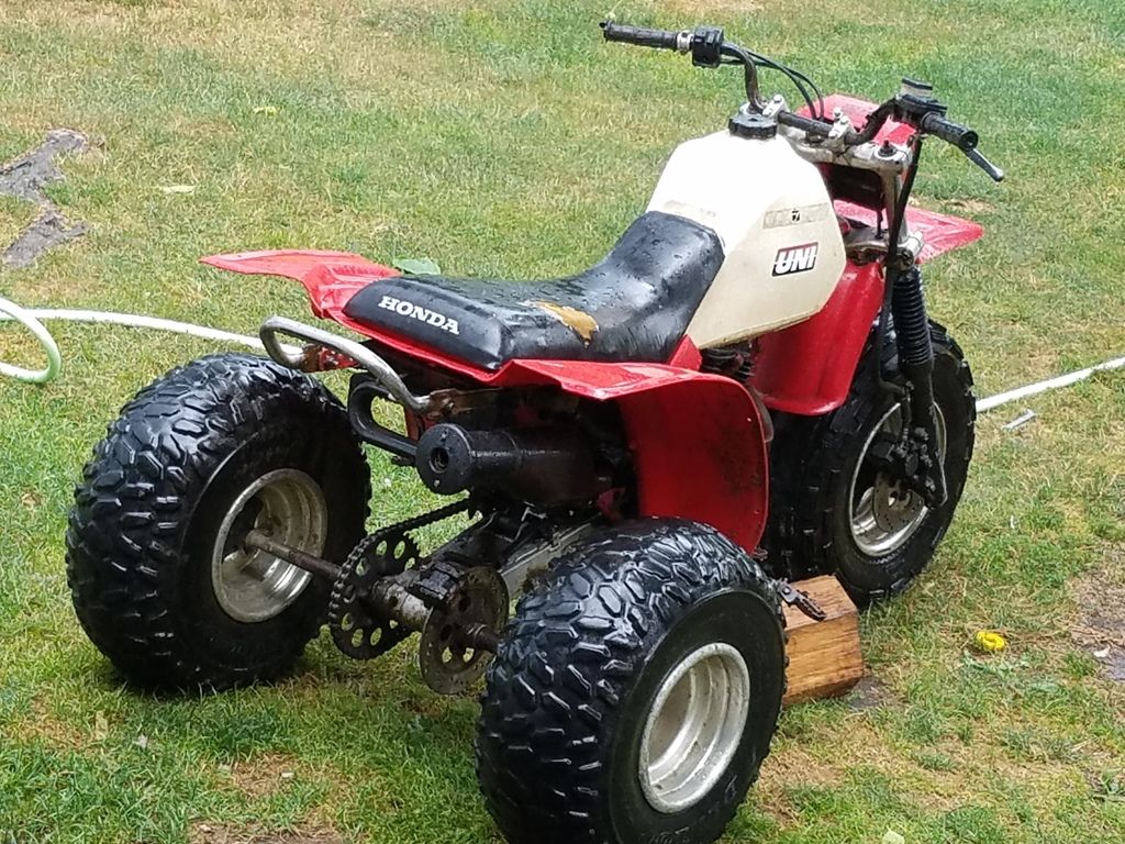

    [IMG][/IMG]
    [IMG][/IMG]
    [IMG][/IMG]
    It's a work in progress looked a lot worse when I bought it
    Oct 2013
    Wherever I May Roam
    3,757
    Honda clutch cover bolts right on to that engine and works fine? Or am I missing something? That would be new and important info as far as i'm concerned! The hardest part of a lifan swap is usually the brake pedal mount.
