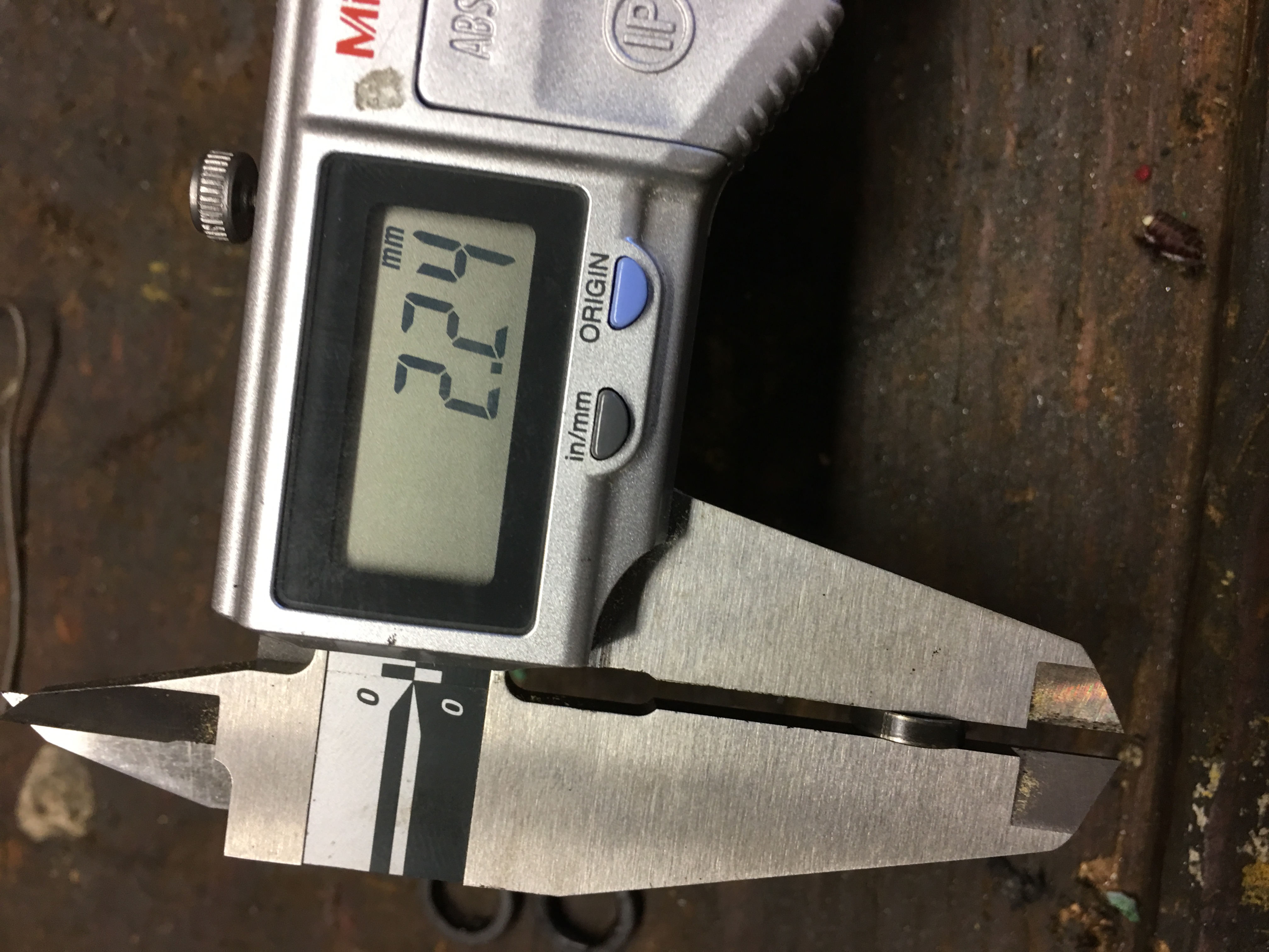

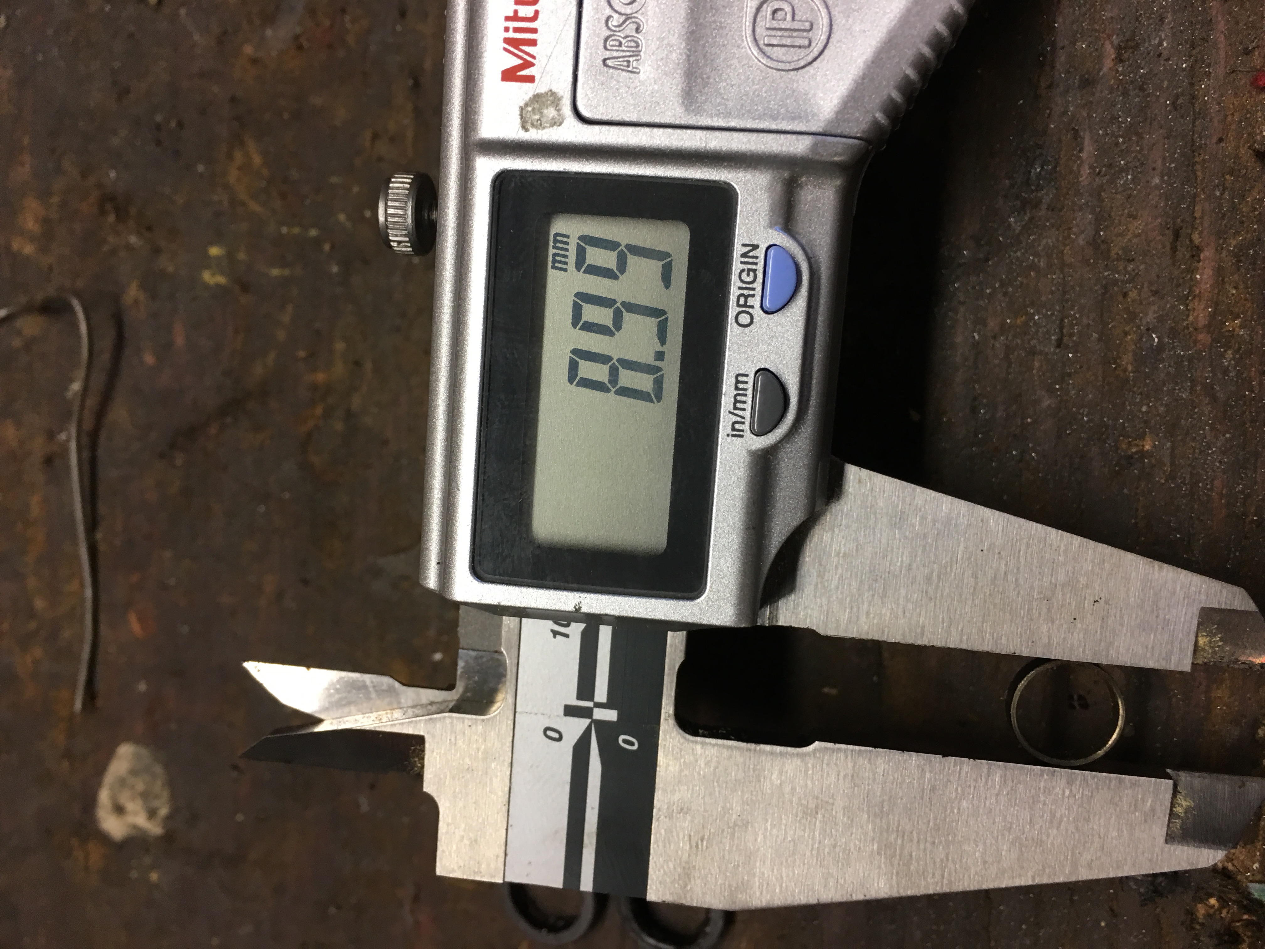

    Hey, I found those collars during my tear down. They are tiny little dowels. I can give you dimensions and photos if you want.
    From what i can tell, i believe they are for alignment more than anything else. It appears the oil channel to the head doesn't use them as a seal or anything.

    Hi! yes please i believe too that they are only for aligment... but who knows.

    Ok, ill post tonight if i can.
ID:	235421Click image for larger version.
ID:	235422Click image for larger version.
ID:	235423Click image for larger version.
    Oct 2013
    Wherever I May Roam
    3,757
    According to the last pic, your caliper needs a new battery.
