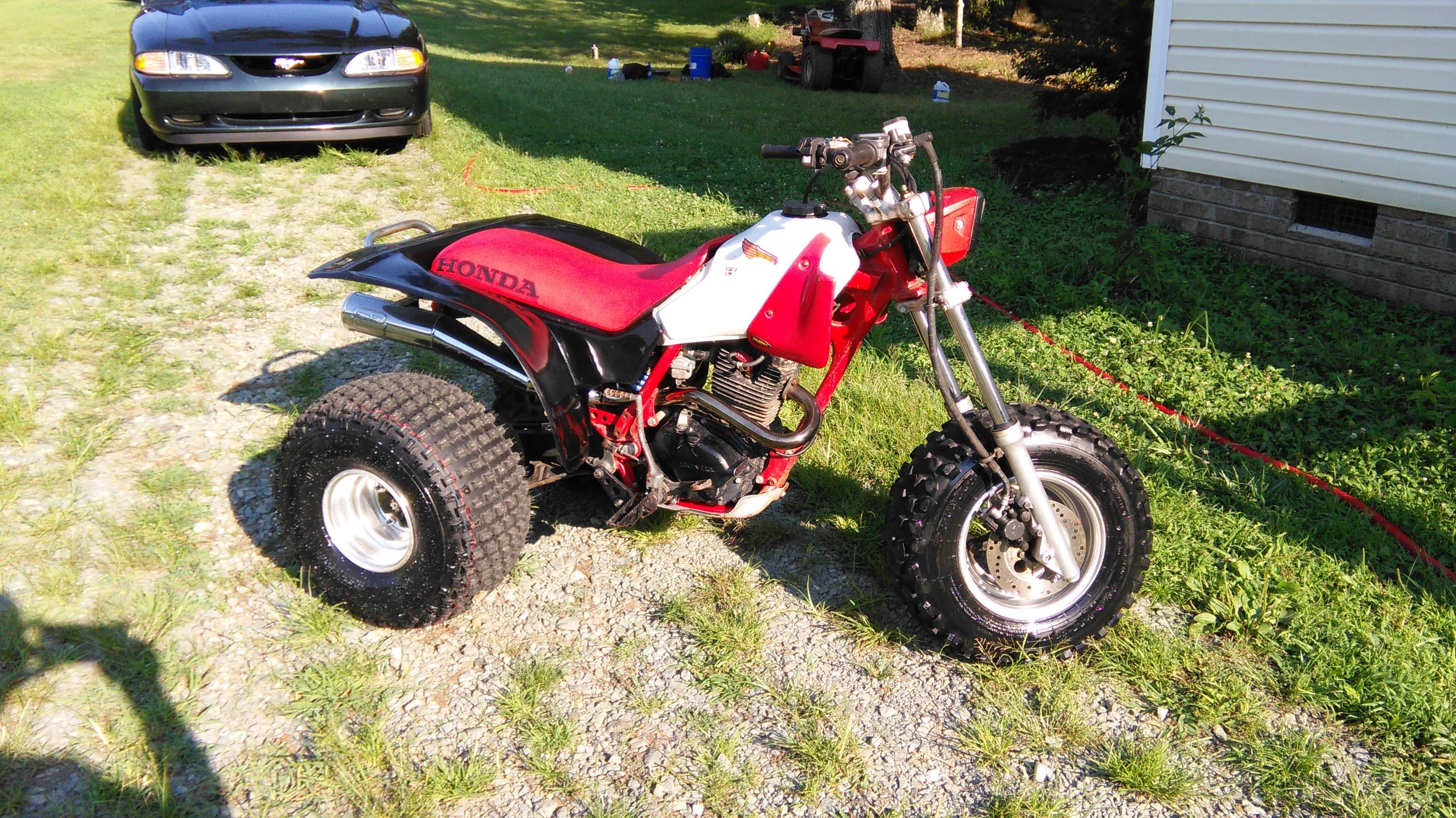

    Hey I have a 85 ATC 200x that I'm in the process of building I'm looking for performance parts especially camshaft. I've got a jug bored to 66.5mm with 10-1 compression piston. And the upgraded valve springs just wondering if anyone my have a nice bump stick they might wanna let go of. The plan for the bike is black frame, engine, tank, plastic except for super scoops. And a red seat cover. Trying to build one similar to what I had as a kid, it was hilarious having people trying to figure out what was done to it.... It had a very rough idle

    Welcome to 3wheeler world!! Sounds like an interesting build.

    That's right I forget they sell them that large because I'd not run the sleeve that thin, but I'm sure yours will be fine. Any more pics for us, we love pics.
