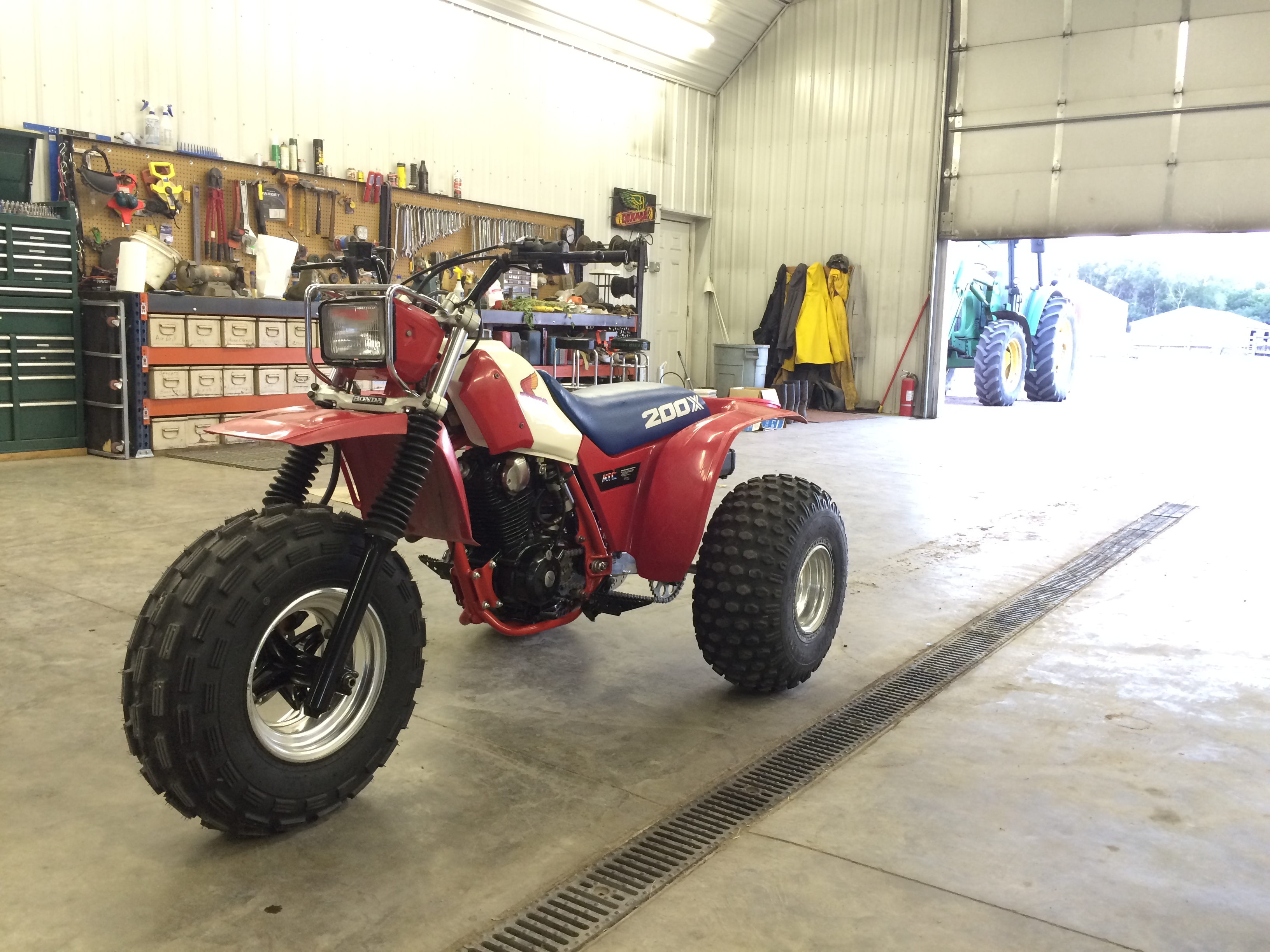

    Hey guys restoring an 84 Honda 200x and in the last leg of the build. I'm going through and doing some final checks and can't seem to get it to idle right anymore. It runs and starts awesome. First or second kick usually. Messing with the carb I noticed where the idle screw seats on the throttle valve (silver plunger in the carb) is severely worn in the spot where my idle needs to be set and I think that's my issue. I adjust idle screw out just a bit it dies. I adjust it in a little it revs higher than you want an idle. Anyone have a solution to that? I can't find a new or used one. Was maybe thinking jb weld?
    Sorry I didn't take pics of the indent but it's the size of half a round pin head or so
    Thanks in advance!!

    Thank you a lot of hours and parts searching in to this machine. Complete resto from frame up. My dad bought it new in 84 and he doesn't know what's been done yet so it should be pretty exciting!
    Also thanks for the tips I'll let you know what I do and how it goes!

    I can see that! You did a great job. Yes please let us know what dad thinks!! A video of the reveal would be really cool.

    Nice bike man. You should get some 85 gas tank decal. They look amazing with the color combination you have!

    I just said that because he had the rear fender and blue seat of an 85 instead of an 84 . And in my opinion they would look better. But who am i to judge the build of another....
