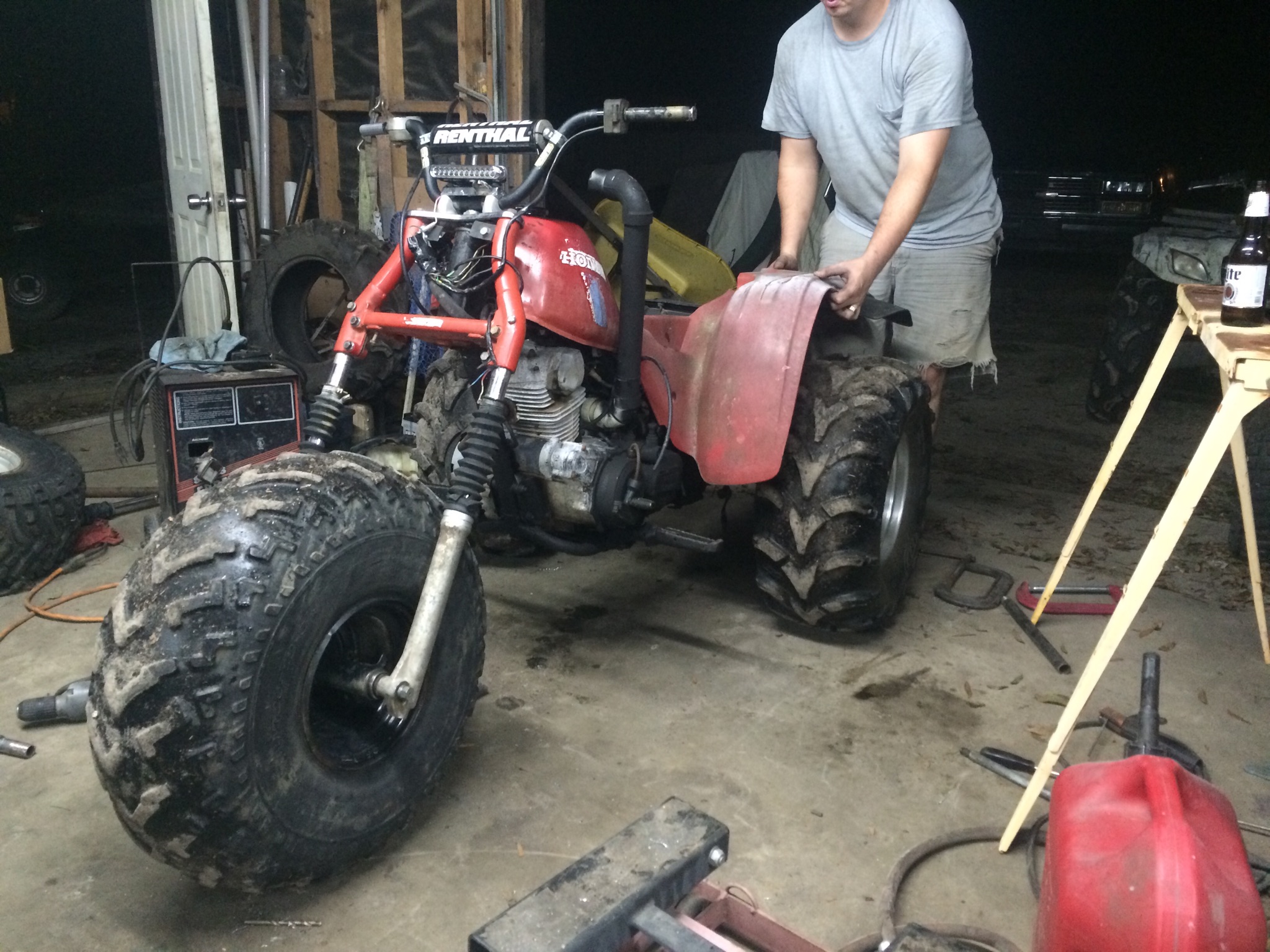

ID:	234607 this is it with 5 inches in the front 4 in the back on 28 inch mud lites. With 2 inch wheel spacers
