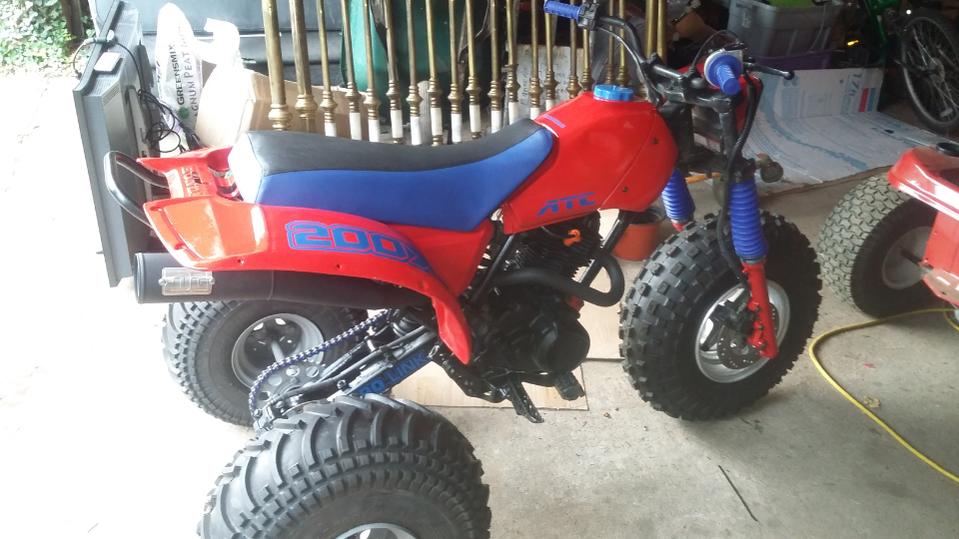

    Hey guys... I've been having trouble with my 3wheeler idling I had bought a Chinese carb after I bought the bike and realized today that I should have listened when I was told it was junk because I couldn't get the bike running well so I put the old carb right back on and it runs good I have to give it a little throttle when starting it.. I adjusted the air fuel screw ..it will run through the gears and has power but woulnt idle and some times when in neutral I give it gas and it just revs up really high ND even after I let off the throttle it continues to stay at a high rev but if I throw it in first it idles back down.. I don't know where to start with what jet to change.. I'll take any and all info to fix this problem

    I just looked up jet kits and I plan on ordering one just not sure what one to pick up cause I don't know what my carb came off of it was the one I bought with the bike and it's a 200s motor on a 200x frame with different parts from random bikes but it does look decent I put alot of money and time into it.. And I believe it will be just what I imagined It could be as soon as this thing idles because I love the way it rides!! Click image for larger version.

    I don't have the oem carb.. All I know is I have a keihin carb on it it's a 1985 200x frame with a 200s motor.. Auto x
