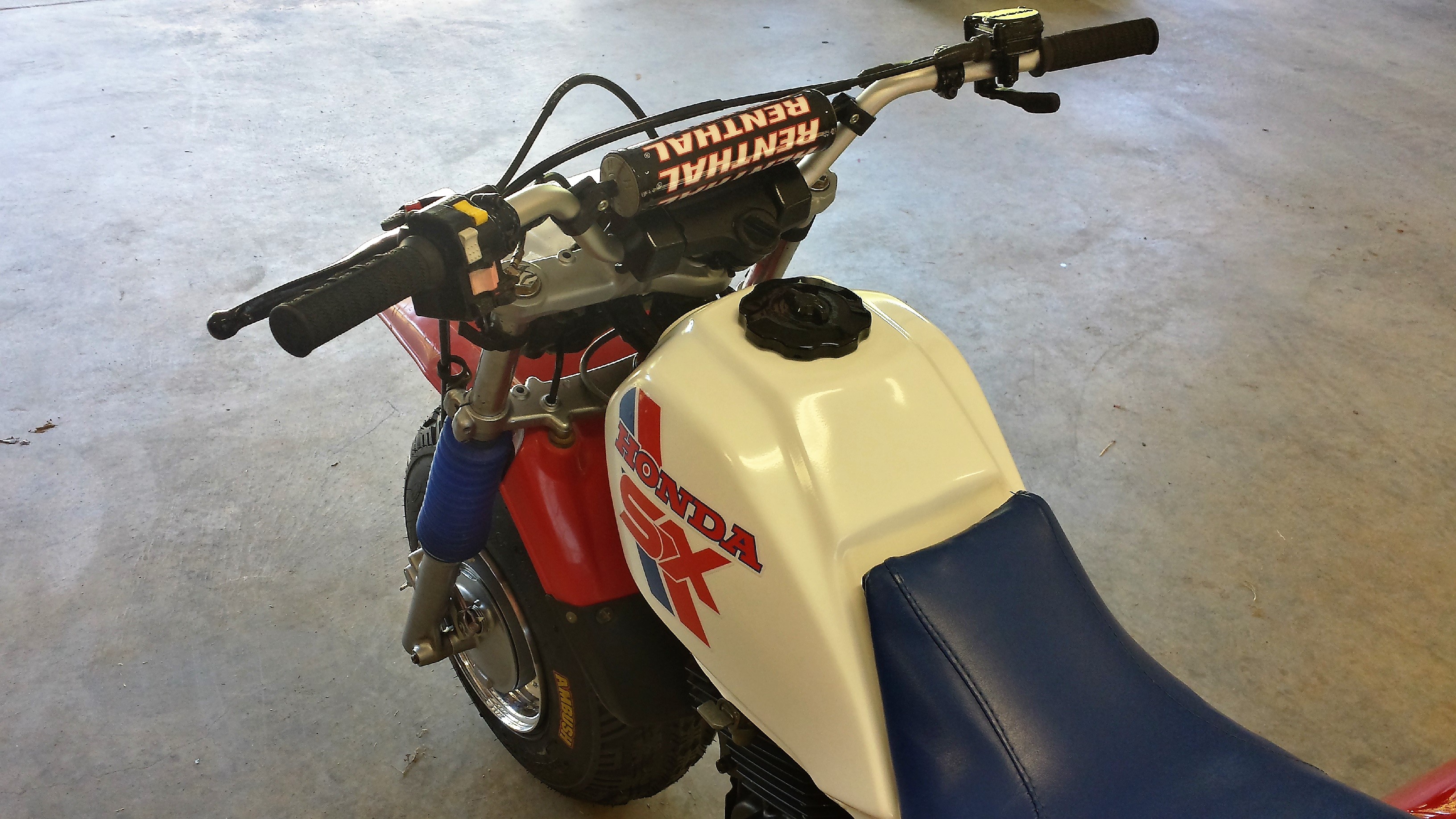

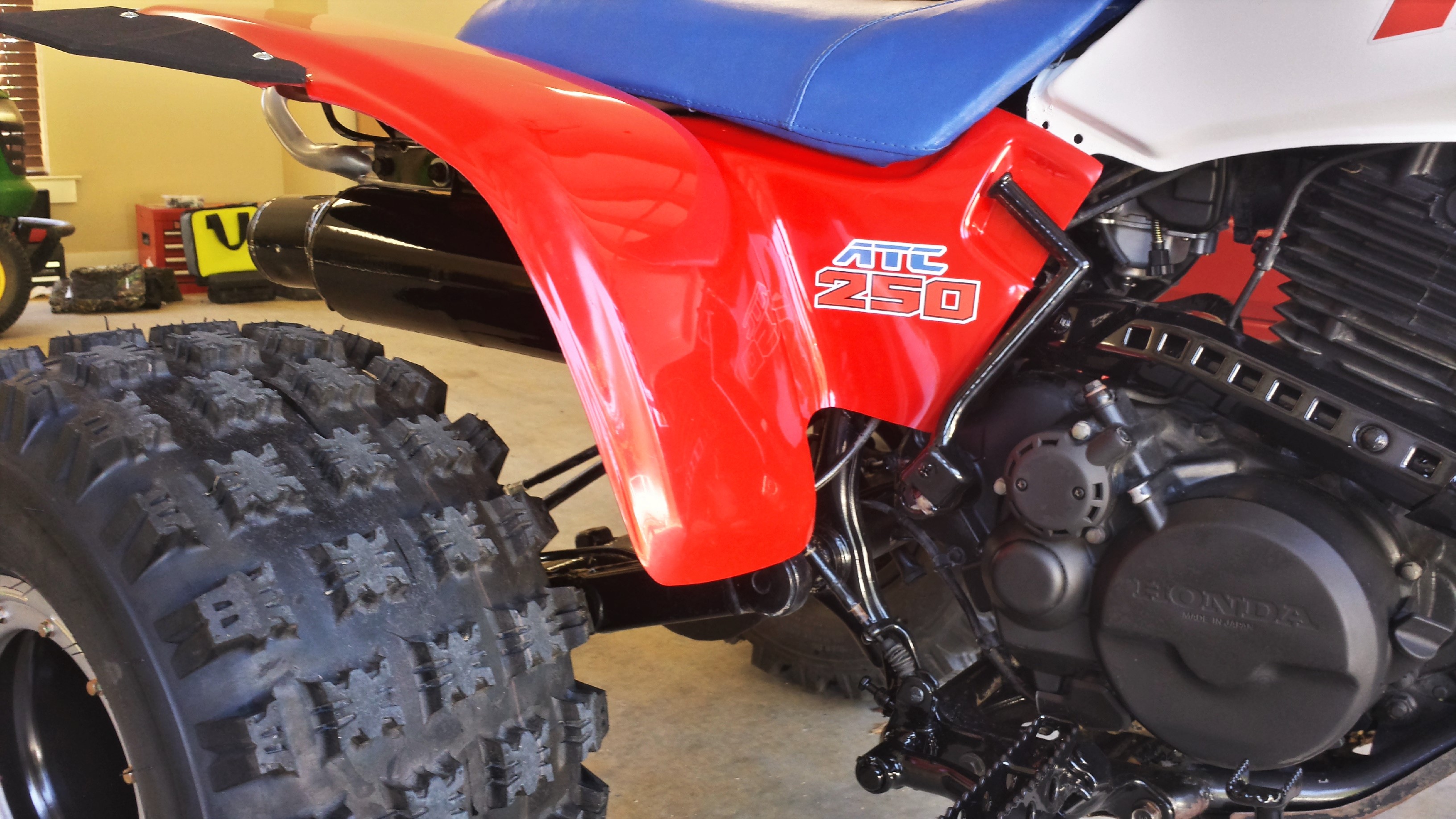

    Just about finished. Finally got my tank back. I'll comment more on that thing later.

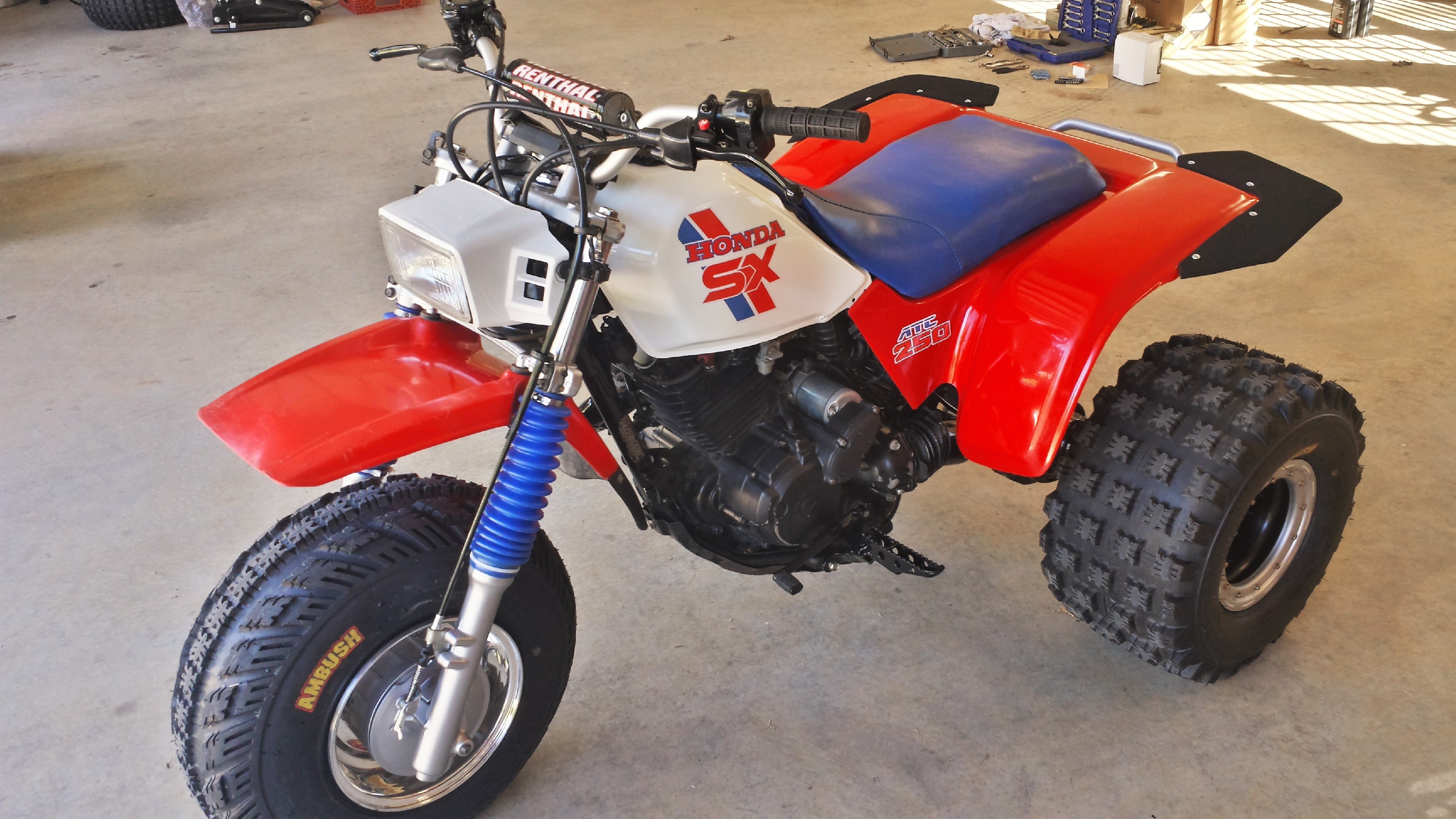

    The tank has kinda pissed me off. Having the inside coated by a radiator joint, I thought it would be smooth and nicely done. Nope! Looked like garbage and I had to drill the opening for the petcock, knock strands of crap out of the gas cap opening, try to clean out pieces from the inside.
    The vent selector on the cap turned out looking like crap with a lot of bubbles.

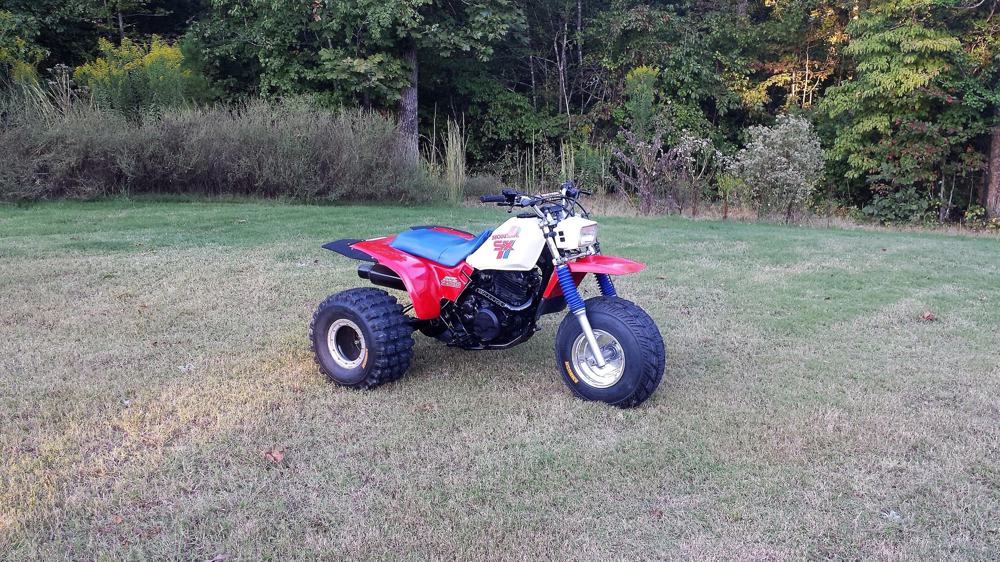

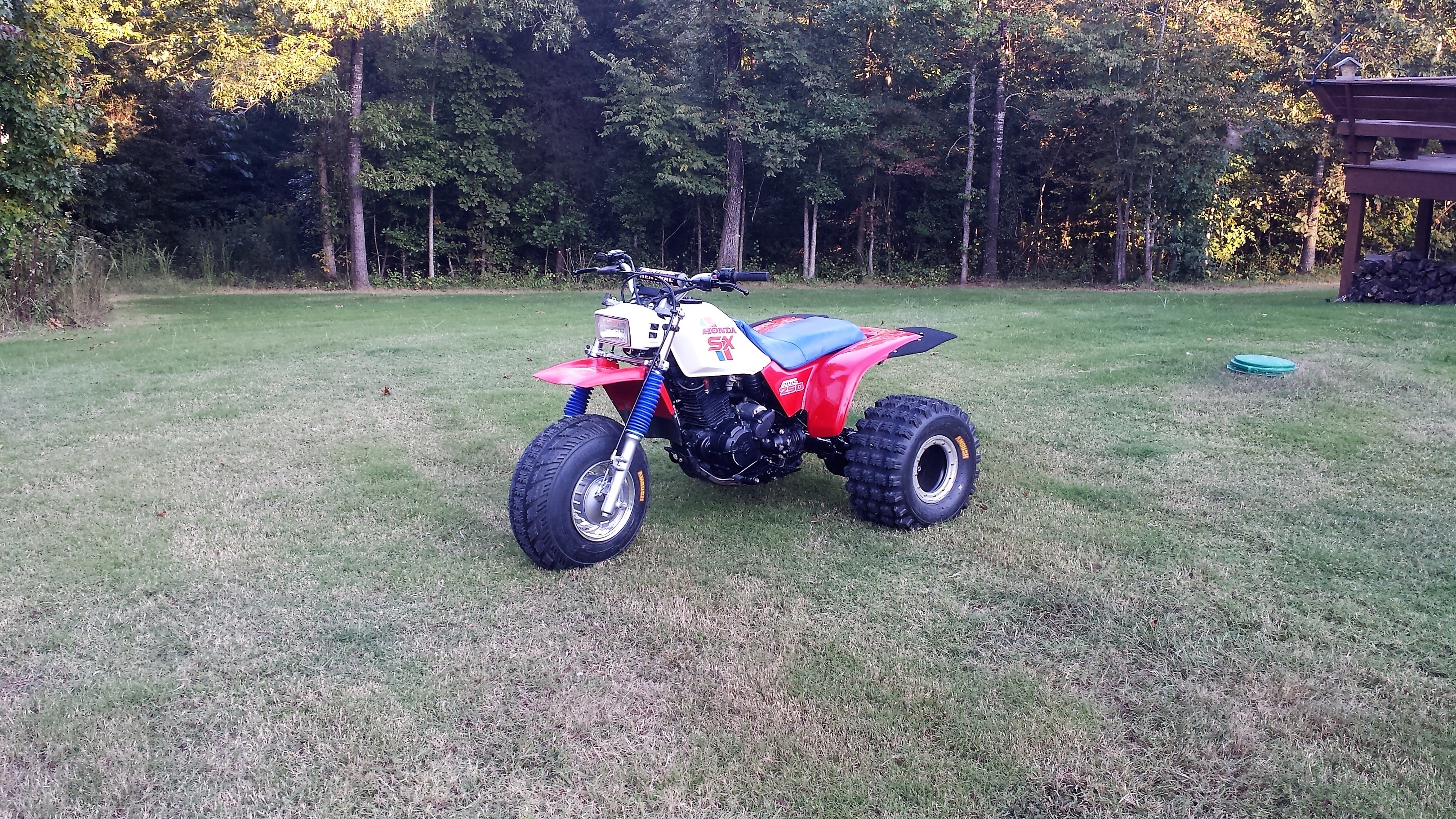

    The first "test flights" finally happened today! She runs well and has a few adjustments that need to be made. The carb that was rebuilt by FlyingW is spot on! Thanks, dude!!!! The .5 inch offset of the front wheel is absolutely not a factor in the handling, for sure. The 1.5 inch spacers on the rear wheels makes a HUGE difference. This thing tracks like a laser while on pavement. On the dusty trail, I have a grin from ear to ear while stepping the ass out around the corners.
    Overall, it's a great build that suits me perfectly.
