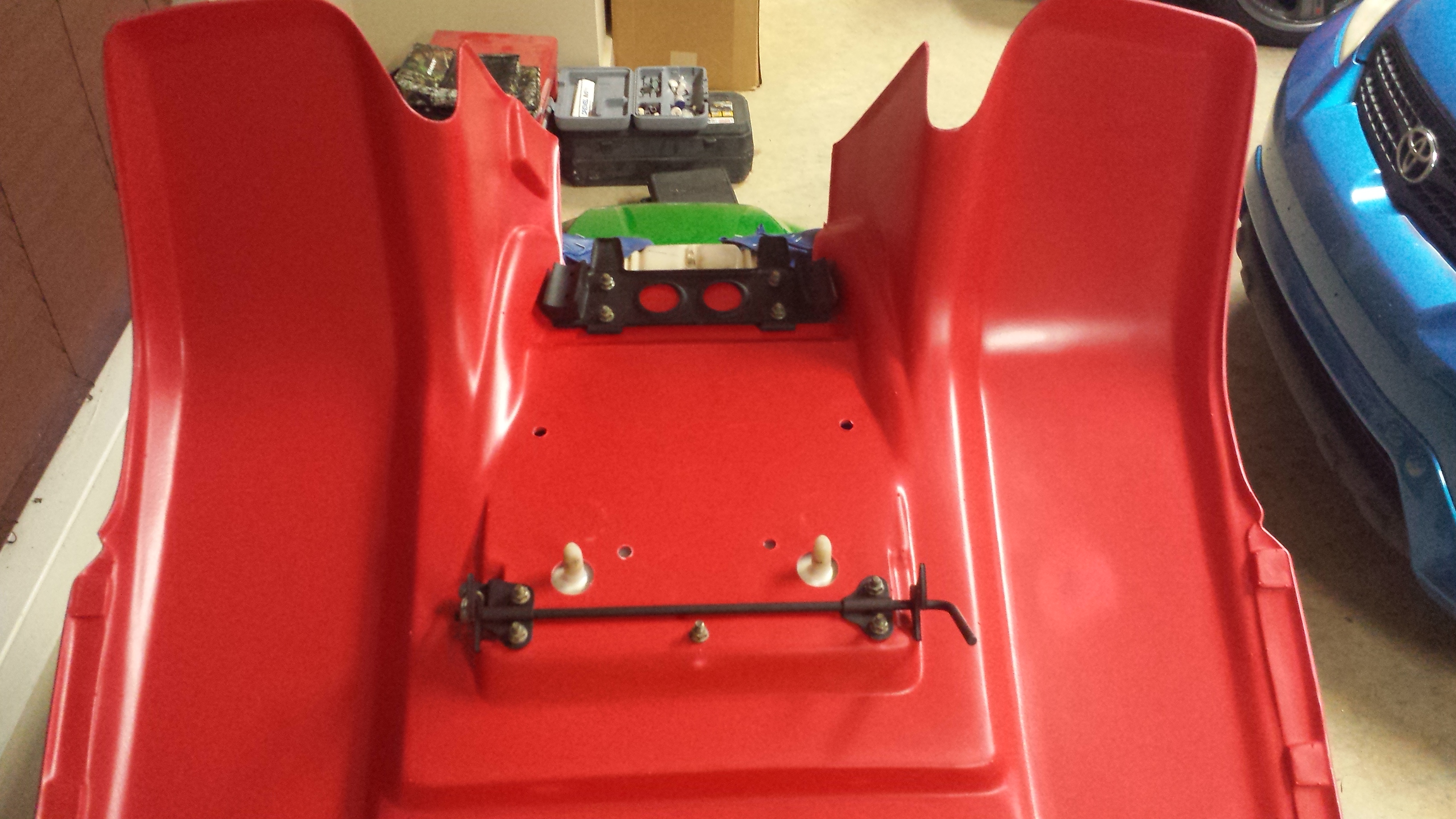

ID:	234663Click image for larger version.
ID:	234664Click image for larger version.
ID:	234665Click image for larger version.
ID:	234666Click image for larger version.
ID:	234667Click image for larger version.
    I went with the Maier fender and 'fabiodriven' sent some mudflaps he had made. I had a few parts powder coated along with the exhaust (I hope it doesn't peel). I was told to run it long enough to get hot then shut it down and let it cool before going out blasting it down the trail and the pipe should not peel. On the rear wheels, I went with 9x8 rims fitted with 20x11-9 Ambush tires. Also, 1.5 inch spacers. The front wheel is 10x8 fitted with a 22x7-10 Ambush tire. These pics just show things loosely mounted so I could get an idea of what it will look like. I'm waiting on the tank, forks, and other bits and pieces to come back from the powder coater. The carb is on the way as well.
