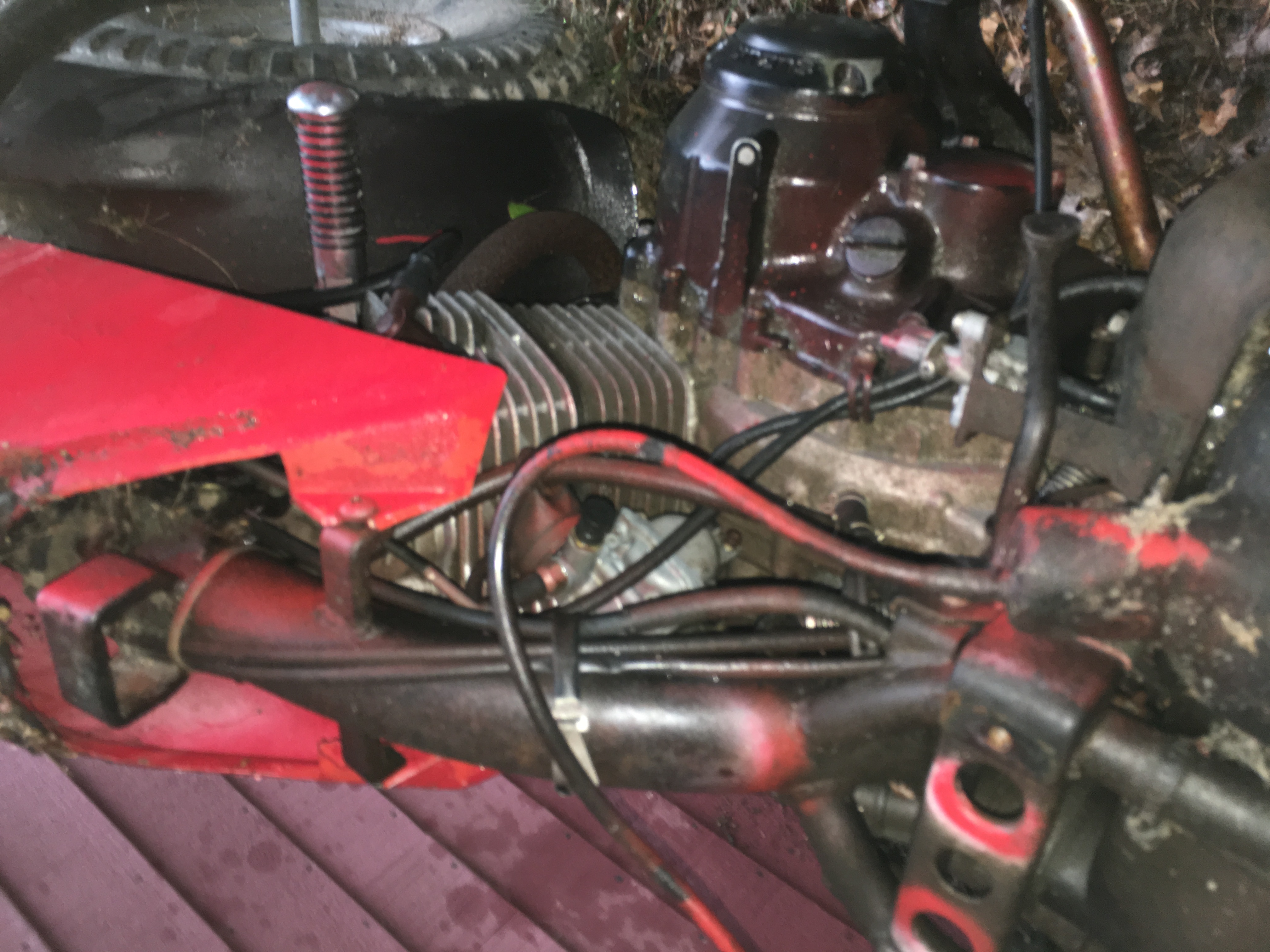

    Ok, I took some pics. Just remember ive had this bike Since new(yes red or orange over spray, block off plate on primer worked for me years ago, but not the right way to do things) YOUR on the right track... ran good when parked (i know everyone says that). Click image for larger version.

ID:	234702 Thanks for tip on carb kit, in a couple years i'll challenge my boys to get it running. Hope this helps (yes nipple above primer that faces towards back of bike is vent) theres a line on mine thats 10 inches long, the end is just tucked in under airbox hose

    Thanks for the pics, they were quite helpful. I ordered the parts I need for the choke.. I also ordered a new fuel pump being as though I think mine is shot. I've yet to put it all back together though because I'm waiting on a new chain. I currently have the fuel tank and air box removed so I can get at the bolt on the opposite side of the front sprocket. As soon as the chain comes in tomorrow, I will put that on and reassemble the airbox and fuel tank.
