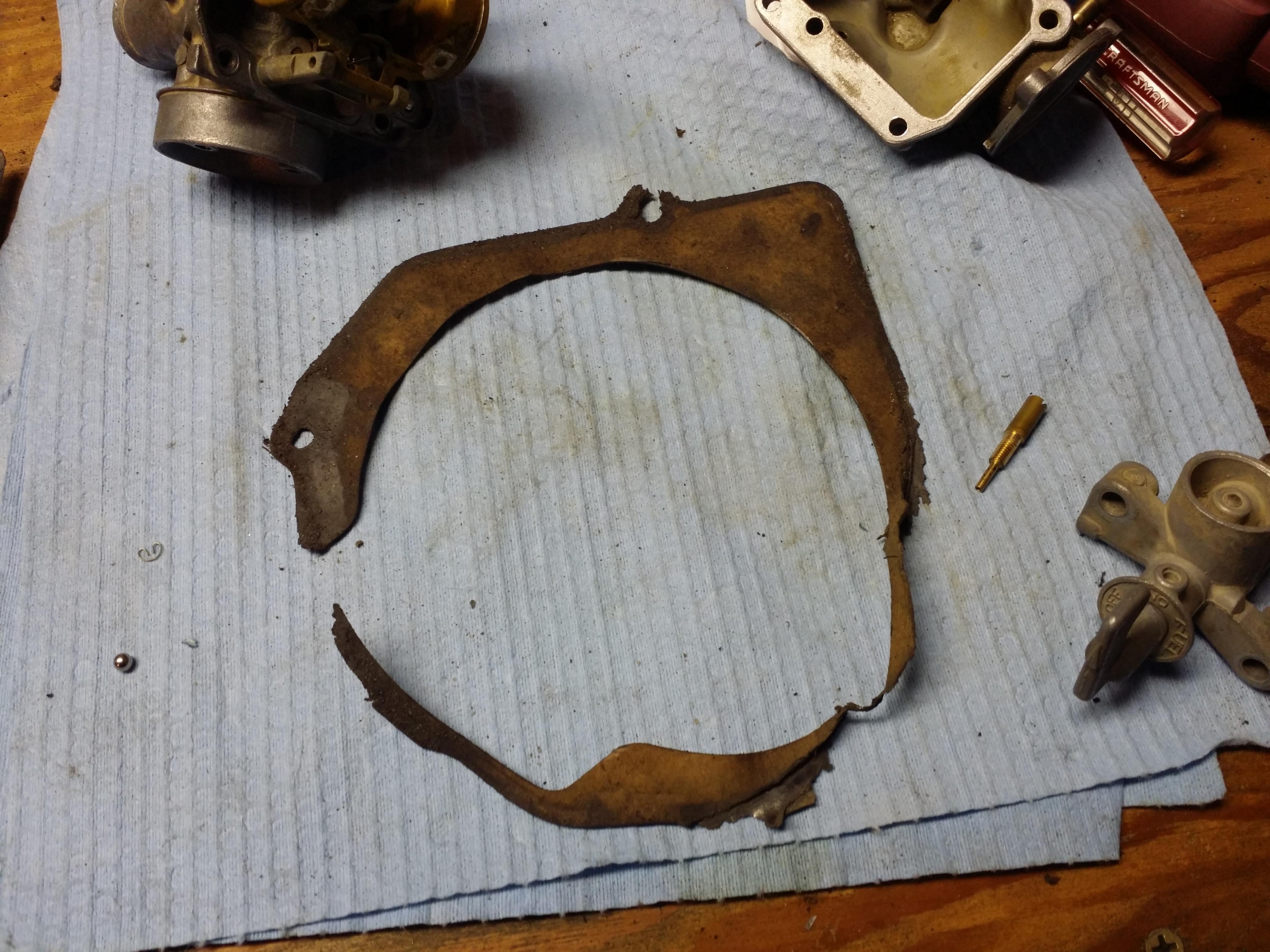

    Funny, I did most of what you're suggesting.. last night. I tried taking the starter cover off.. for 2 reasons. 1, to inspect the condition underneath it. And 2, So I could use a drill to start it to save on my back and lungs. In the process, I ran into 2 more issues. 1, one of the bolts head broke off, and the body is still stuck inside. And 2, the gasket was disintegrated and in a pieces (i took a pic). What is the gasket for on the start assembly? Is it required to keep the vacuum lock?

Name:	starter gasket.jpg
    Aug 2016
    East of Worcester ma
    1,353
    Just out of curiosity is there a compression release on head? Like the alt185Click image for larger version.
ID:	234981 did it work?, when its closed it looks like this pic. Im 99% sure gasket is just to help keep water out (pull start).
    Nah I don't seem to have that on my head.

    In behind the stator is a oil seal. That is as far out as the oil gets. No vacuum or anything like a 2 cycle. A little heat and vice grips for the bolt,a small cole chisel works wonders if you can get at it. If you pull the plug out and both valve caps off. Pull the engine over slowly,you will see as the exhaust valve closes, the intake opens. This is called valve overlap. The next time the piston comes up to tdc that is the compression stroke. Both valves should be closed and therefore the rocker arms loose. This is where you safely adjust your valves. Simply set till a .003 feeler gauge is snug or a .004 will barely fit in. That is it. Unless you hear the timing chain slapping when it is running, your timing should be good. But a tooth off would give you these symptoms.I Strongly think you have weak spark,very common on these,behind a dirty carb.
